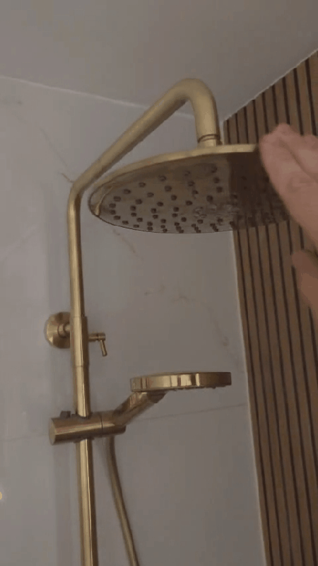

I recently had a rain shower unit installed and noticed there was some play on the arm.
Is this expected or should this arm be fixed?
See attached video.

There might be some play, but probably not as much as you have, that said how hard are you moving it?
Can't see from the vid if it's the brass bracket that's fixed to the wall that's also moving along with the wet wall or if it's just the brass riser, that's fitted into that bracket on the wall (with the lever that fixes the adjustable height riser) hasn't had the allan key grub screw tightened properly.
Either or .... no - the vertical riser (edit) shouldn't move/twist to that degree.
@CountryFan I am just tapping it lightly and there seems to be a lot of play.
@Madrab The brass fixing doesn't move along the wet wall. It's fixed. However, this is moving also.
That's both for your feedback. I am not familiar with rain shower units and it didn't seem right to me, so I wanted some validation. Thank you.
So the PVC wet wall behind the brass fixing bracket, that the bracket is actually fixed to, is flexing as well?
OK, if it's the wet wall that's flexing then it may not have been fixed to the subsurface properly at that point. If the shower was done as part of the same job as the wet wall, then they should have made sure between them, that wherever the fixing points of the shower was going to be that they made sure there was plenty of adhesive for the wet wall at those points and/or if it's plasterboard behind it that there would be a firm fixing for it all at those points, so the bracket could be screwed through nice and tight.
The question for you now is - does the wet wall come off and get fitted properly or what other option can they suggest because that amount of movement could ultimately cause problems over time if the shower riser/handset is used/moved frequently and it flexes to that degree.
