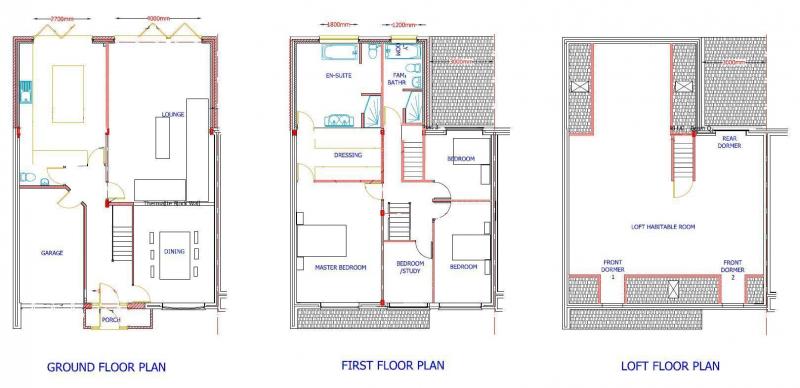

By the way here is a copy of my floor plans for your info to give you an idea of my rooms and proprtions - Scale is 1:100. Thank you so far. It's appreciated.
[/img]
For the most even coverage, the spacing between lights should be twice as much as the space between the light and the wall.
e.g if the room was 2m wide, and you wanted 3 lights in a row between the walls, they would be spaced 50cm apart and 25cm from the walls.
The spacing you actually want will depend on the angle most of the light is emitted from the lamp and whatever you consider to be 'working height' in that room, such as the worktop in a kitchen, desks, tables, or whatever else for other rooms.
Once you have decided on the working height, to get reasonably even coverage from the lights at that height you can calculate the spacing distance using a right angled triangle:
The vertical side is the distance from the ceiling to the worksurface, the horizontal is 50% of the spacing distance between lights (which is what you will calculate). The top angle is 50% of the lamp angle (e.g. 18 degrees), the other is 90 degrees, so from that you can calculate the third angle and therefore the length of the other 2 sides.
To reduce the appearance of darker areas on the floor/surfaces where the light from 2 lamps will meet/overlap, you may want to allow for some overlap of the areas covered by the lamp, as they will be roughly circular, alternatively each row of lights can be offset by 50% compared to the previous row.
If this isn't done, then you will either end up with dark patches where the areas of light don't meet, or over bright areas which are lit from 2 or more lamps. Some of these 'bad' areas are inevitable anyway, as rooms are not usually square or even rectangular.
After all that, you can then calculate the light level at the worksurface for various different wattages of lamp to find the appropriate wattage to provide you with the required light level.
Kitchen an L shaped run along the counter area 800mm off wall, maybe 8-10 lights (subject to under counter and hood lighting arrangements),
Island 4-6 with a bais toward the RHS wall- the counter lights will project on the LHS of the isle.
WC 2 lights, 1 towards the basin, 1 over wc.
Dinning room 8 as :::: with the inner :: and the outer : : being seperate.
Lounge 3 x 4, banks as :: :: ::
Hall 2 main centre, 3 in corridor, 2 infront of porch. Porch 2.
Family bathroom 2 over bath, 2 in wc cube, 2 over sinks, 2 mid room.
Dress room 3 in centre, 1 at each door / access area
Bedrooms- furniture dectates- wheres the beds, beauty table, TV's etc
All beds to have door adj switches and bedside control.
Mid Hall 5, 1 each at stairs base (loft) and stars top (from grd) 3 split across walk area.
Loft and many as you wish, but they will cause issues with celotex insulation, the vapour mebriane and also size issues depending on joist size.

Ive updated the house plan drawing again to give you an idea of furniture layout for the living room, dining room and all 3 bedrooms. Ive also updated the family bathroom layout as I have changed the layout of the bathroom in this room.
I would appreciate your updated suggestions for these rooms also. For the loft I take your point but Ive been told by Building Regs to keep a square foot clear gap between any downlight in the loft and any celotex. I have 9" joists in my loft flat roof ceiling.
The height of all rooms is approx 8 feet/235cm.
