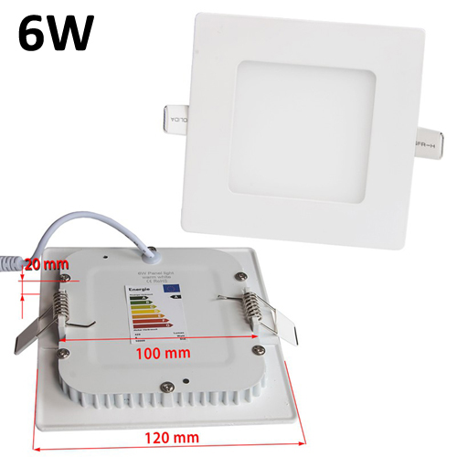

We have some unsightly chrome square downlight (6) in our bedroom. The cutout is approx 95mm square per light.
Rather than patch the ceiling + plaster + redecorate I thought I'd have a look for some more discreet fittings.
Found these on eBay that look ideal.
Does anyone know of a recommended manufacturer that makes something similar?
Cheers

I've bought one or two just to test and the lights themselves are fine, but the transformers which come with them tend to not be brilliant. Some are very RF noisy (interfere with your radio) and some just not designed very well. Some folks are sourcing the lights via eBay then chucking the transformers away and buying better quality ones - which still works out cheap.
Aurora make some brilliant square recessed LEDs and their drivers are top notch too.
They're not the cheapest, but you get what you pay for
Auroras stuff is good - expensive, but at least you know it's done to UK standards. I've used LED Hut too and their stuff is generally well sourced also and a little cheaper I think.
That is because they are not transformers, but switch mode power supplies and pretty poor ones at that.
Knowingly generating radio interference is illegal.

I know, but saying "switch mode power supply" would get blank looks from the average layman :D. As for the RFI, as well as breaching the regs it makes them useless really, as even though likely confined to your own house, it would be a complete pain. One guy could not pick up anything at all on DAB for example when he had one energised! I also would have grave doubts about putting them in roof space. Some have very poor separation on the boards too. All in all, best swapped out.
