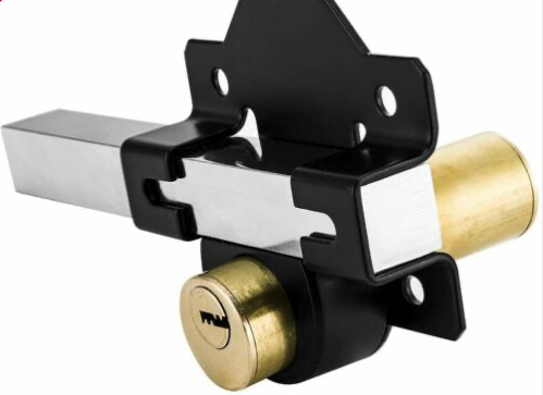

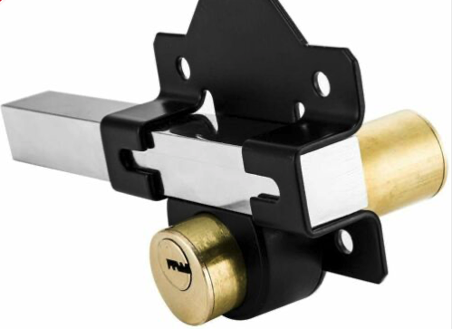

Gate Garage Throw Door Lock Rim Key Long Bolt
https://www.ebay.co.uk/sch/i.html?_...t=0&_odkw=Garage+Throw+Door+Lock+Rim+Key+Bolt
Thank you, that is interesting. I looked at these before for my garden side gate, but wanted something more susbstantial so bought a Yale British Standard night latch. However I can see the advantage of this in that it will provide more allowance through the seasons as the doors swell, shrink and shift around. When it comes to my garage door though I've different requirements. I want to get in and out of the garage often and simply, just by turning a handle. I won't be locking it with a key very much apart from occassions when I go away for a few days, or sometimes overnight. Therefore I need the sort of functions provided by a sash ock, but one that can be surface mounted. I guess I could combine Gatemate Long Throw Security Lock with an additional outside handle and latch, and only lock the Gatemate when I need.

Yes, agreed as that lock I showed needs a full 360deg turn of the key to lock it. Not a quick opener or closer.
But the one I have has been outside in rain on my gates for 5 years and still working perfectly and seems very strong.
