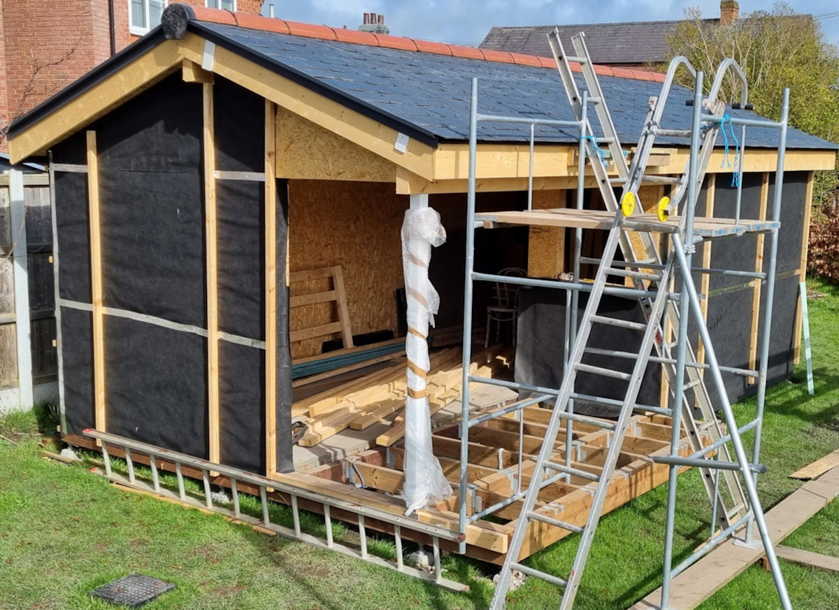

Hi all,
I'm finally (almost) ready for adding a roof to my green oak 5x4 m shed/workshop build. Its a gable roof over raised tie trusses but has a lowish pitch of 19 degrees.
I was thinking about slate at one point but Im just under the recommended limit but expect i could 'get away with it'. But worried about how long it will take as i really want to be done by end of this summer.
So Im looking for advice on roofing material/tiles that you know give a premium look and feel. I like the metal seemed style roofing but am open to suggestions and idealling suppliers?

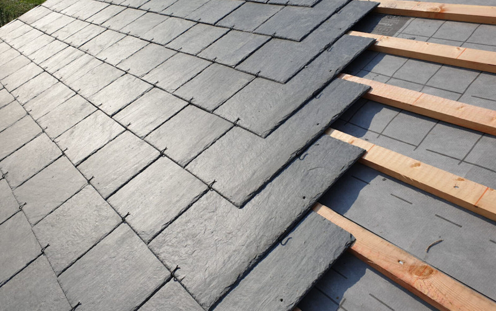

I'd go with slate. Mine is 20 degrees. Our house (1902) has an original single storey extension with a slate roof at 17 degrees - no problem. If you membrane the roof and then slate, even if you do get a bit of blow-by it would still only run down the membrane.
I highly recommend using slate hooks for a DIY slater - one fixing for each slate, and the hooks hold the toe of the slate down - much easier than trying to nail every slate and avoid kickers. I found using +4mm over slate width for the setting out widthways and 98mm headlap for a 100mm hook worked well.
Mine is 6.5 x 3.6 and I slated it in 2 weekends with a helper to pass the slates up. The slates pic is actually my garage at 36 degrees - same slate
