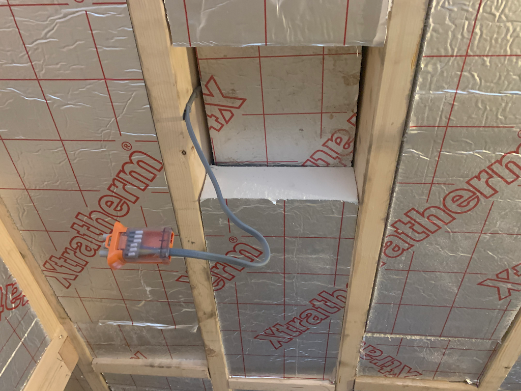

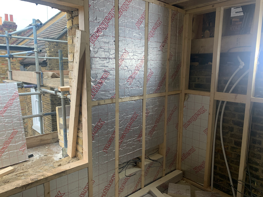

The builders installed my L shaped loft conversion, but not to architect diagram spec, and plasterboard was put up very quickly. So I now have the following issues. What you see in the photos is what was plasterboarded.
1) Did not tape or seal any joins. Including the light recess cut out corners you see in the image as well as the wall sockets.
2) While there is 100mm of between timber PIR. Architect diagrams had 75mm between timber and 25mm over timber, to avoid cold bridging and make it easy to make it air tight.
I informed building control, they don't see to care too much, I think the rectification is disproportional to the cost. Although they are recommending we retrofit the recess gaps, using a spray gun through the recess light holes.
I have two questions:
1) I'm trying to find the best product for those recess corners. I think I want a closed-cell, high density and low expanding foam with strong adhesive qualities. There are so many cans, most seem medium density. Any recommendations?
2) If building control don't care, I'm assuming I don't really have any recourse and just need to accept a lower quality build? Am I worrying about this too much?
Crap job. And it's not minor issues either.
Not taping the joints increases the risk of damp and timber rot significantly - guarantees it even.
Not insulating across the joists guarantees pattern staining on the decorated surface - dark black lines where the timbers are.
You would be a fool to accept this
Firstly get a foam gun, don’t try to use a can with its built-in nozzle.
I don’t think the choice of foam will matter much. I don’t think you want “sticky” foam. The main thing is to put in a small amount and see how much it expands, then add more as necessary, so you don’t over-fill. You’ll work out the right amount eventually. Of course if you do over-fill you can carve it out later. Try not to get it on the cables.

I think the 25mm over is the most important bit and it would be easiest and cheapest to do it before the boards are skimmed.

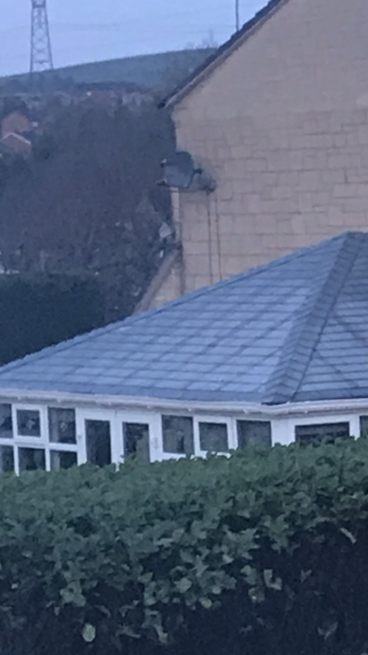

I think mr neighbour had it only between on his roof and you can see where the heat gets out:
