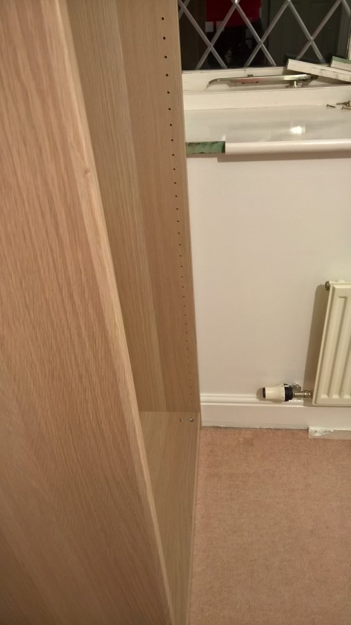

Hi guys,
After receiving good advice I just wanted to come back and let you know the outcome.
I eventually decided to just cut the part of the sill back where the wardrobe overlapped. I bought a multi-tool and nervously went for it.
The measurements and cut are just right and it has given me just enough space. Once the sliding door is added to the front of the wardrobe (which add 80mm), the majority of the 85mm currently visible cut face will be hidden and once painted white should not look untidy.
Couple of photos from after the cut.
Thanks for all the ideas and advice

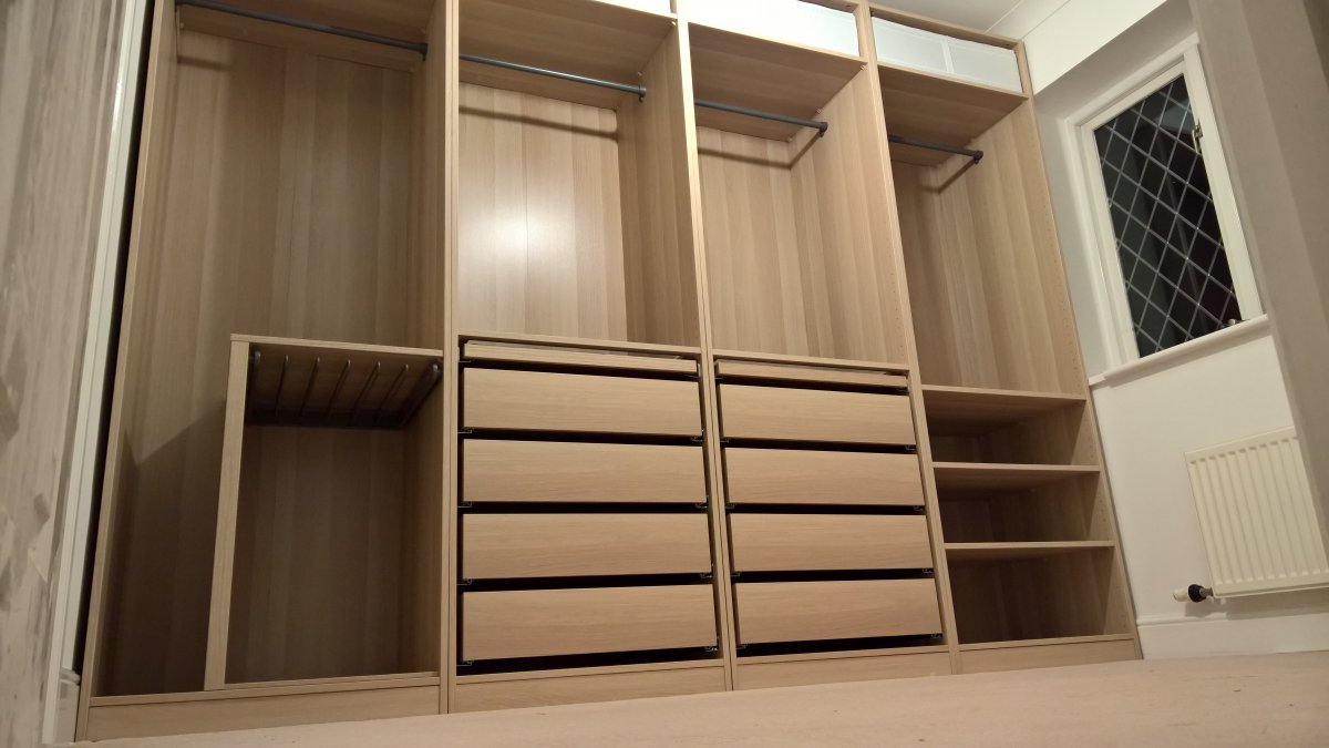

One last pic.. the sliding doors are still to go on but this illustrate the tightness of wall to wall fit and why the sill needed to be cut to make it all work.
I know it's only Ikea stuff but I'm happy.
Cheers all again for your help ☺
