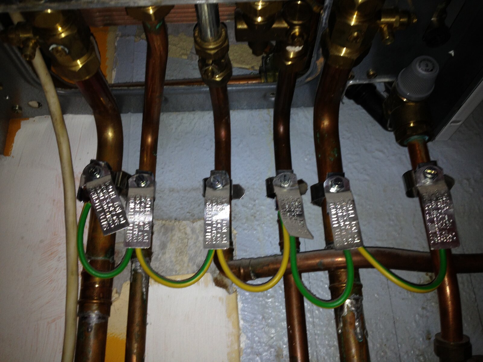

can anyone please tell me which valves I need to open to fill up a vaillant turbo max 828e?
Doesn’t appear to be any of them. Do you have a braided hose anywhere? Take a photo a bit further back.
Thank you for your prompt reply.

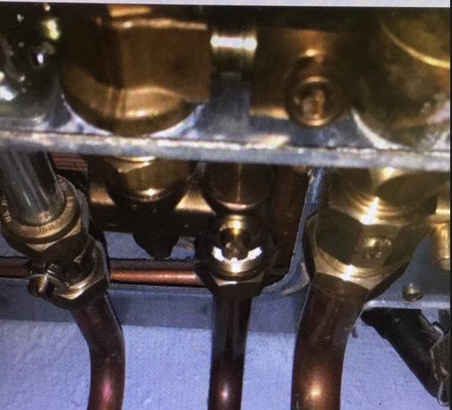

I know what you mean about the braided hose. I was looking for that myself !! My other boilers have the braided hose and are simple to fill up and return the pressure. I don't live at the property so can't take more photos. But here's another photo taken - sorry, prob not much use.
I can’t see an integral one, and instructions state external, so you’ll need to find that loop. Could be hidden in a cupboard somewhere, perhaps a cylinder cupboard, or even a kitchen cupboard.
Pretty sure the valves are under the boiler, I have circle one and the other one should be to the side of it.

Very luckily for me they were changing the carpets and with no carpets it was easy for me to lift some loose boards to find the filling loop.
