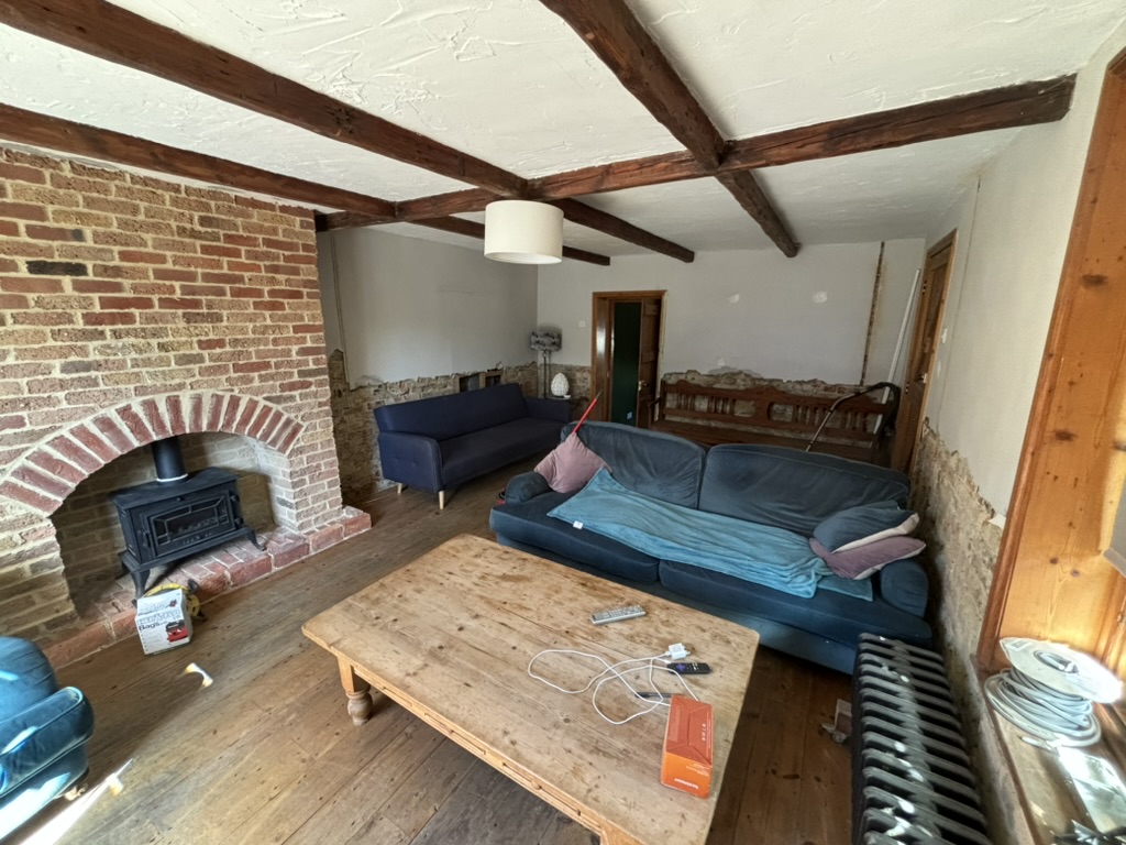

I have this old coffee table. It's a bit of a mess but I quite like it that way. Only problem is that it's a light wood and all other furniture in the room is dark wood. I think it's oak but not sure.
Any recommendations on getting it dark without losing the character too much? I've had limited success with stain but was thinking of sanding to 180 and going at it with some tinted hard wax oil. Sound sensible or stupid?

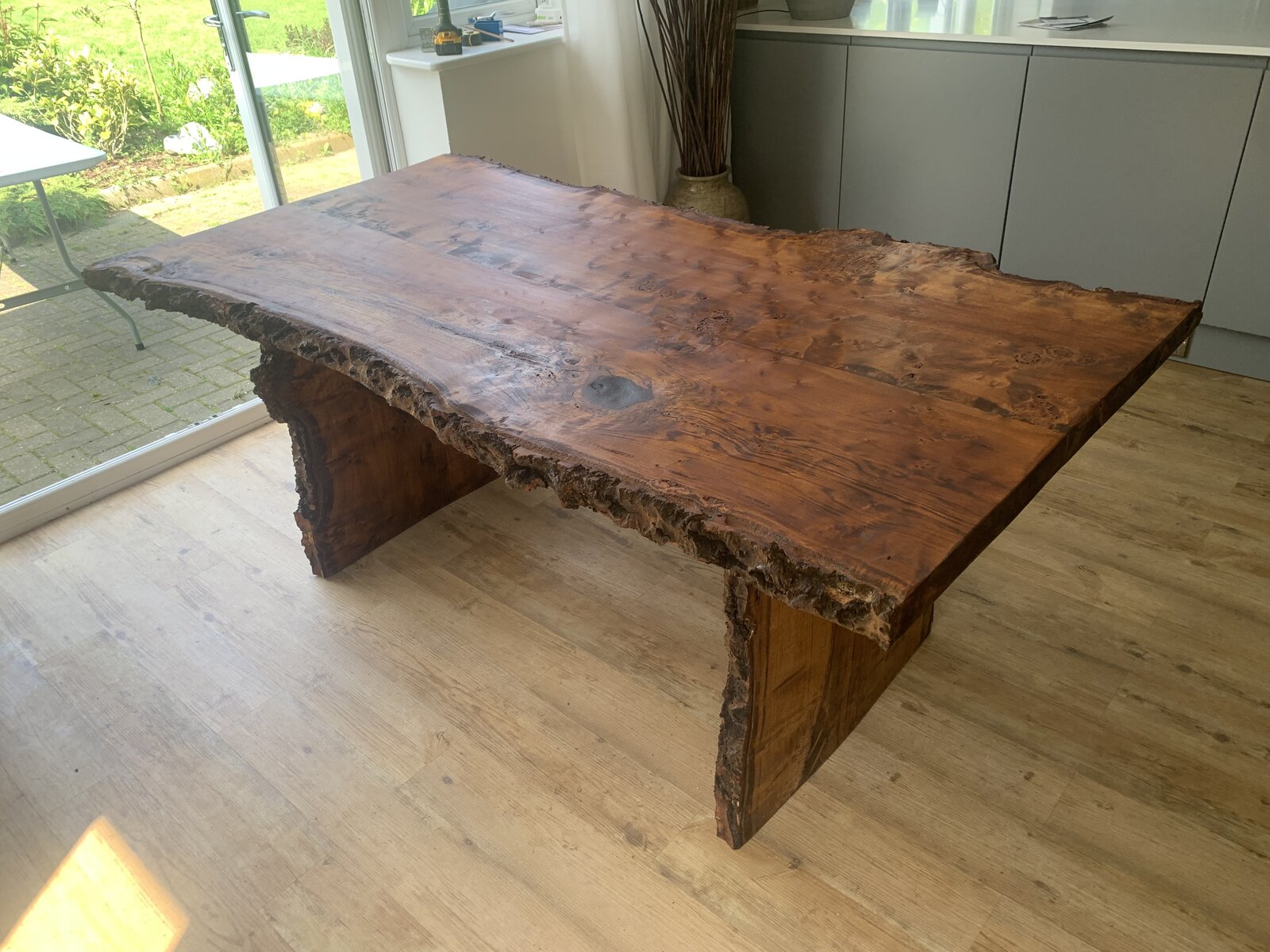

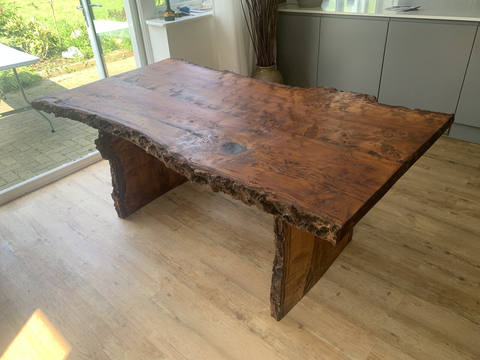

I used dye on this table and sealed with osmo top oil which is much harder wearing than a wax , which will mark easily with any water stain.
