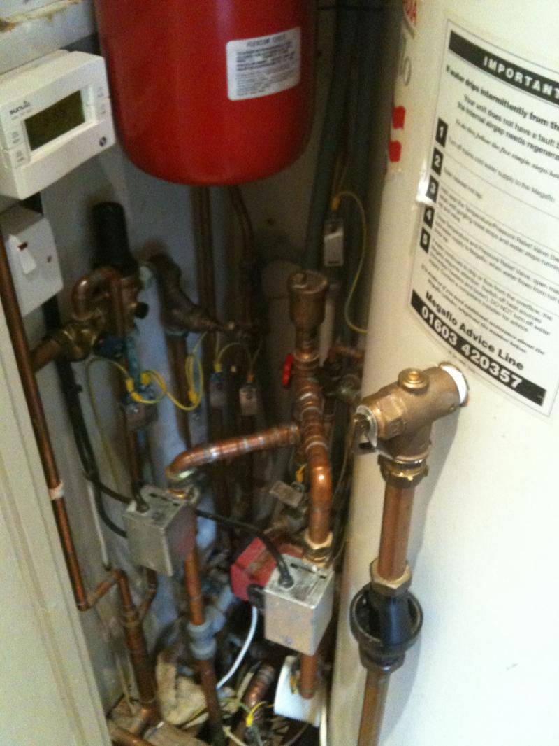

Can you post a pic showing a general view of the HW cylinder and the surrounding pipes/components.

I've been away for a couple of days. I'll post a photo tonight.

That's a Megaflo unvented hot water cylinder. You need to call in an engineer who is Gasafe Registered and has an unvented G3 Certificate.
The G3 certificate is important as it is illegal to work on an unvented cylinder without it.

The lates is that I think I have found the thermostat. When I turn it up nothing happens.
In fact...nothing happens unless the timer on the boiler is on override.
Then the water works fine.
When the heating & water is on on the Sunvic, the radiators heat up....it seems as though the boiler doesn't even need to fire
This is really beyond what a DIYer should be doing on an unvented cylinder.
There should be a grey cover lower down and inside a cylinder stat which controls the boiler's call for heat.
Also inside the cover is a manually resettable ficed temperatures stat which is wired in series with the motor in the spring return valve on the cyl's heating coil.
