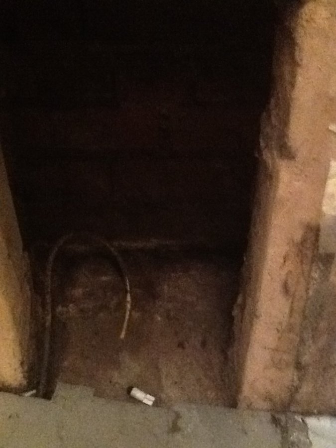

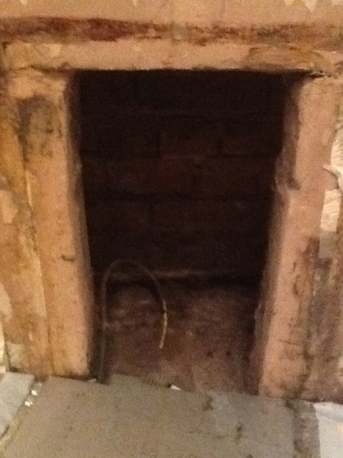

Originally my house had open coal fires. This is the void behind where a later gas fire was installed.
I want to re-install an open fire once again.
What do I need exactly?
Cheers

Clear photos showing detail and a whole pic of the chimney breast would help.

Do I assume you intend to reinstate an open fire, so as to actually use it. Are you aware that they are only about 15% efficient, and that it sucks in cold air, and then sends it up the chimney. You're warm in front of the fire, but you've got a cold draught behind you. Think about a coal stove instead.
Doggit makes a great point: there is very little actually attractive about an open coal fire when you take the dirt, smell and intensity of care into account along with the chimney being a constant source of heat drain when the fire isn't lit, and a constant source of pollution that neighbours hanging out washing won't thank you for when it is lit
Sure, there's a romantic aspect to it that tugs at the caveman heartstrings in most of us, but getting a some kind of log burner that is room sealed, so it gets its air from outside, burns and puts its combustion products up a flue, is going to be better all round..
