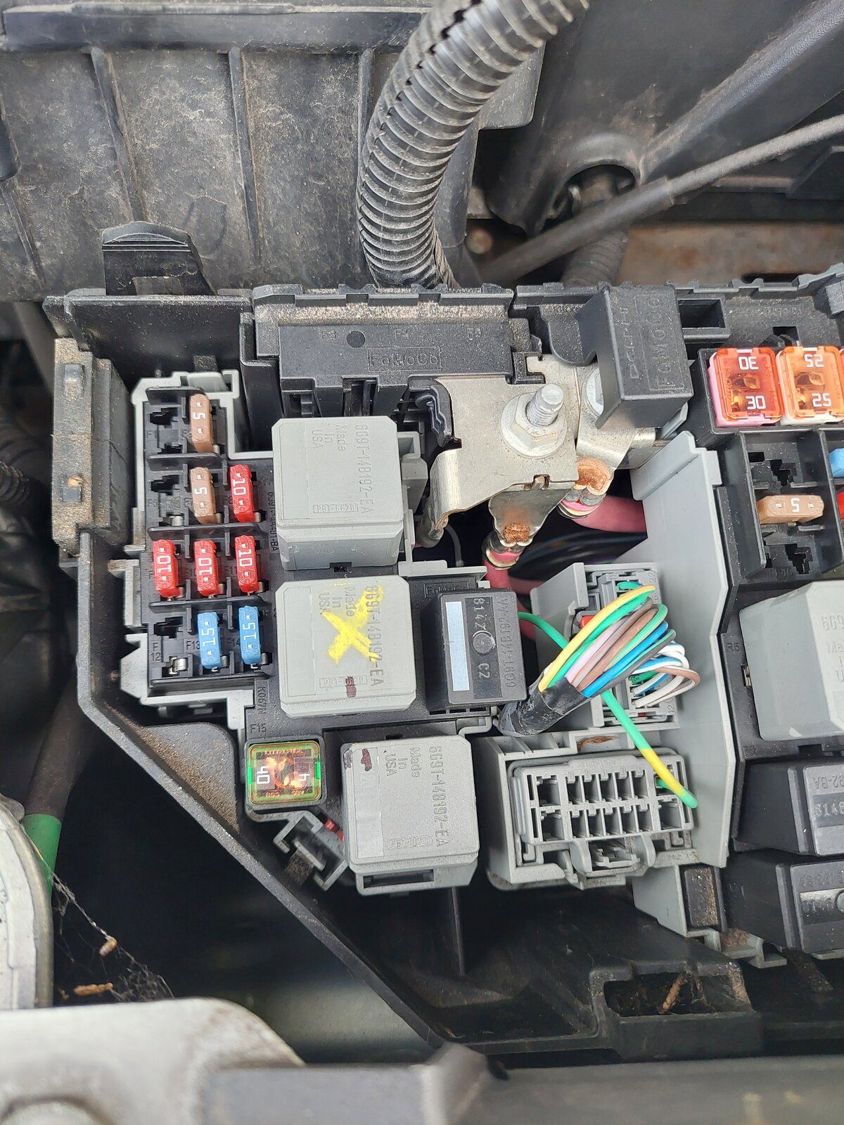

I have an issue with my 2008 Ford Mondeo estate Diesel 5 door Titanium.
This morning when I went to the vehicle the door opened with no sound or flashing indicators? I pressed the start pushbutton, but nothing completely dead. After 30 minutes of messing about I phoned the RAC. The mechanic tested the Battery +3V so the Battery had run down. He put a Battery pack on it & quickly had it running. On further investigation he found that when switched off there was a relay pulling in every 60 seconds. There was no labelling on the lid of the cover so couldn't establish what was calling on the the Relay. he said to take it to a garage for a diagnostic check.
I remembered that I had a similar fault last year where when I pressed the pushbutton in to start it would blow a 20A fuse. The garage did a good job in finding that part of the wiring loom behind the dash had worn through rubbing on a bracket creating a short circuit. They taped up the looming & its been alright since. However, if I remove the said Relay Ford Mondeo Relay 669T - 14B192 -EA the car won't start at all so I'm now suspecting that this new fault is on the same circuit as the pushbutton Start? I swapped 2 similar Relays but the fault remains the same? Every 60 seconds it gets a pulse & will eventually flatten the Battery. I've made sure that the intermittent wipers are switched off & cannot think of another timing issue that would cause this?
Any idea's folk?
Best regards.
Steve.

if I knew what Relay 669T - 14B192 - EA was for I would have an idea what was switching it on? There are 3 of these in the same box. I have swapped with one of them & that relay switches on also, every 57 - 60 seconds. Like I said earlier its as though something as been left on like intermittent wipers? Do you know of anything else that would activate a timer when the engine is off? if I leave the Relay out the engine won't start up so it is something to do with the start up circuit?

Usually there is a pictogram along side fuses and relays, to indicate what the purpose of each is, plus a fuse/relay number - is there nothing like that? From that you may be able to identify is from Ford's list.
Take a wide photo of the relay, in situ, so it's purpose can be identified.

The Relay with the Yellow X is the problematic Relay.
Just one thing I remember is when I 1st open the Car Monday morning the Tailgate was still locked even though the other 4 doors were all unlocked?
All three of those similar relays appear to be identical relays - you could try swapping them. You could also try pulling the fuses, to see which, if any, stop the cycling relay - then try to trace the purpose of the fuse. Some where you will be able to find a legend for the relays and fuses. Mine, not a Ford has the legend in the lid of the under-bonnet fuse panel and another one stuck to the back of the panel you remove, inside the car to access the mass of fuses in there.
Another idea might be to monitor the current between battery and that relay/fuse panel, with all doors closed and locked, brick on bonnet sensor if there is one. Once car has gone to full sleep, it should register around 20 to 50mA.
