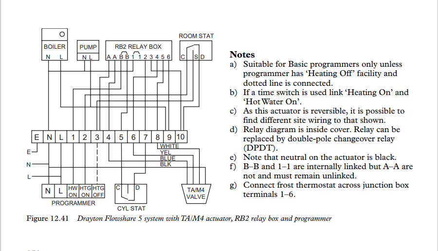

No need to guess how to wire anything as there are resources for just about any controls ....
It might stop the op trying to get someone to change the relay as the original momo valve is no longer there.If it i the actual relay which has failed, sourcing and replacing just the relay is one option. The relay is the part in the box, in a clear plastic case. Some relays simply plugged into a (octal) socket, so very easy to replace - if one can be sourced.

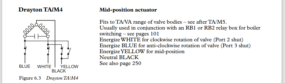

Just re read the whole post, you already have a 3 port mid position valve fitted ? I think the old relay valve will be redundant, you wouldnt have both
This is not a recent fault then, it has been faulty since last FEB when you got the part from toolstation for the plumber.I have a 3 port mid position valve. I do not have a relay valve. I have a Relay Switch. It is my understanding the Relay Switch is not wired up correctly. When the 3 port mid pos valve was fitted, the wiring on the Relay Switch wasn't altered.

When you ring, just tell them you need someone competent to sort out the wiring of your heating controls. Explain you have had someone in who has made a complete muck of it.
That relay can't control the new 3 way valveI have a 3 port mid position valve. I do not have a relay valve. I have a Relay Switch. It is my understanding the Relay Switch is not wired up correctly. When the 3 port mid pos valve was fitted, the wiring on the Relay Switch wasn't altered.
I think I need to get a plumber/gas safe engineer who is totally competent in the electrics so that he can re-wire the Relay Switch.
