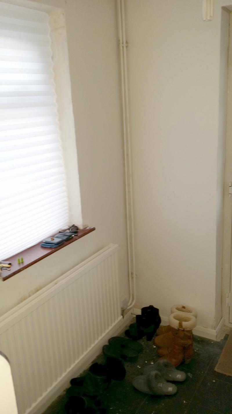

The radiator in the photo is in the hallway. You can just about see the front in the corner of photo and the pipes coming down between.
I'm thinking of replacing the radiator with one of those tall ones but installing it on the other side of the pipes and put a console table under the window.
By putting the new radiator next to the front door, will it make a major difference with the heating efficiency?
I know heat rises and with the new position being further away from the stairs I'm assuming there will be some loss but don't know how much of a difference.
It will look much nicer though!
Thanks very much and hope you can help.
That looks like a reasonably large double rad. Finding a designer rad of the same output and fitting it where you propose may pose a bit of a problem. Have you done your calcs and found a suitable rad?
If you are only bothered with looks, then I say go for it, but you will probably be a bit cooler in the hallway.
Make sure you get a column rad that is as close to the KW rating as the current rad you have

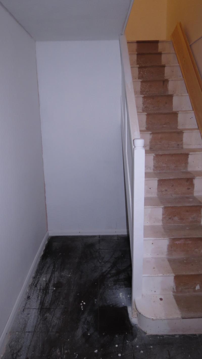

Nevertheless, I am now wondering if putting a radiator to left of the stairs would be better? I should be able to run some pipes along the skirting.

Generally they are located by the window to counteract the cold, so it's up to you where you put it, but if that double rad isn't feeling very warm, i suggest that you need to look at the system set up rather than moving the rad first.
I wouldn't put the rad there. Heat will be lost heating the underside of your stairs.
Between the door and window would be better than near the stairs. I got a high output designer radiator for my bathroom from www.geyser.co.uk but they are expensive! Looks good though and had a matching towel rail bar which clamps on (it was replacing a chrome towel rail which didn't give off enough heat).
