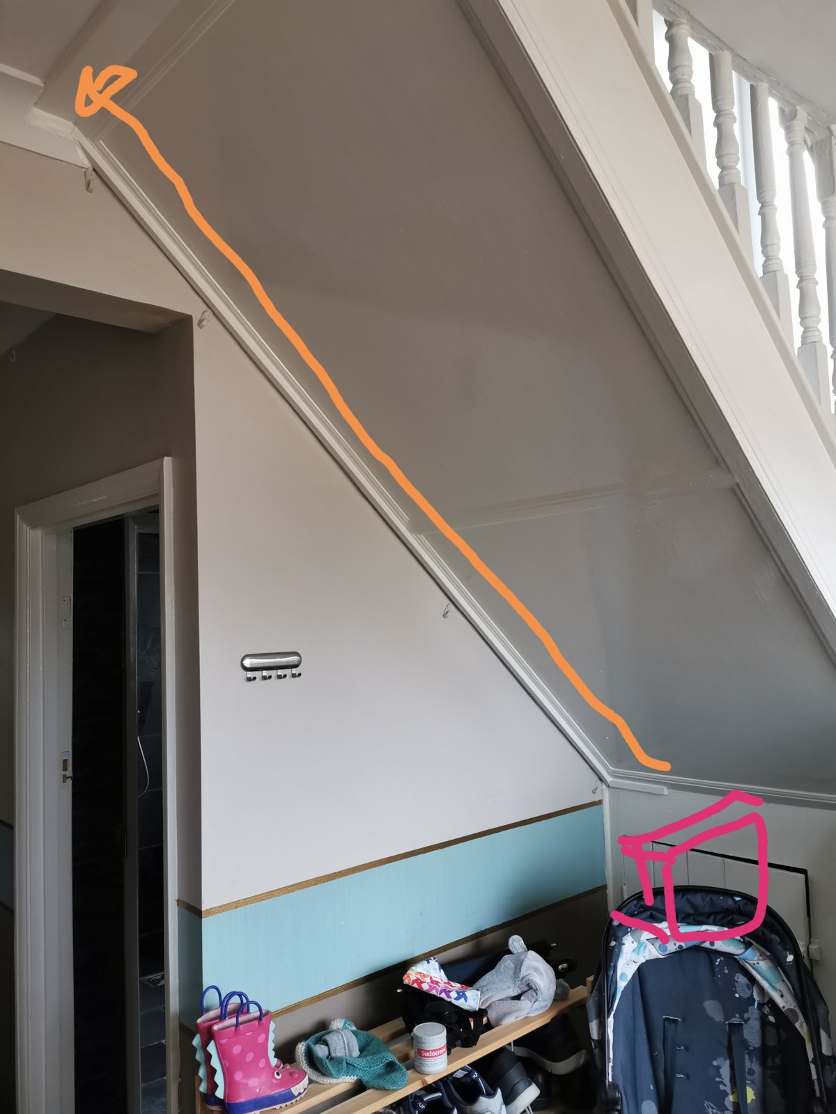

Hi All,
I have a cable running through my cavity wall. I'm doing some work in the room it emerges into and also want to put cavity wall insulation in at some point soon. As such I want to move it.
Is it safe (and legal?) for me to do it or should I book a qualified sparky in?
I would like to move the cable to the underside of the stairs. There is a bit of trunking shown on the image below that I want to remove and replace with something a bit bigger then re run the cable in it. My reading implies that surface mount wires are ok without any armoured conduit but if that's better I'm ok with that.
The CU is in the cupboard under the stairs (purple), the new route is to replace the trunking below the orange line.
At some point we'll (with qualified help) be looking at rerunning the cable and rationalising the number and location of rings, so bonus points if I can find a way of doing this that makes the Sparky's work easier in the future.

To restate the final issue,the (hopefully not fatal) flaw is that once I've connected it then I don't have any way to test that the ring itself is complete and it's not acting as a radial (eg by pulling the wire through and breaking one or more of the cores)? Is there a way for a DIYer to do that?
Edit: it's also probably worth pointing out that the electrics aren't, as far as I can tell, in a standard ring that meet current rules. Junction boxes under the floor and too many spurs etc. I'm not even 100% sure it's a ring Vs a radial.
