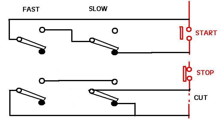

RF if you still want to keep the manual starter then all you need is a three position changeover switch switch
One of these would do
I will cut a copy of the circuit shown and paste it back adjusted
Matt

There you go
View media item 29079
The DOL starter will operate as normal when in the hand (manual) position
in auto the remote machine will do all start/stop operations the buttons will have no effect
the off position will prevent either systems from working
if you really want the stop button to work in both situations(can't see why) then that can be done pretty easily too,
Let me know
Matt

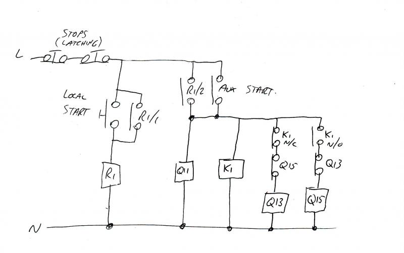

Ok was up late with the brat so did one anyway
as well as the change over switch you will req a double pole relay and if you want an off position on the selector switch then you will req a double pole one of those too
View media item 29081
As before The DOL starter will operate as normal when in the hand (manual) position
in auto the remote machine will do all start/stop operations but this time the stop button will stop the pump
after the use of the stop button or off position then the start button will have to be operated to "reset auto" (to relatch K2)
you could wire "manual on" warning light to the spare terminal on the switch if you like
and a "auto on"one to the A1 side off the k2 relay contacts while your on
then If you are wanting to be really fancy, and if K2 is a changeover type and its common is put opposite A1 (A1 on n/o) then use the unused n/c contact to supply a "auto reset req" warning light :)
the off position will prevent either systems from operating
Its actually not much of a modification when you get down to it not a lot to do at all really
you are removing the link on Q11 beween terminals 14 and 54 and connecting the switch to them (com on 14 manual on 54)
the auto side of the switch you wire to K2's coil and to the com of one of its normally open contacts
the other side of this contact goes via the other pole of the switch to Q11's terminal13 then loops back to the com of the other set off K2's n/o contacts
now you connect the remote machines aux switch between this sets n/o contact and anywhere along the manual switch line (common toQ11 terminal 54)
hope that helps,
Matt

Agreed,
this is only the control circuit,and only shows electrical interlock
Q11 is the main contactor
Q13 is the star contactor
Q15 is the delta contactor
K1 is the timer relay
F2 at the top is the O/L normally closed aux contact
All connections shown are coil and AUX contact connections
the motor connections are on the drawing to the left in the photo (you can see the star conntactor)
Matt
I'd put it after S11.0, this will retain the emergency stop function that your's removes..
S11.0 is not an emergency stop
its a normal stop, it doesnt latch, thats why I wouldn't put it after
but adding one before the stop switch wouldnt be a bad idea if needed
Matt
