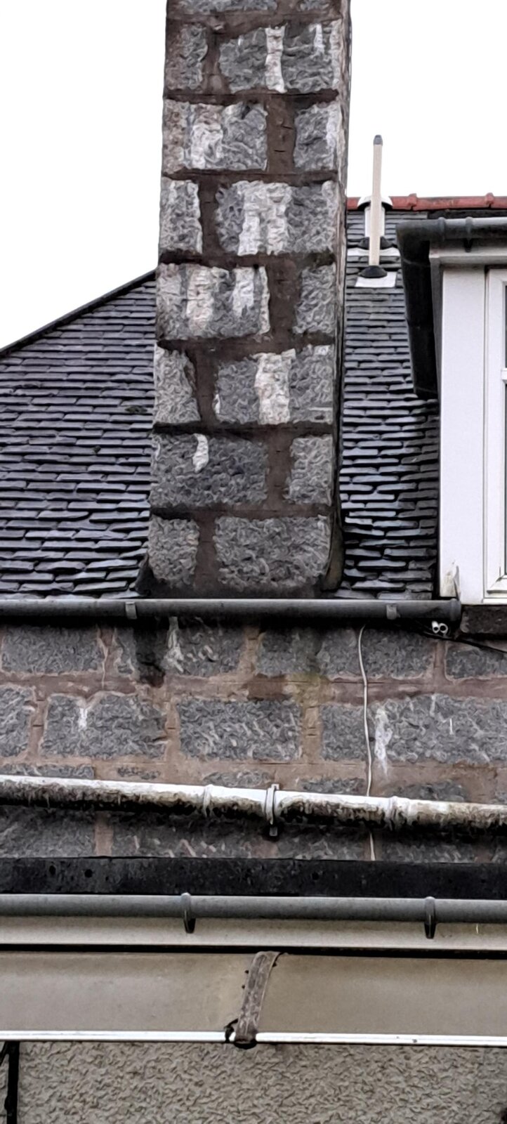

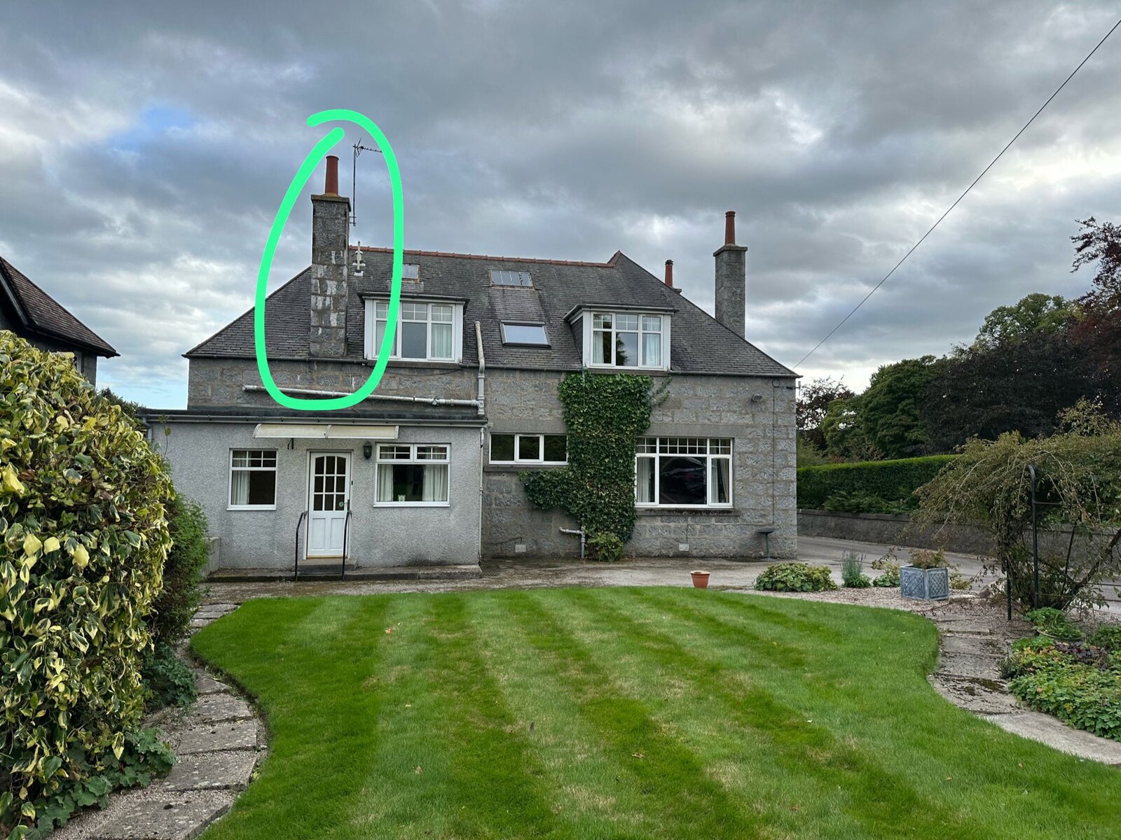

I am looking to have a chinmney removed, and the roof slated over at the point the exisiting chimney penetrates the roof.
Could anyone give me an indication of amount of man hours involved in this / scaffold / general idea of costs?

£2.5 - £3.5k.
It would likely take us a day to bomb that chimney down and repair the roof, once the scaffold was in place. Possibly run into two days depending on scaffold lifts, access and waste removal etc.
