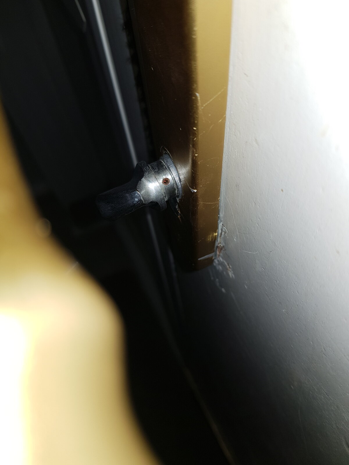

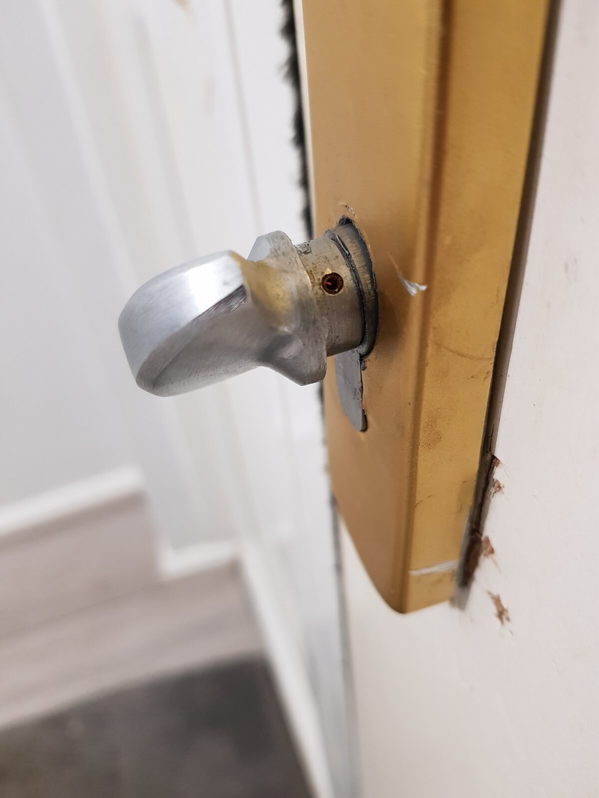

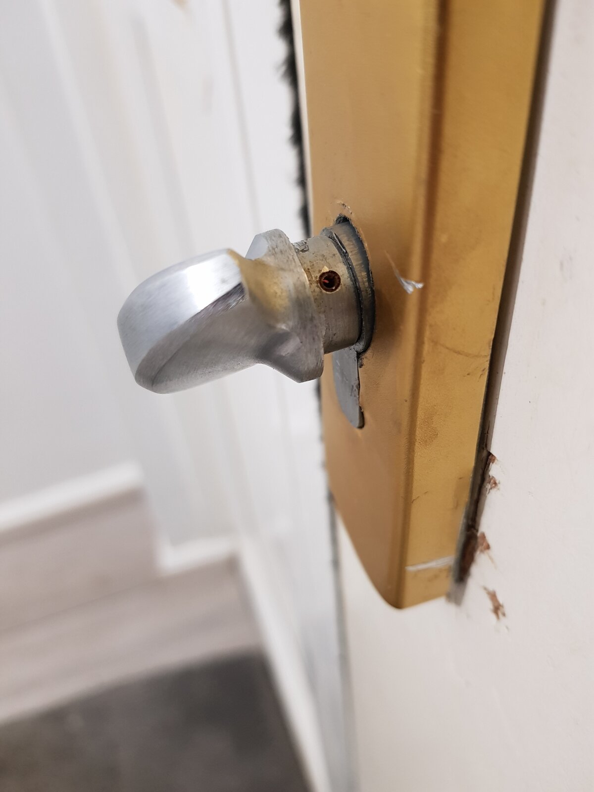

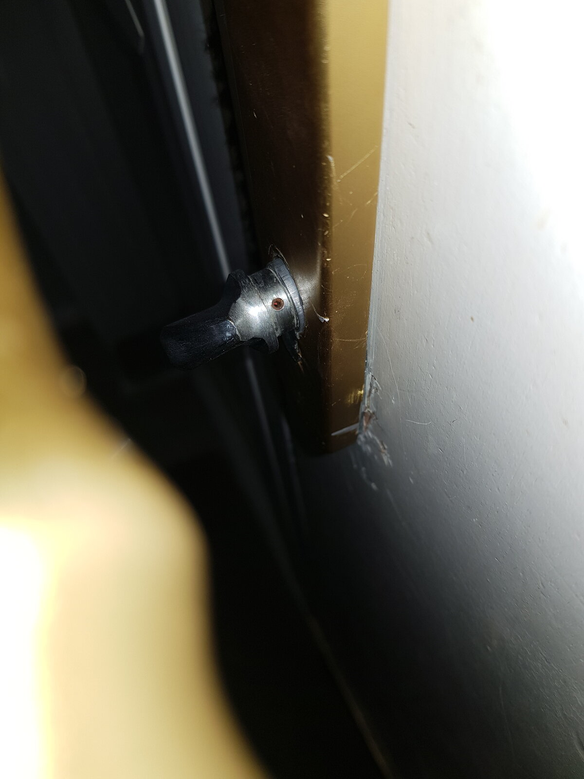

Does anyone know how to remove the door lock handle bit so i can remove the gold cover bit so i can tighten the screws as the whole thing is loose picture attached thanks guys
I spy a grub screw or perhaps the end of a roll pin in that first photo. Unscrew that if a grub screw, or punch it out with a nail and the handle should come off.
Thankyou brother sorry completely forgot to thankyou made it a 30second job haha
