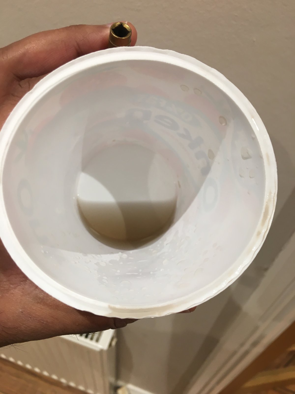

Removed air from radiators water dark black
21 Aug 2019
310
9
Hi I removed air from the radiators in the house and the water from the radiators was mainly black Is this a problem do I need the central heating flushed out any advice would be helpful thank you
Yes, I'd recommend at least a mains flush. Cleaner in, run for a few days, drain and fill .. repeat a few times to flush all the cleaner out.
Might be an idea to fit a filter at this time. Then fill and inhibit
