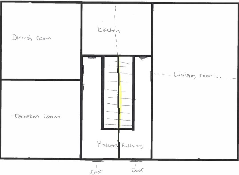

Hi guys,
please excuse the pretty poor layout above, but this is the basic layout of the current properties. hope this gives a clearer idea of the plan

I would not remove the whole wall (between the stairs).
You could probably knock through the wall at the front door, enabling you to close up one front door. You could probably then remove one staircase, either completely or remove the stair treads area leaving the side walls, and put a downstairs cloakroom and storage cupboard in. If you have headroom you may be able to make a 'shortcut' under the stairs outside the kitchen doors - which would make closing up one kitchen door feasible.
Upstairs you retain the U shaped landing and floor over the area where the stairs were, leaving it as open landing or fitting storage cupboards. Knocking through the two boxrooms is also likely to be possible.
Another idea if the roof allows it is to open up the floor area of one staircase from ground to roof level and put in a large rooflight, possibloy with internal windows from the remaining staircase to the 'atrium'.
You really do need a structural engineer to plan this out for you (and give you the design certificates you will need for Building Control). Reinforcing to the walls, floors and roof means this is not a minor job for two blokes with a cement mixer one weekend. Your housing is being rebuilt.
