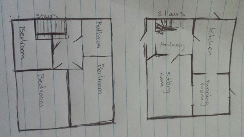

I have a non load bearing wall between my kitchen and dinning room which I would like to remove. The wall is 2.45m long and 2.72m wide with a door in the middle (removed the door). I had a surveyor round who confirmed its a non load bearing wall. There are no electrical sockets attached to the wall and I don't think any pipes running in it. Now I have gotten a quote from a builder for £9000... I'm speechless till now. The stupidity. It has put me off calling anymore builders.
Now the videos on YouTube make it out to be so simple so I figured why not give it a ago. I'm pretty good with my hands and tend to do well first time round but this is something new and would really appreciate it if someone would talk me through.

If you are sure that's it's not a load bearing wall they are easy to remove
You said you had a SE tell you it's not load bearing is there a wall directly above it?
But do the bedroom floor joists rest on the wall?
There may be no wall directly above it, but if the floor joists rest on the wall, the joists themselves may be supporting a partition wall.
How would I find that out? I don't think It is. Surveyor didn't mention anything about that
Did the surveyor go upstairs and look under the carpets (or whatever you have down) to see which way the floorboards run?
If they run parallel to the wall downstairs, there is a possibility that the floor joists are supported off the wall.
Can you post a plan of upstairs and downstairs?
He did not. Just tapped the wall (hollow) and confirmed it was non load bearing and would not need planning permission.
Will draw a rough plan in the morning.
