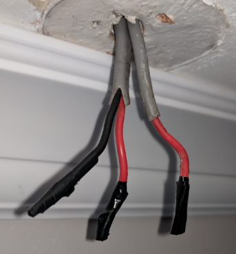

I'm after some help in removing a pull cord in a bedroom. There is also a light switch, which is staying. I have disconnected the pull cord and, I guess, unsurprisingly the light switch now doesn't work. Unfortunately I didn't make a note of where the wires terminated in the pull cord. :censored:
Once sorted I plan to install 6 x downlights. I know there is no earth, and have purchased the appropriate class 2 lights and will be purchasing another plastic switch.
Here are some pictures of the wires that went to the ceiling light (just two wires), the switch, and the pull cord.
https://ibb.co/crSf8bs
https://ibb.co/3YQmm0b
https://ibb.co/z457cQk
How should I take the pull cord out of the equation?
Thanks.
Temporarily join the two reds together and leave the black safely terminated.
At the switch, disconnect the black wire from the switch and safely terminate it.
Then when you go into the loft and route cables for the new lights, reconfigure the wiring by disconnecting and removing all unnecessary cables.
