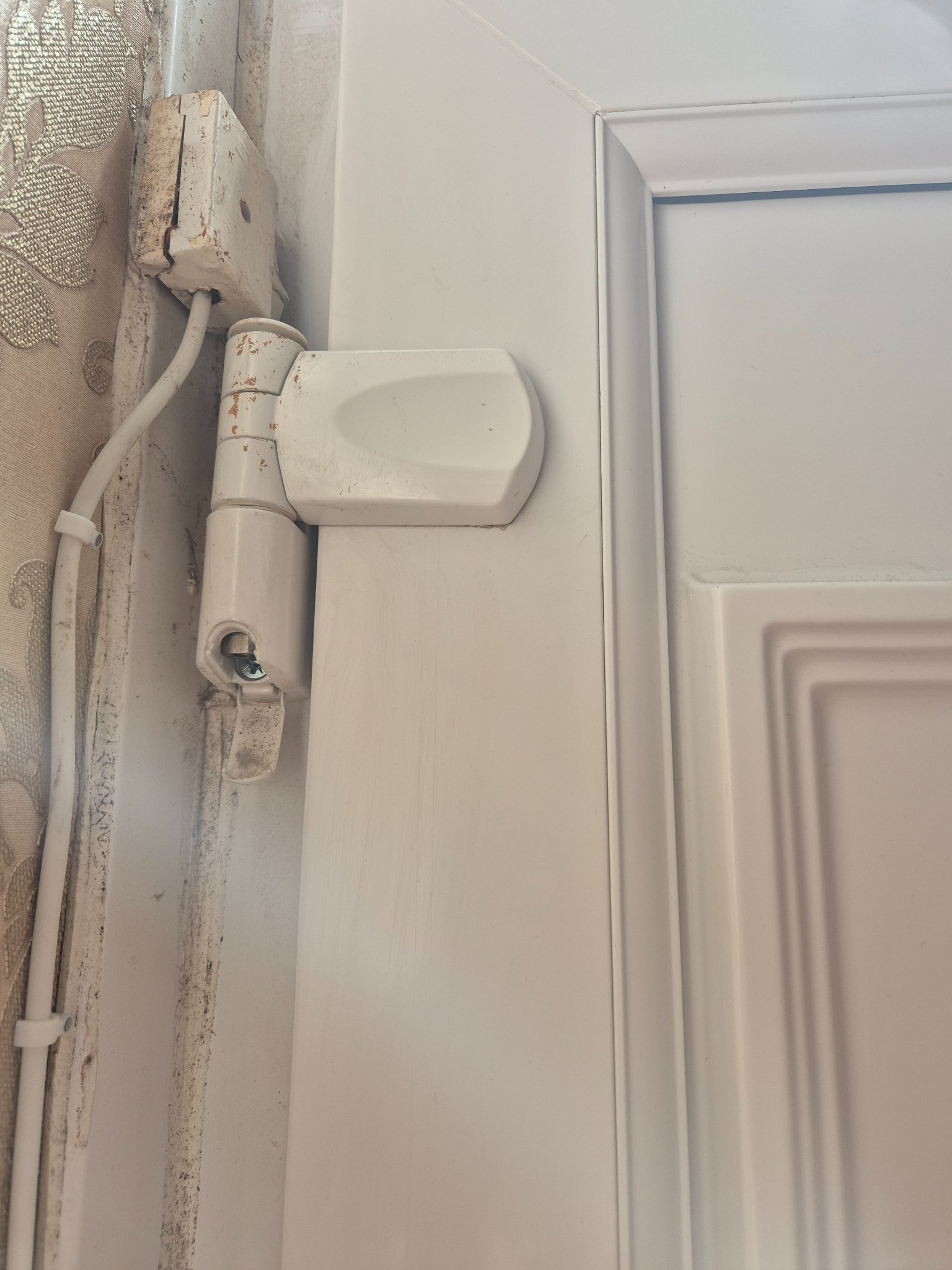

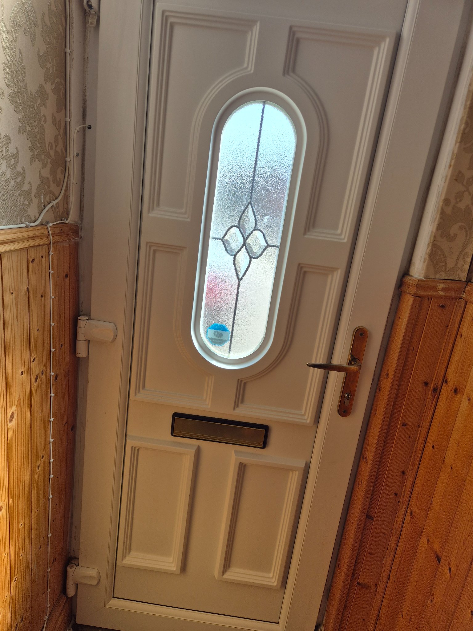

Was wondering if anyone could advise. Will have to take my door off due to me getting a fridge delivered.
How would I go about removing it so it is easy to put that back on?
Have attached pictures to make explanation clearer

It will be heavy so might be helpful to have an assistant. But have you actually checked if taking the door off will be enough? How would taking the handle off help? Surely the pinch point is when then door is open - the gap between the open door on the left and frame on the right?
The handle is (probably) only two screws (from the inside). Then pull the square bar out if need be.
Yep your right, tried this before, was easy to take off. Think Im better off using my alley way passage and going through thag way
As per Freddies attached YouTube really, once you have hinged all 3 covers open you can now lift the door up off the hinge pins, with the covers closed it locks up the pins, you'll need to remove the little junction box from above the top hinge though in order to be able to lift the door up
