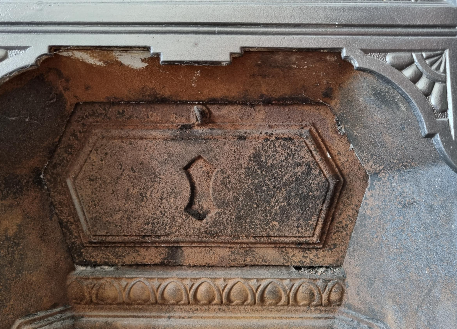

That would be what I would do. Unused chimneys don't need to be ventilated in to the room. In fact, even when they were installed in victorian/edwardian times seldom used chimneys were fitted with a closure flap to completely seal off the chimney from the room, like this one in the bedroom of our house.

That was intended to be closed between uses of the fire. If it got condensation or the odd splash of wind-blown rain then it would sit inside the chimney until the next time you lit it, at which point it would be dried out and vented out of the top.
