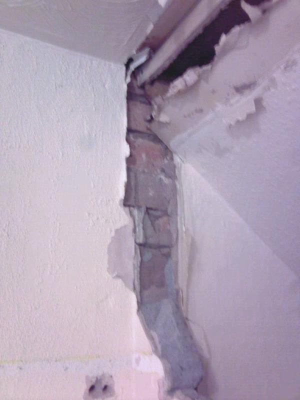

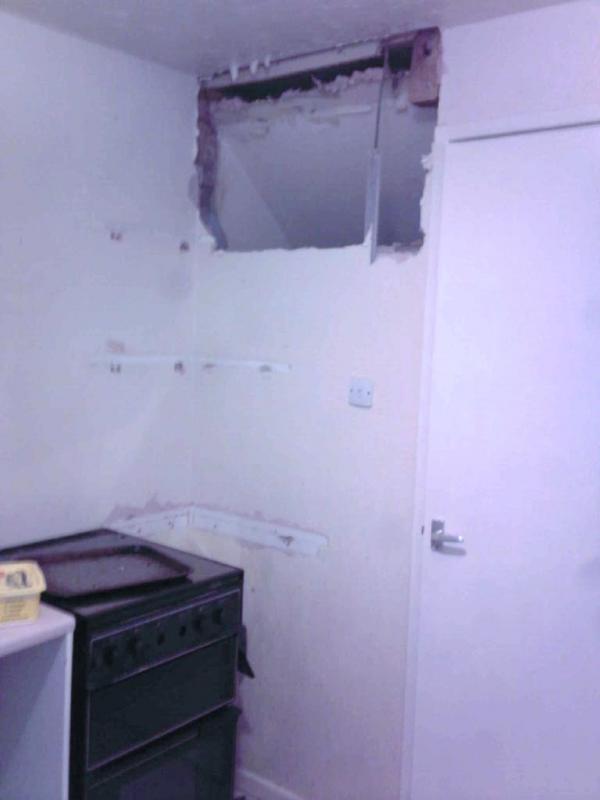

it appears the wall did not support anything under the stairs as there was a gap seperating the wall from the underside of the staircase. (and the plasterboard on underside of the stairs stretched above the wall) the wall also appeared to be made out of lightweigh fire resistant blocks. i have currently only removed one course just to inspect it! i will be uploading photographs a little later on tonight... and i can go through the intended project with you...
thanks noseall for your lightening quick response,
cheers,
luke :wink:

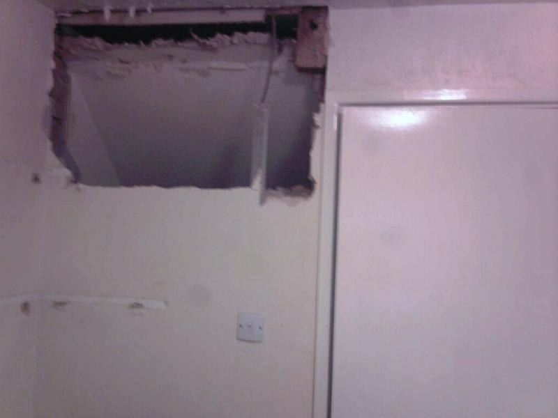

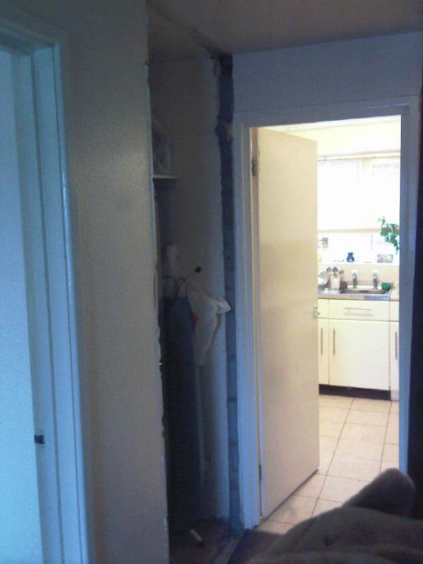

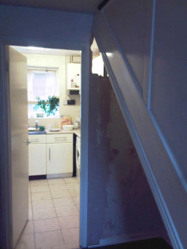

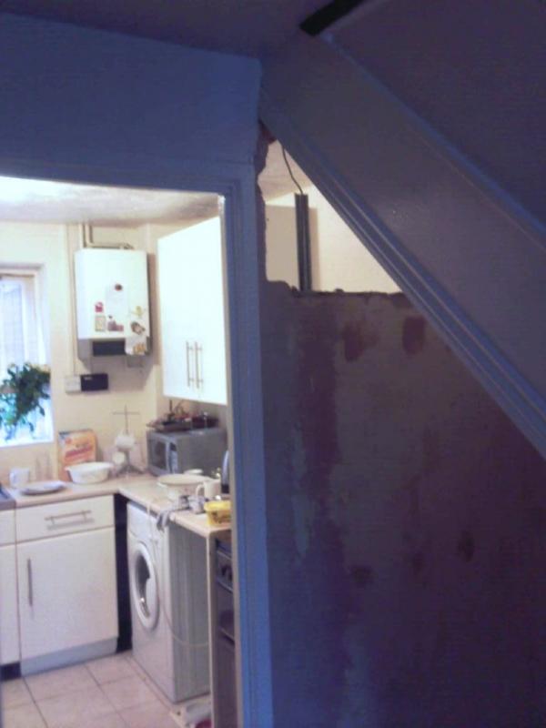

ok so heres the images. the plan is to move the kitchen door forward into the hall so it sits half way up the stairs (image6). (the new doorway will sit where the exposed brickwork is on the left of image 5) the whole wall will be coming out on image 1 (this shows the inside of the kitchen (with the removed blocks on the left under stairs) we intend to put an rsj along the width of the removed wall as to the right of the door is a supporting wall)
we are hoping to incorporate the space seen on the left on image 5 into the kitchen)

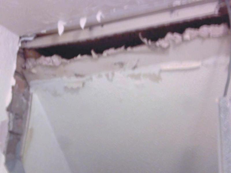

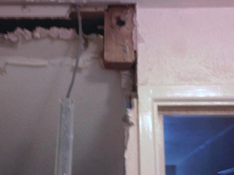

Luke , Would appear stairs are pitched onto first joist in kitchen. Possibly double joist. Stair well trimmer should also be hung on this joist, but there is a possibility that it could just be sitting on the partition wall that you want to knock down right next to where you have finished knocking down.
Looking from the hall into kitchen stairwell trimmer should just about be above right hand side of door lining. Go a bit careful there..

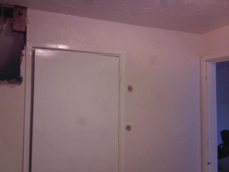

Recap. In front door, stairs to right, open space under stairs. Down hallway, door to lounge/diner on left, then cupboard that you have taken door and liner of, into kitchen, door from kitchen into diner/lounge. It is a open plan lounge/diner with no partition separating them. You wish to incorporate cupboard and part of underside of stairs into kitchen.
Providing the above is correct, then theoretically there should be no joists sitting on that wall, except for possibly the long stairwell trimmer which will be approx 50mm to the right of the bottom of the newel post that you can just see photo no 2. How ever it is up to you to ensure nothing is sitting on that wall.
Check again that the top riser or the top string cut of stairs is hard against a joist. Looking at position of stub newel, they may have used a packer on that joist, which should be a double.
Party wall should be two half brick skins with 1980 house say 50mm cavity. Joists on hangers.
Providing new door way is made up of studwork with plasterboard and skim each side providing half hour fire compartment, this will conform with building regs and your own piece of mind. Feel sure some one will contradict me if wrong.
Hope this helps. For guidance only.
