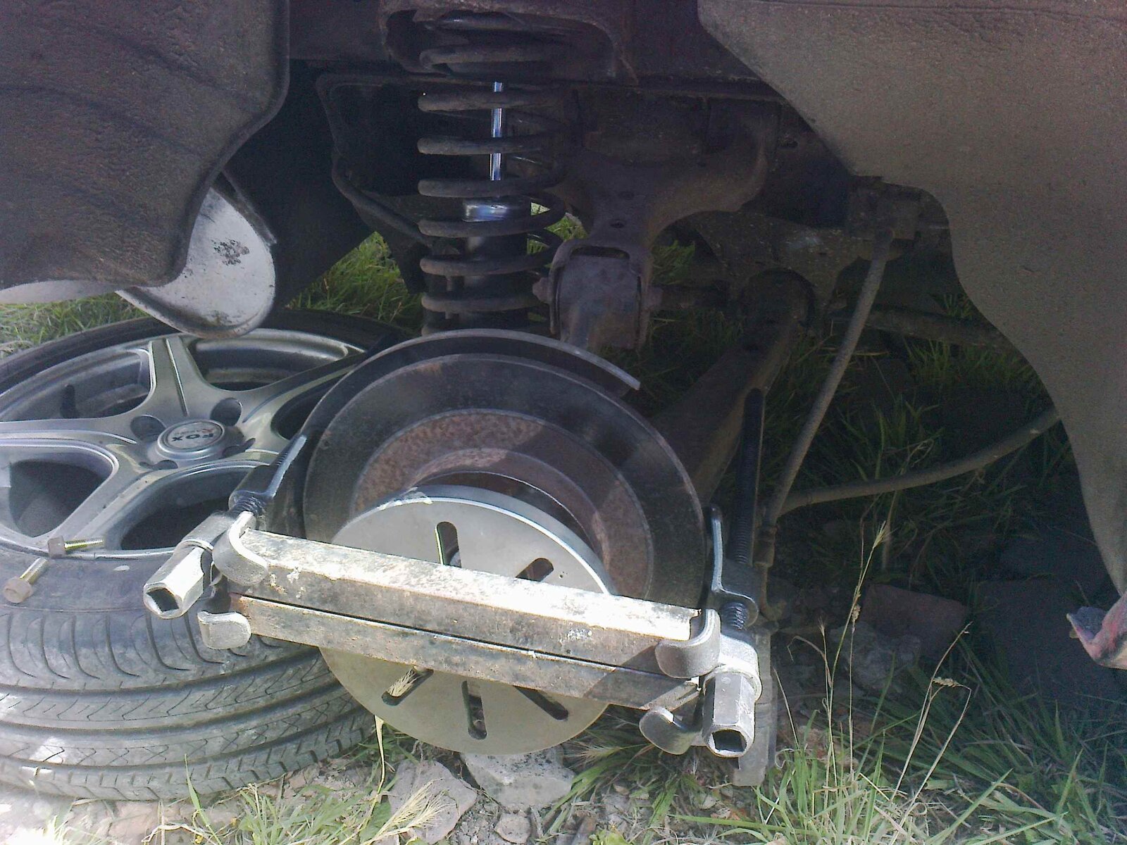

hI,
I made a puller from a lathe faceplate and a pair of spring clamps, tightened till I was blue in the face, and all started bending, heat spray hammer. Still on.
When I bought it. it had sat outside for 19 years with no cover.
C

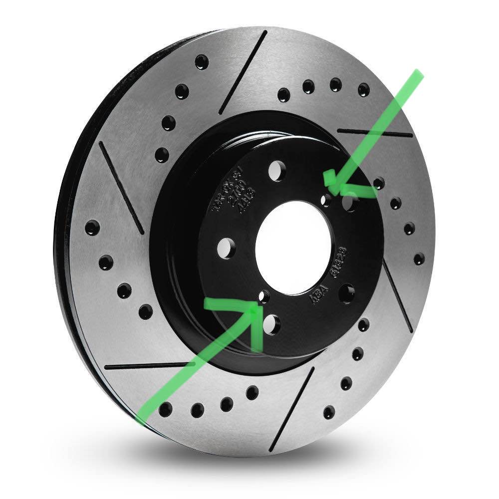

Yep they sometimes have a threaded hole or two, the bolt screwed in jacks the disc off the jub.
I doubt you would have got it off without heat though regardless.
There’s a thread in the disc between the wheel stud holes that if you put a bolt in and tighten it, it pushes against the drive flange and pushes the disc away from it. Some rear brake drums have the same thread.
