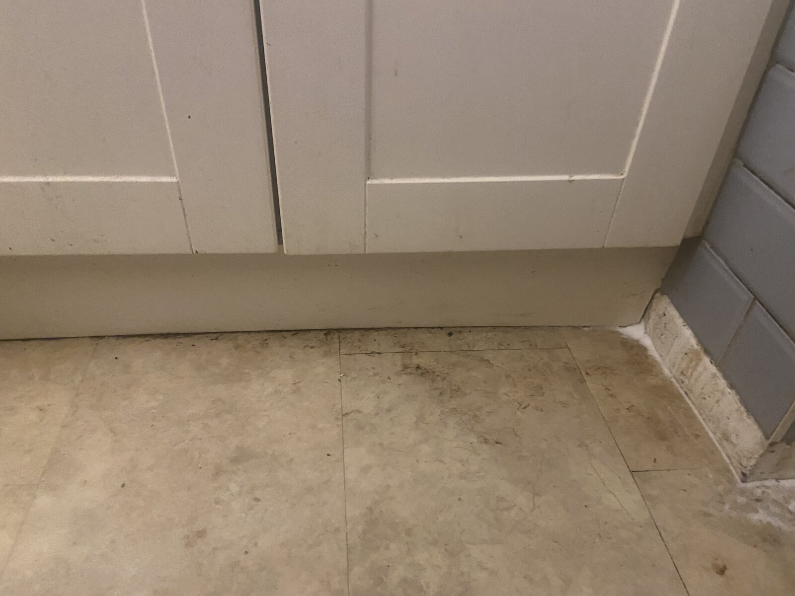

Hi
See images. Slugs somehow getting into kitchen via gap between skirting and plinth. I know there coming in from outside, but I want to take a look behind plinth.
Is there a recommended way to remove it?

Something like a wire coat hanger bent with a gentle radius pushed under round the arc untill flat on the floor then pull
its worth mentioning slugs start around the size off a grain off rice and can grow on little more than paper as a food source so dont look for say 12mm gaps look for 2mm or possibly smaller and dont use paper to fill as its an apéritif to the slimy ones

Thanks. You may have noticed the salt in the bottom corner of the picture. This is where said slug seems to have entered the kitchen.
