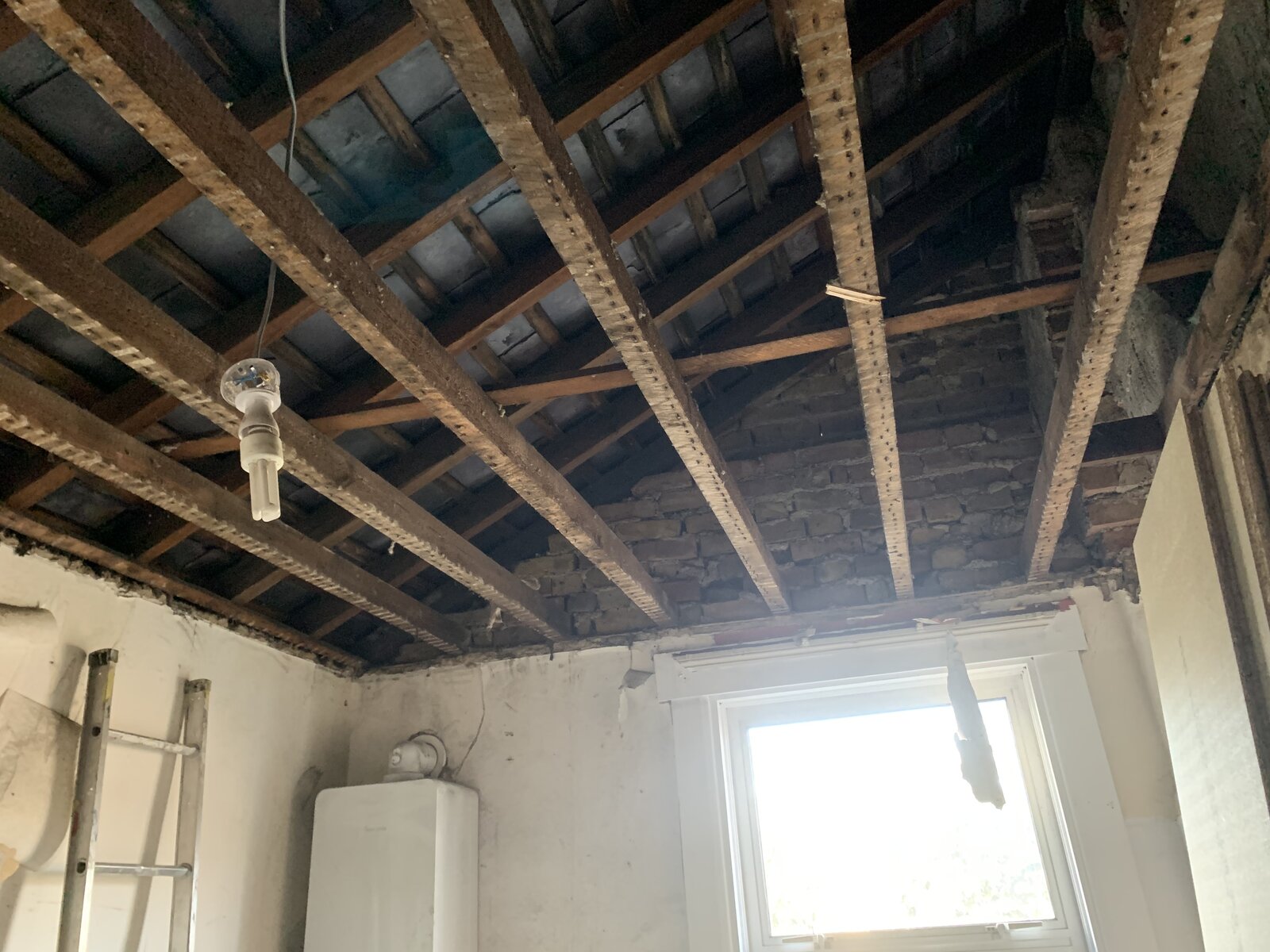

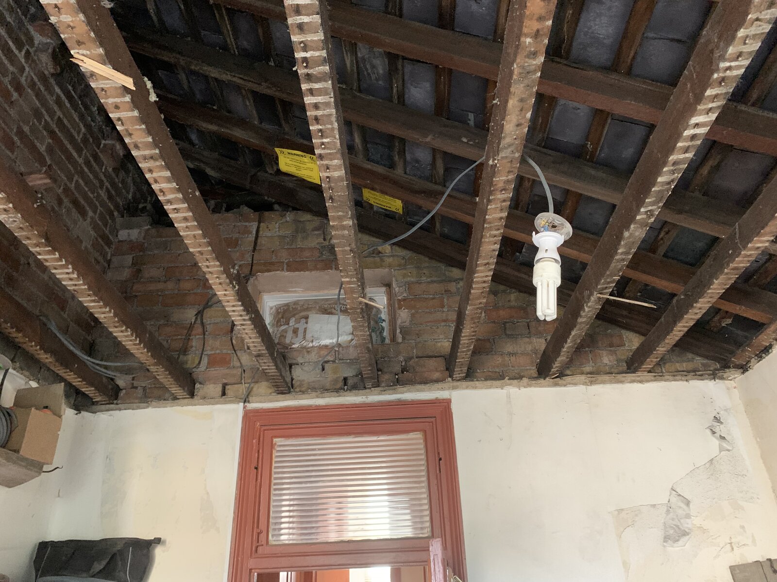

Hi, can anyone help. I’m removing the ceiling above what will be a bathroom to have a tall pitched ceiling with a roof light.
Am I right in thinking these ceiling joists are not structural and can be removed? I’ll be filing the hole with a brick.
Let me know! Thanks!
Removing ceiling joists, without understanding the construction of your roof can be a bad idea.
Ceiling joists can tie together the feet of the rafters.
Removing the joists could allow the thrust from the rafters to push out and spread the supporting walls.
I've asked for this post to be moved to the 'Building' section for some appropriate responses! :)
Ah thanks. Sorry I forgot to attach the pictures. They run in the opposite way to the roof rafters.
They also are a bit wobbly and don’t seem to be supporting anything.
Thanks!

I will leave the experts to have their opinion, but it looks ok to me as a DIY'er.

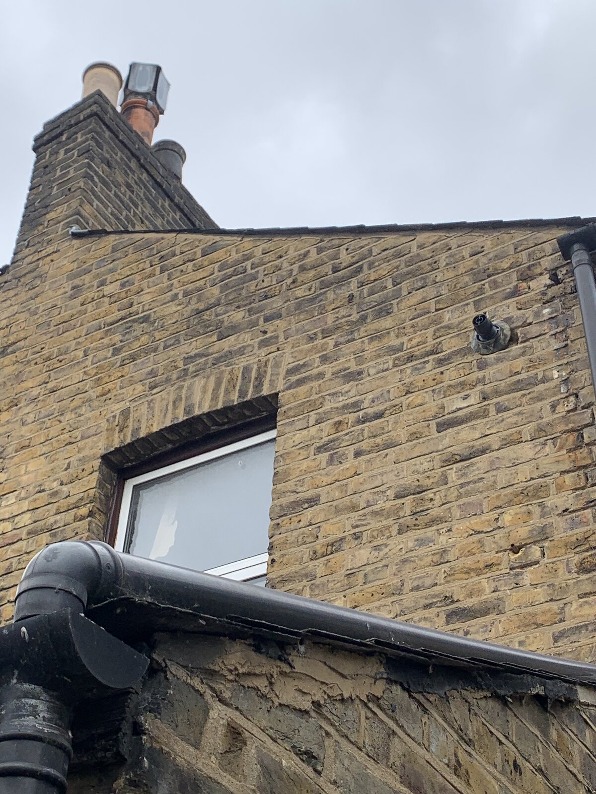

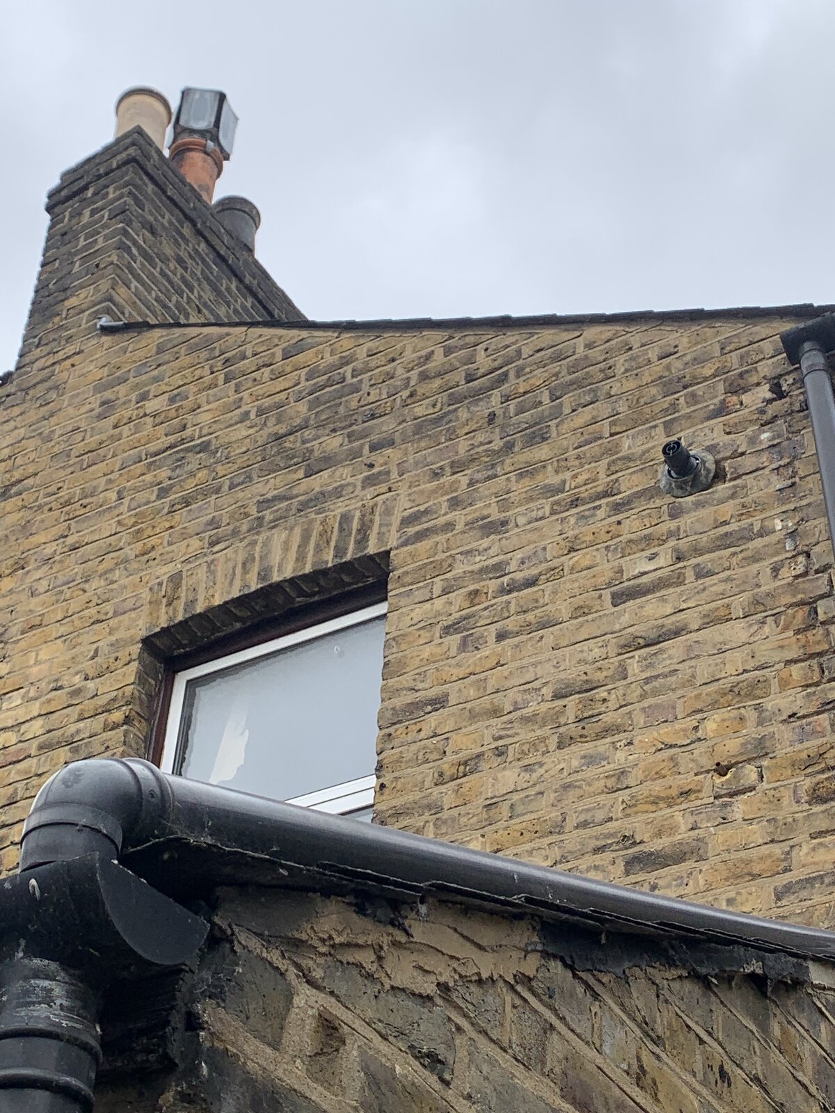

You really need to consult a structural engineer before removing them, it may well affect the strength of the gable end wall.
Some photos of the outside would be informative.
What is on the other side of the walls?
The joists don't seem to be doing anything.
However, this is controlled works and should be subject to building regulation approval for at least fire safety, thermal insulation, ventilation as well as structural.

I’ve attached a picture of the external wall.
-@^woody^ I’ve spoken to building control and they said I can give building notice for the actual roof which will all be insulated, ventilated etc.. do you still think I would need to go through building regs for removing the ceiling joists if I can confirm they’re not structural?
