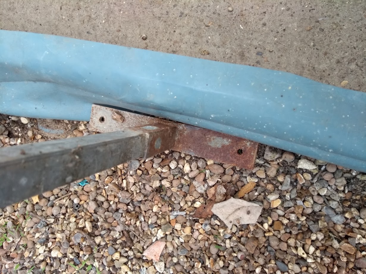

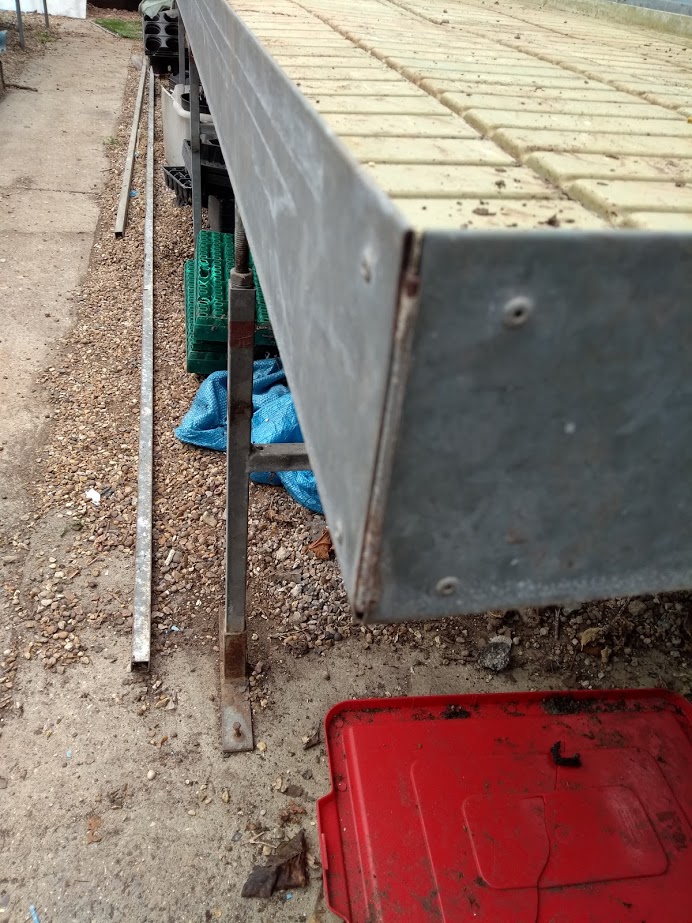

Two major issues I'm trying to help someone I know with.
Firstly, the framing below is stainless steel and concreted into the ground.
Secondly, the plastic stuff you see on top of the frame is fitted together (what looks like solvent welded).
What would be the easiest way to separate the sections? I was thinking a stanley knife with a few replacement blades to score a line? Trouble is it's so old and brittle now.
Easiest way to remove the frames from the ground so that they can be re-used?
If the legs are cast in, you've only 2 options, Kango or angle grinder.
I suppose uou could drill down the side of a leg and see if it comes free. A kango could create big cracks across the slab, so best to go gentle.
Or cut the legs and have staging for short people
Angle grinder with a diamond disc will slit the plastic really nicely with minimal damage (apart from the cut of course). And I'd agree with above, that rust on the legs doesn't look like stainless to me
There could be a plate at the bottom of the uprights so may involve digging out more concrete .
You could drill through the concrete as close as possible to the uprights to see if you hit metal and if you do, keep drilling outwards till you miss it.
If it is SS and worth keeping in tact, disc cut a square around to give an edge to chisel to.

You'll want a normal cutting blade for the grinder to cut the metal.
Alternative is a reciprocating saw with a blade for cutting metal.
I'd not worry about dealing with the concrete, just chop off the legs as low to the ground as possible, a grinder would make that pretty easy.

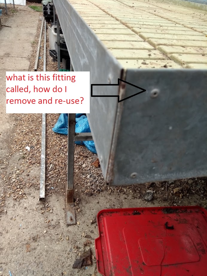

Ok, so I've managed to cut through some of the plastic with a hack saw blade, it was brittle enough, and was quite an easy cut.
Developing problems:
What are the fittings below?
They appear to be punched inwards to hold the galvanished metal in place? I need to remove them without destroying them to eventually re-use.
Secondly, were will I find more of these feet?
The metal is 25mm2.
Trying to keep this on a budget. So we've thought long and hard and decided to chop the frames at the base with a hacksaw and then pop feet onto the end.
