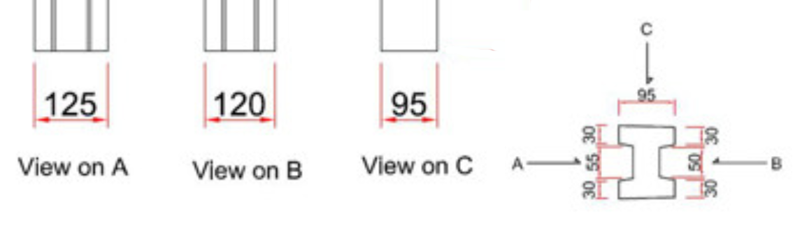

One last question if I may.
The posts I have have two different slot sizes (55mm and 50mm) (image of dimensions attached).
Is there any reason for the two different sizes?
The only reason I can think of is that the post cross section is tapered, to make it easy to remove the cast concrete from a mould, but the flanges either side of the slot need to have a minimum thickness for strength. Having a slightly wider slot on the wider part of the post minimises the amount of concrete used.
Not made in a precision engineering factory.
Near enough is near enough.
