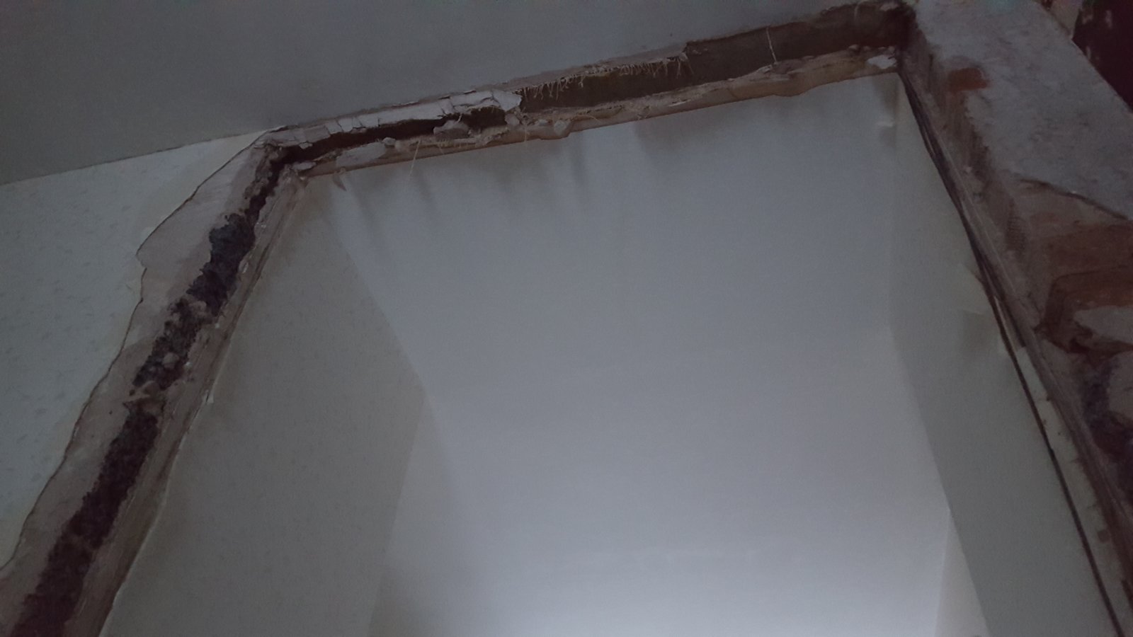

I found a 3mm gap between floor and bedding mortar at back of cupboard. Front of cupboard is properly resting on floorboards though. Gaps filled with variety of steel strips as far as practicable.
New stud wall up and stiffened with ply. I've tried to make it as rigid as possible, and it's tied to the wall either side with plenty of frame fixings.
