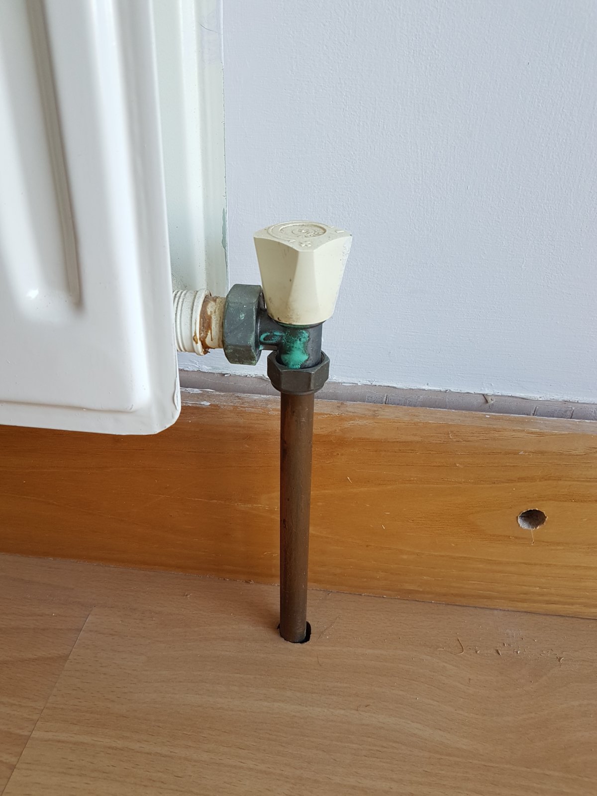

Hi
Complete newbie here.
I am having a new floor installed (laminate). I understand I can remove radiators by shutting off the valves, and bleeding, which based on sources online seems doable.
However, the new floor will need to be laid from above, and to keep things looking trim, I will need to remove the valve completely from the pipe so the hole in the laminate is pipe sized, not valve sized. Pic is attached.
Is this something that is safe to do once the water is shut off, or do I need to do something more complicated, such as draining the system, in which case I will get a plumber to do it? I have a combi boiler.
Thanks!
You would need to drain down the system. Not (normally) a difficult task. However it means that you won't have any hot water until you replace the valves (or cap the pipes).
The required hole may be bigger than acceptable though. Once you remove the valve the nut and olive will still be on the pipe. You can use an olive puller to remove the olive and then the nut but is it really worth the hassle?
BTW, in the image that you have posted, it looks like the floor was laid with the valves in place. The fitter simply cut two semi-circles out of adjoining lengths of flooring.

The OP has absolutely no idea so why subject him to all the potential trauma for so little gain?

I agree that there is little to be gained, however I am reminded of the maxim about teaching someone to fish rather than simply giving him a fish...
HarrieAndJojo as already mentioned,you can work around the pipes.
If scotia bead and pipe collars are used the laminate cut out is hardly seen :idea: A good laminate installer will be able to hide the cut out even without scotia and pipe collars.

Thanks for the replies. The overwhelming verdict is not to worry about the valves, and just cut around, so we'll go with that. I appreciate all the advice!

Ordinarily, there is expansion room required. The floor AND the pipes expand in heat, so there is luttli to be gained by dropping the laminate over the pipes. It would also add a lot of time to the Chip's work . The advice to remove the olives demonstrates a misunderstanding over the floor requirements, I believe.
As above. You need to leave room for expansion anyway, so a tight fit is not advisable. (y)
I wasn't suggesting that the hole should be tight to the pipe. It doesn't need to be as big as the nut though.
That said, yes, I should have mentioned the need for an expansion gap.
