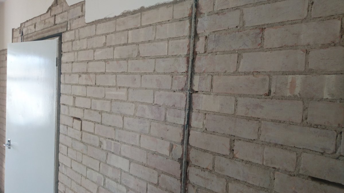

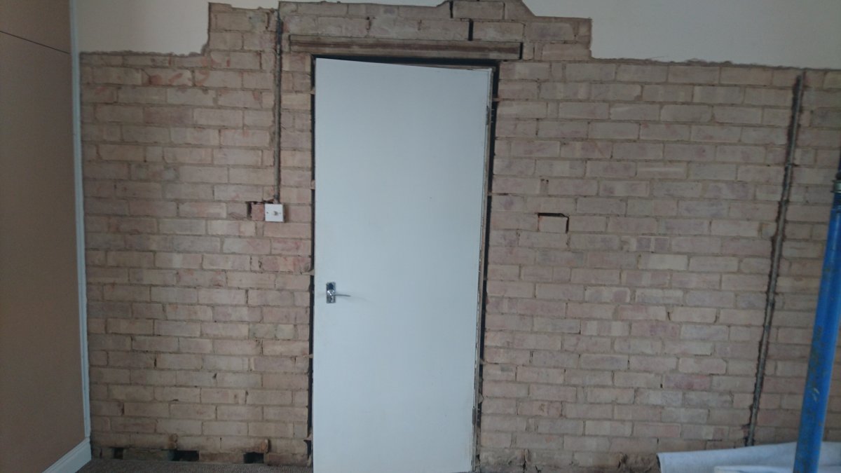

Due to re-ocurring small cracks in a bedroom wall (internal), I have decided to removed the plaster back to brick.
In the line of the cracking the mortar is nearly all missing as well as in other areas of the wall.
So to add some strength into the wall I am thinking of the following process :-
1. Raking out all the brickwork mortar joints (40mm depth)
2. PVA the wall
3. Fix 12mm battens (vertical)
4. Sand + cement (4 in 1) for a single float coat 12mm
5. Skim wall at later date.

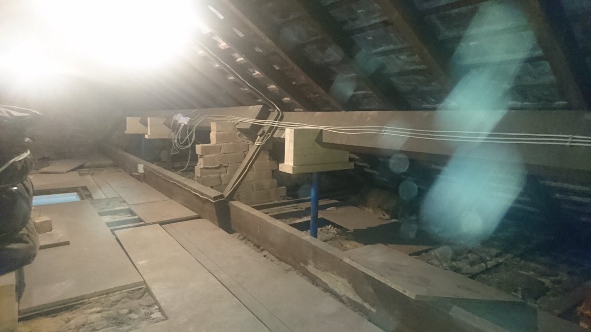

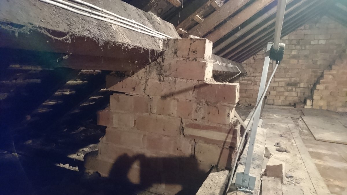

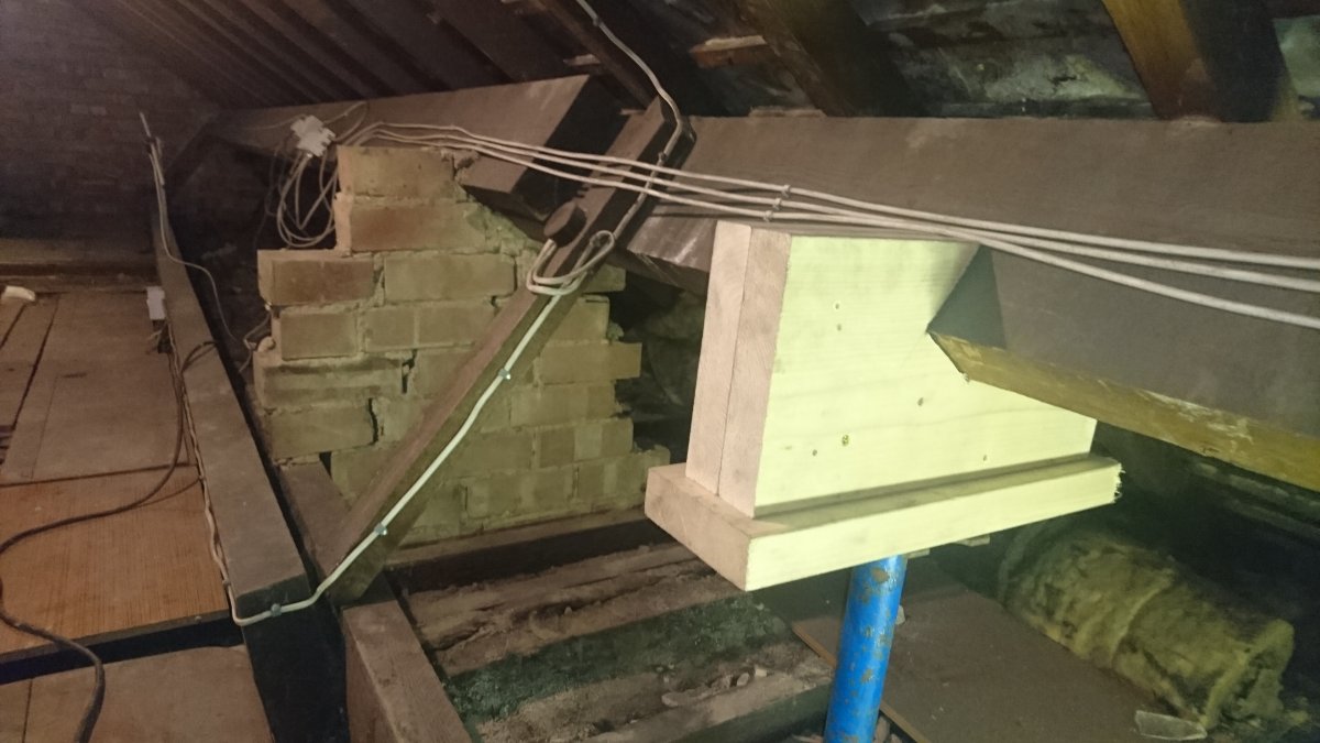

A roof purlin is sitting on that internal brickwall (in the loft space, 6 courses into a pyramid).
This small number of bricks has moved.

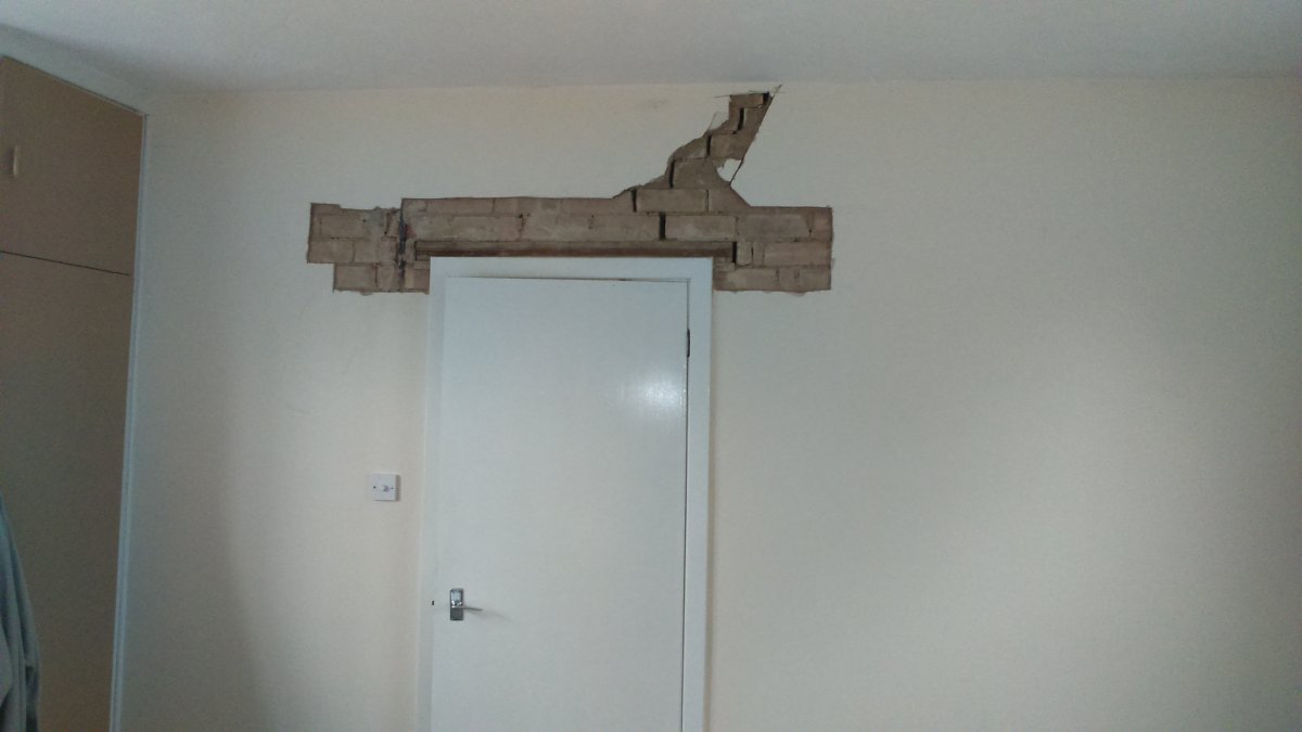

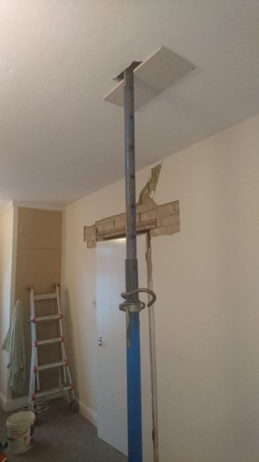

Knowing this I wanted to check-out the small crack in the plaster above the door opening in the bedroom below.
Once exposed, the brickwork above the door hadn't actually moved, it was just completely missing its mortar in 45degree (5courses) running down the timber lintel, (which also hadn't moved).
However as the timber lintel did have a split going length-ways, I have since replaced it with a concrete lintel.

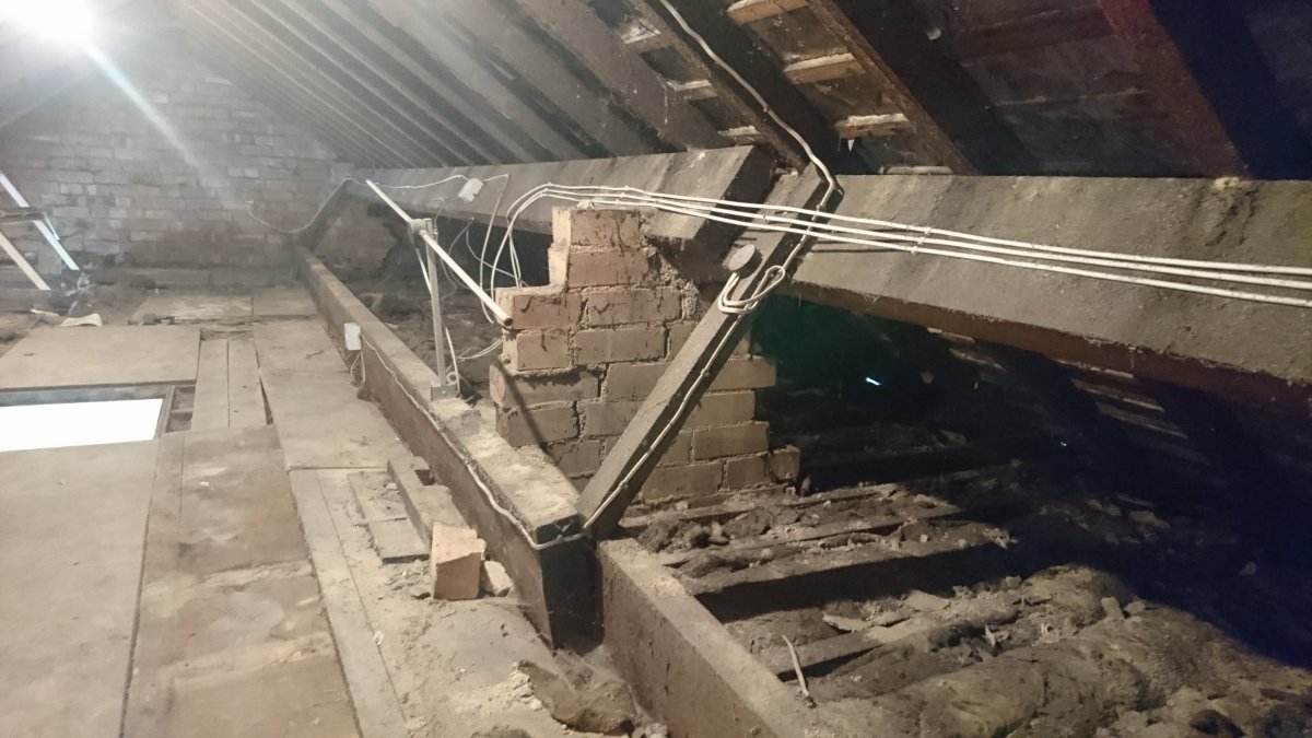

In the loft-space I will remove the small number of bricks, then :-
1. first lay a concrete lintel (1500mm) to spread any load so that the door opening is not a weak point.
2. rebrick the small number of bricks to catch the purlin.

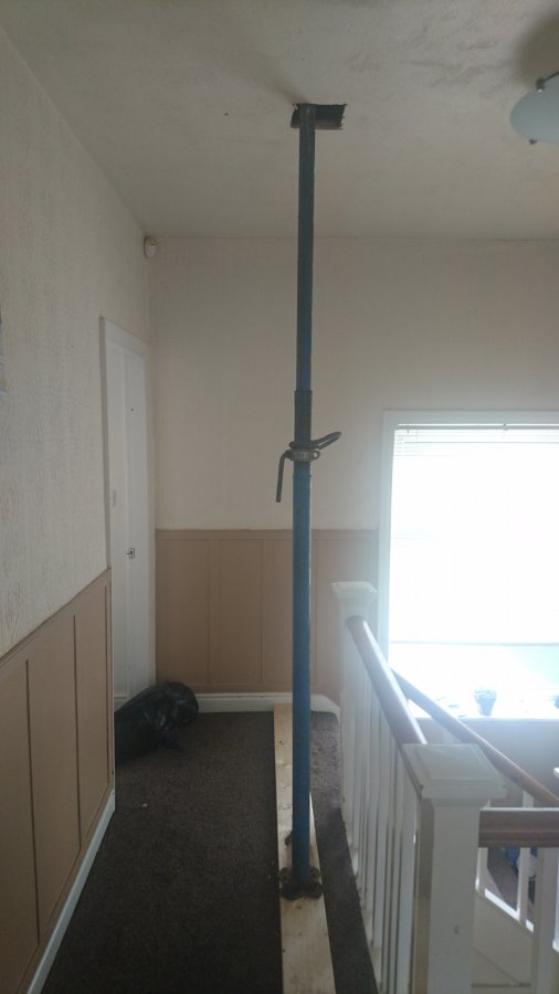

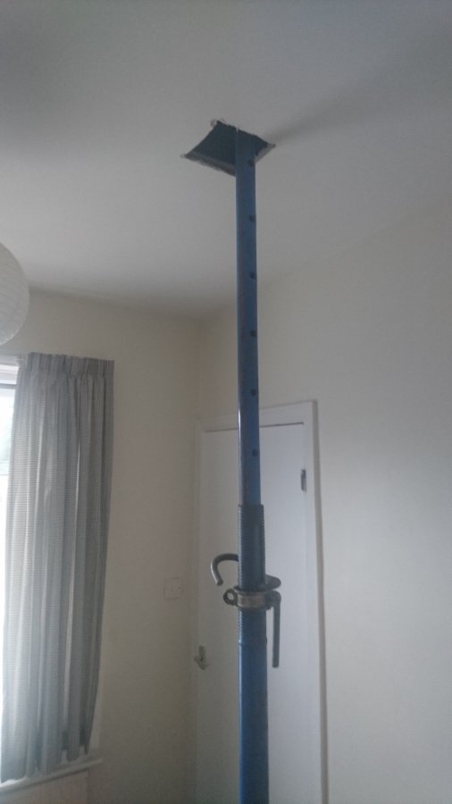

Info : Acros already in place supporting the purlin.
To do the rebuilding/reinforcing work in the loft, I just wanted to make sure that the wall below it (in the bedroom), was as strong as I could make it, hence the rendering.
Other than the crack in the loft and the missing mortar above the door, there are no other cracks/damage in any walls internally or externally.

I have uploaded some photos. Grateful for all help, advice and suggestions.
What appears to be happening is the roof plane is pushing the purlin(s) sideways which is transmitting to the wall below.
The doorway doesn't seem to be distorted so no need to change the lintel.
Neither is there any need to rake out and render the wall. Simply point up where necessary.
Use EML across the cracks.
You could firm up the wall with a rake-out and render but I dont think thats needed.
In the loft you could re-build the existing purlin support, and extend the supporting brickwork towards the centre of the house using EML in each course bed. Creating a kind of buttress.
There are two difficulties with this approach:
1 - the binder beam has also been moved presumably by the same diagonal pressure, and is now slightly tilted.
2 - how to support the purlin(s) while doing the work.
What about the purlin on the other roof plane?
Given that your roof cover lacks an under felt and was originally torched, it might be best to consider doing the work when doing a re-roof?
I hesitate to give further long range advice where such structural issues might be involved - why not call a builder in for a site opinion?
Unfortunately in my haste, I have already raked it out. What a mess that created. I won't be repeating that task in a hurry.
I now see that your idea to use EML and render was very sensible and the right option.

2 - how to support the pulin(s) while doing the work.
Once the disturbed brickwork has been removed, I am planning to lay a 1500mm concrete on top of the bedroom wall (butted up to the tilted binder), to help spread the diagonal/downwards force.
I will then brick-up on top of the lintel to catch the purlin using Class B engineerings.
I was also thinking of installing some re-bar (vertically) within the engineering brick support to prevent any future lateral movement.

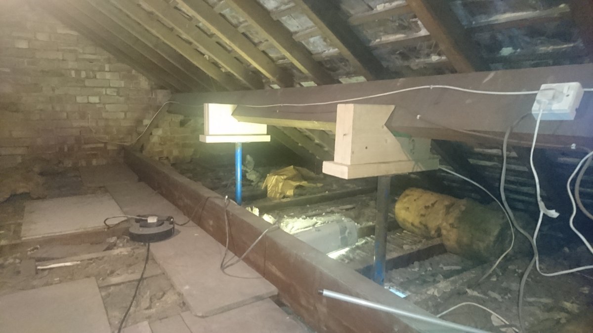

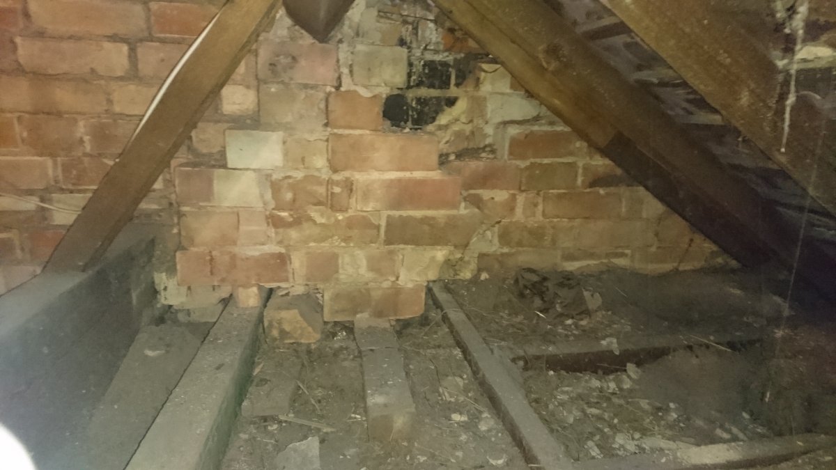

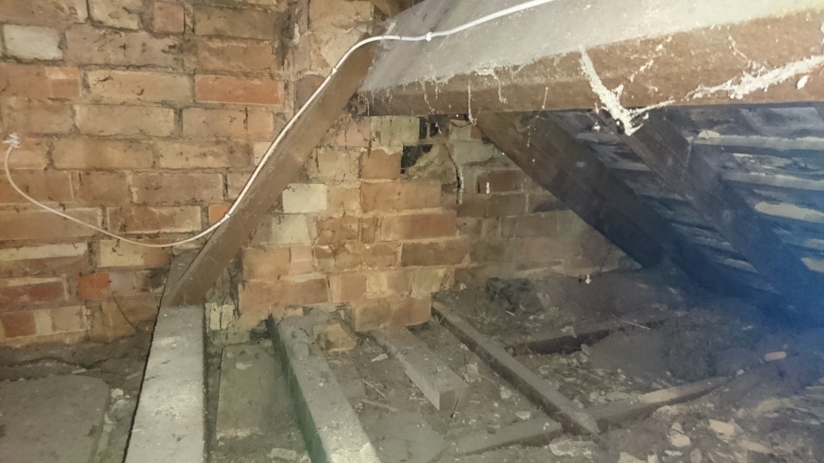

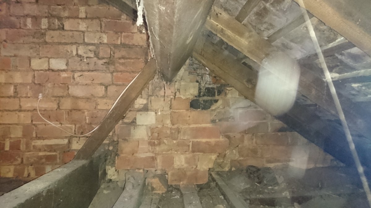

Left Purlin (photo 2, #6), I am guessing that the span of is over 5m, which I think is quite some distance without any midway-support. Also the brickwork that this end of the purlin is sitting on is only butted up to the external wall and NOT keyed-in and appears to be precariously sitting on only
2 x ceiling joists, (see below).
As there is no solid wall running up into the loft (apart from the disturbed brickwork), I am thinking of installing a 152x89x16UB 3.5m (length) from central wall to the rear external wall and then bricking-up to create the purlin midway support. To this I will have to notch the underside of the binder beam to run the UB across.
I do always take the belts and the braces approach.
Overkill or reasonable. What are your thoughts ?
