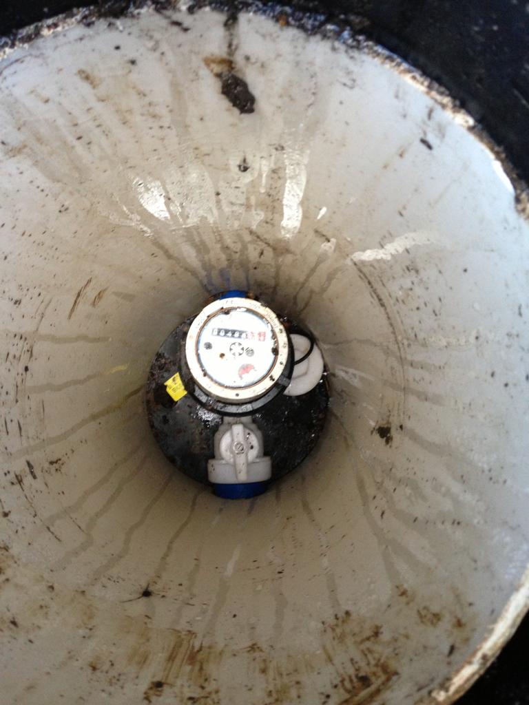

This is my meter contained in a boundary box. The pipe run would be approximately 12 to 15m.
How on earth would anyone even with a moling machine connect to the other side of this without disturbing the pavement.

So the bit I dont get, is I dont know what old size lead pipe is connected in the side meter chamber to them come under my boundary and then all the way into my home. I bought the house a few years ago and whilst we have good pressure, we want to renew the mains.
It would be pointless connecting 32mm blue pipe to 0.5m of my existing 15mm lead pipe (if it is that - I'm guessing and have no idea) inside of my boundary wall just because I cannot touch or connect to the mains stopcock. I will continue to suffer pressure loss of 15mm coming into 32mm.

That's a good point. I called them after you msg. Speaking to developer services they said that I'm not allowed to connect my new pipe into the chamber box stopcock and that if I wanted 32mm pipe or more it will cost £150 odd for an application fee and the cost of changing it will be between £1k and £4k. If however, I wanted to avail the lead pipe replacement service I had to call another number in Operations. When I spoke to them they said the developer services dept was incorrect and that I CAN connect my new pipe into the chamber box stop tap. I have asked them to put that in writing to me which they have done. He clarified that I can have 32mm pipe on my side of the boundary but that they will only put 25mm for the communication pipe (service pipe?) unless I pay to upgrade.
Water pressure from 25mm to 38mm with the slight bottleneck will I presume, still be better than 25mm throughout? Also, looking at that picture, how easy will it be to put an adapter on that to go from 25mm to 32mm?
I don't understand fluid dynamics but I believe yes. 25-32 is simple with a philmac adapter or similar.
