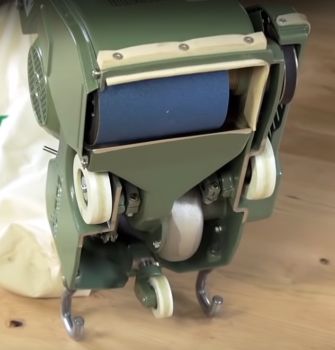

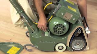

OK, I'm a joiner, so power tool usage is a normal part of my occupation and I should have been more specific. TBH I haven't had too many problems with belt sanders like this Hummel (side view with belt exposed and underside view showing thwo wheels and rear caster:

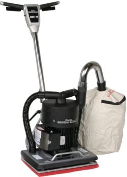

I agree that the old style drum sander can be a nightmare and I'd recommend staying well clear of them (trhey give me problems, too). Fortunately I haven't been offered one in a while. There are, however, alternatives such as an orbital floor sander which works like a giant hand sander:

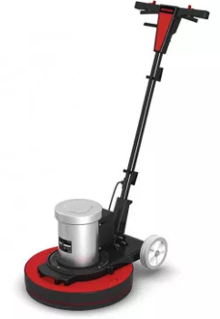

and the rotary orbital floor sander (which have no vacuum so are really dusty):
They are both a lot slower than a floor belt sander.

That seems to have a depth limiter.
So, differently from the one i used, your one won't go deeper than you set it.
I'll give it a try next time i'm sanding a floor.
