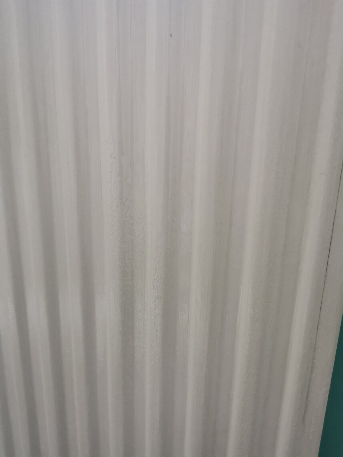

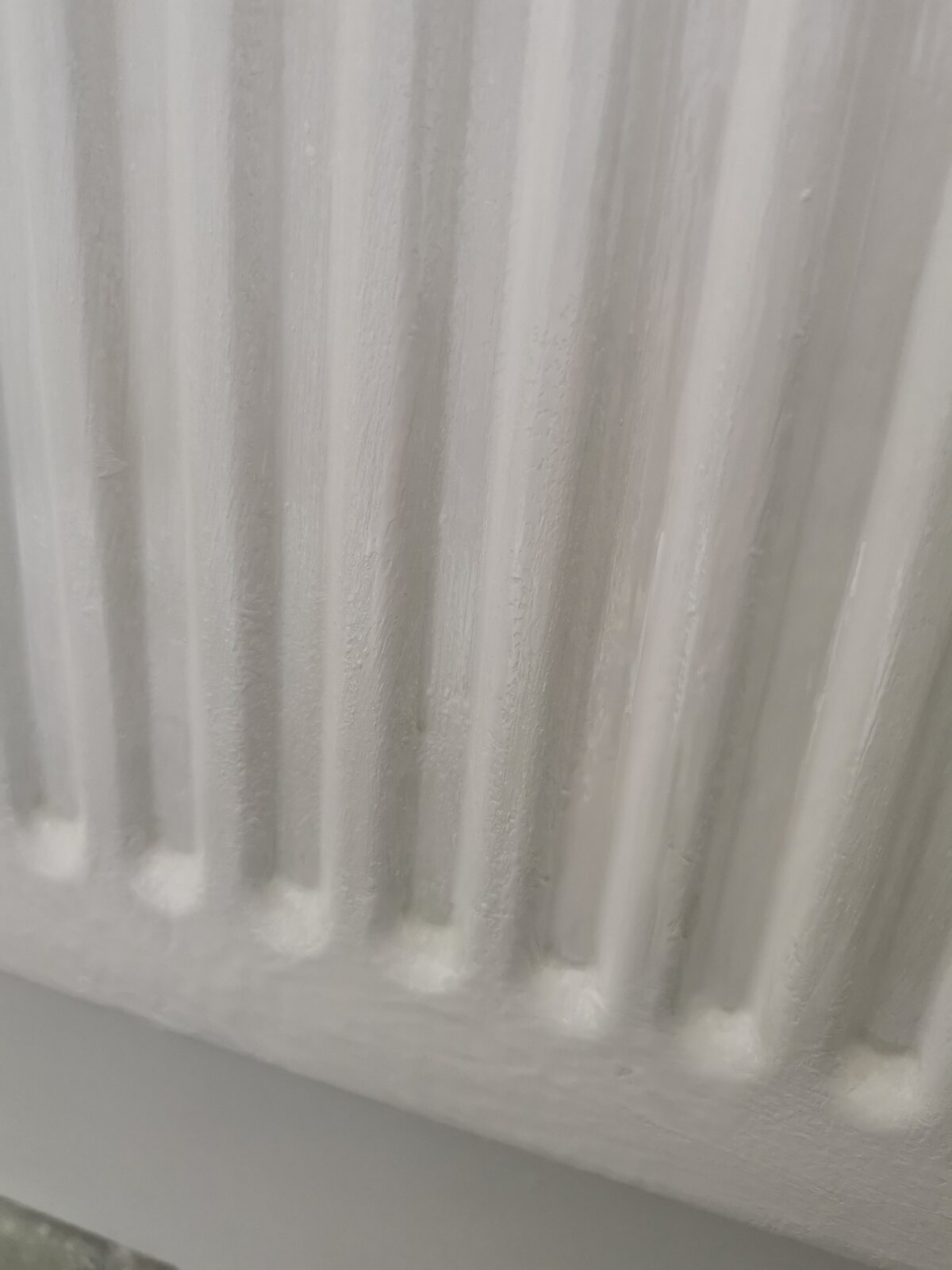

I'm redecorating a room in the house and thought I'd go all out and repaint the radiator too. Can't be that hard can it?
Anyway, I've done 2 coats (second is almost dry) and it looks awful.
I cleaned and lightly sanded the radiator first with 120 sandpaper and am using Hammerite metal paint as recommended by Screwfix.
Judging by the attached photos, is it best to wait, sand down and start again from scratch, or apply a third coat when dry. My gut says the first. Not exactly sure what has gone wrong. Radiator is cold, too.
Thank you

I'm guess that's the issue. I was told by Screwfix that it was fine.
You can buy water based radiator paint which I find very good. I use Ronseal. 750ml is about 15 quid.
I'm not sure what has happened with yours. It looks like the paint has been too thick and dragged all over the place. Or you painted it using a broom!
Edited because after broom I added a winking smiley as it was meant to be a joke!
I'd definitely sand it down and either thin down the paint you have or get some water based radiator paint which is easy to apply.
How long did you leave it between coats? With such paint you sort of have to be very fast as it starts drying as soon as you put it on so when you then slightly go over it it pulls the paint!

Hammerite is the problem.
Virtually any paint would have been acceptable, but that thick gooey stuff is not good for large areas.
You should wait for the paint to harden properly, and I mean properly.
Then sand down to get a nice even surface.
Radiator paint is available, but you could get away with ordinary oil-based undercoat followed by oil-based gloss or satin top coat.
All bare metal should be appropriately primed.
Personally I prefer to use oil-based paints over metal surfaces rather than water-based, but that's just me.
