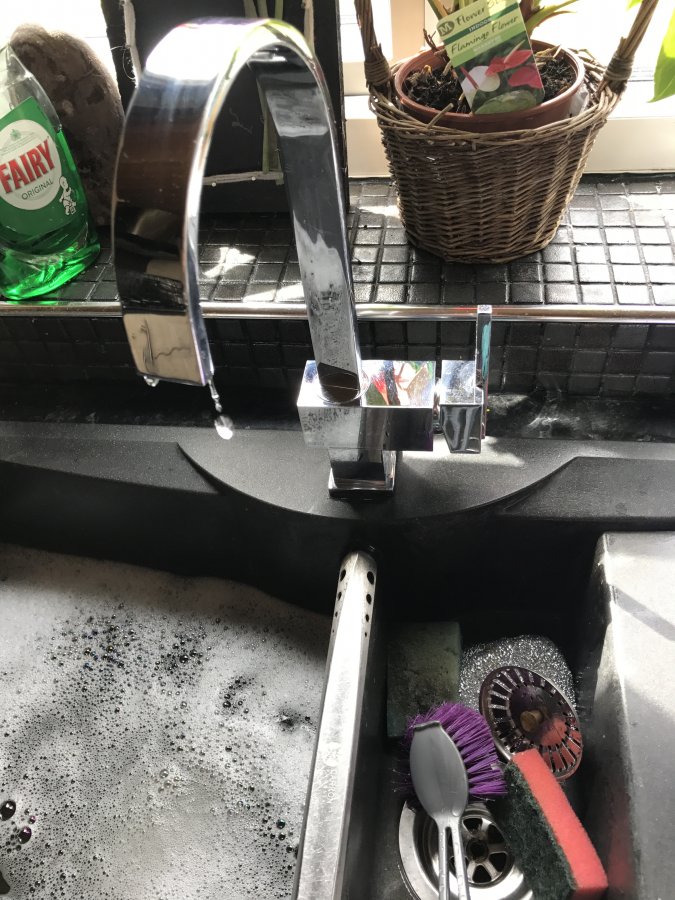

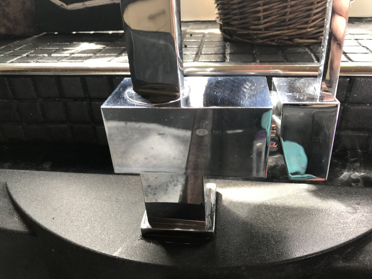

Its been dripping for a while so I'm going to start thinking of fixing it.
It's about 10years old, you pull the lever right to turn it on and forwards/backwards for hot and cold.
Does anyone have an idea if it could be fixed and what kind of washers or inserts it would have inside it?

It'll be a Ceramic Insert/Cartridge/Cassette, likely to be specific to the tap, so you'll have to identify the make/model.
You may have to look very hard to see how to dismantle the tap. Often a small Allen key/grub screw is involved.
If you remove the cartridge and photograph it, you may be able to match it at Lunns or one of a number of other taps parts suppliers.
You can send them (all) the image and see what they say.
It's often a lot easier than replacing the tap, depending how your sink was put in, even if not cheaper.
Sometimes you'll just draw a blank, especially for taps which were originally cheap/unknown.

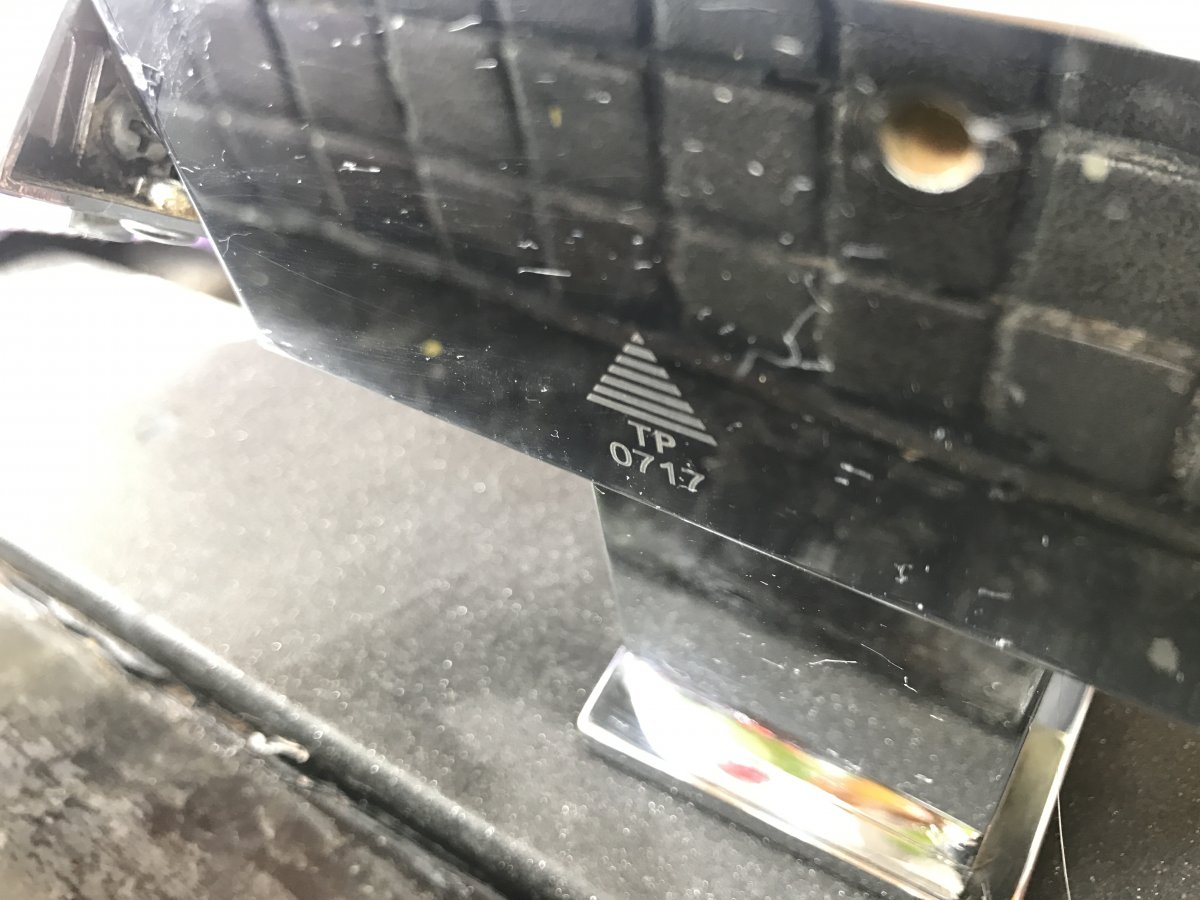

There is a mark and a number on the back of the tap:

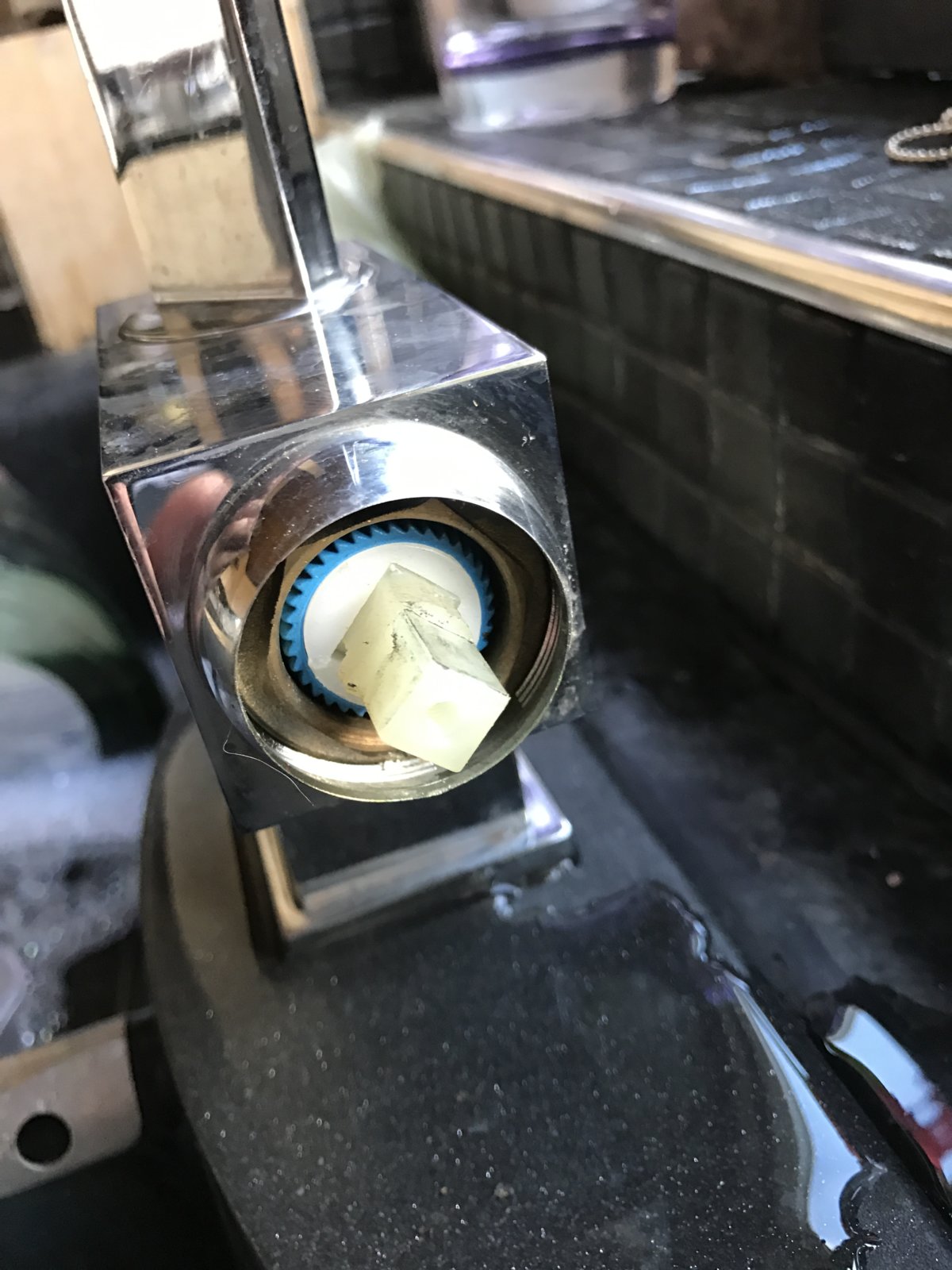

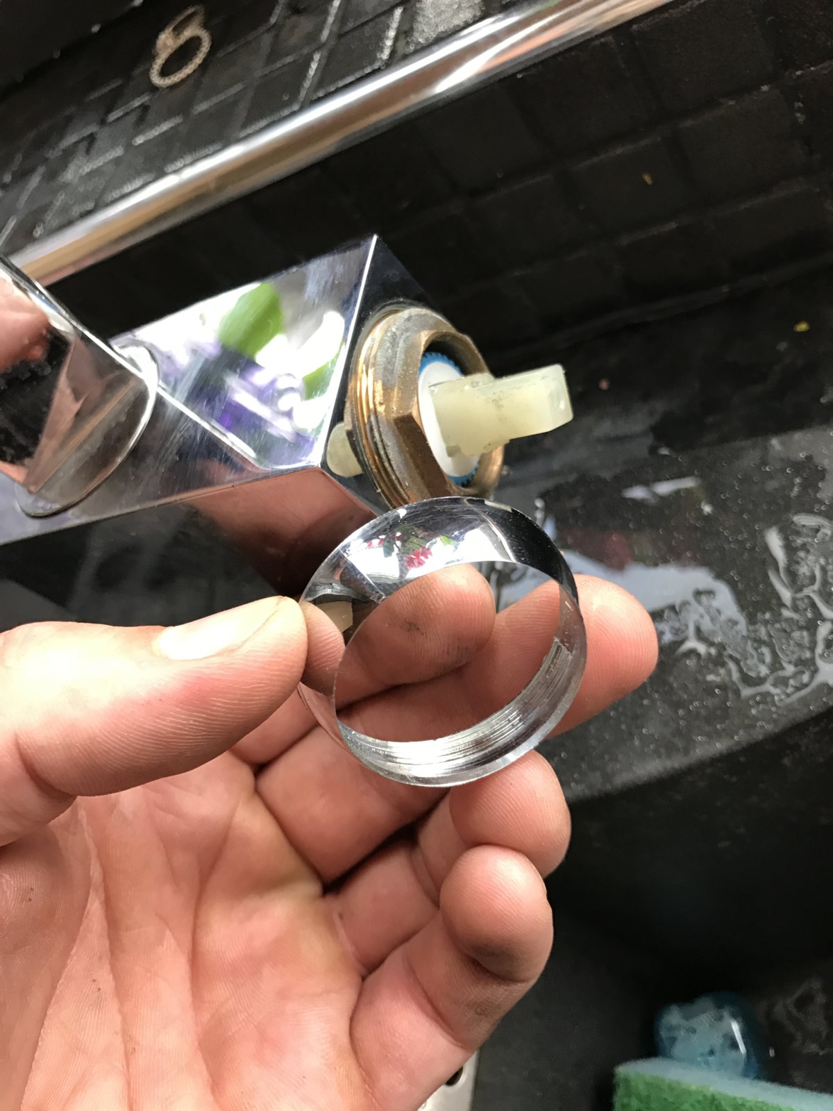

Any idea what size this nut is:
My biggest socket is 24mm and it's too small so I'm going to go and visit my Dad and steal something a bit bigger.
My bathroom basin tap was similar to that - just orientated differently. On mine, the chrome/plastic dome unscrewed and I was able to get a pair of water pump pliers on the cap that held the cartridge down. Your chrome dome seems to have an internal thread so it looks like the dome will unscrew.
I think you might be right although from here it looks like he done is part of the tap. It could just be years of crap making it look like that and it does feel plastic.
There's no way that nut will come off with the dome still on.
