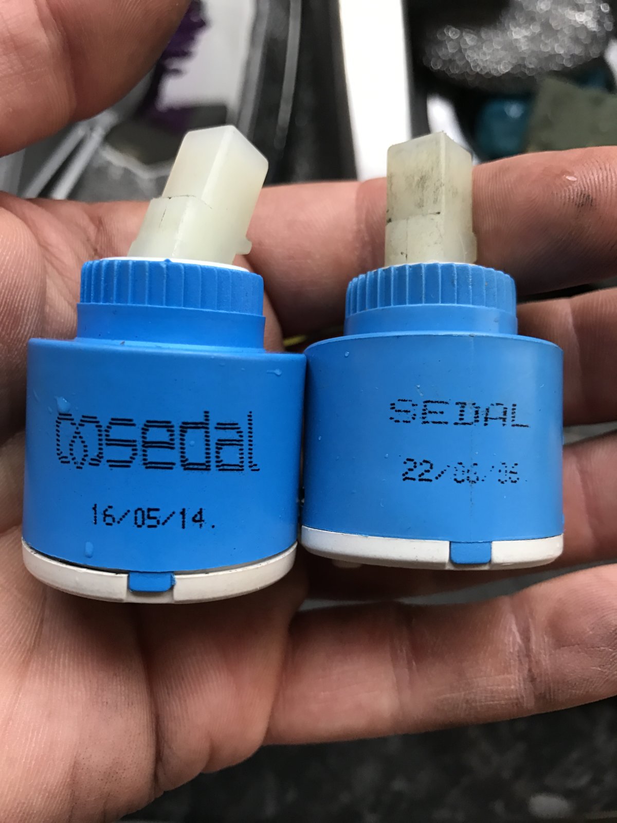

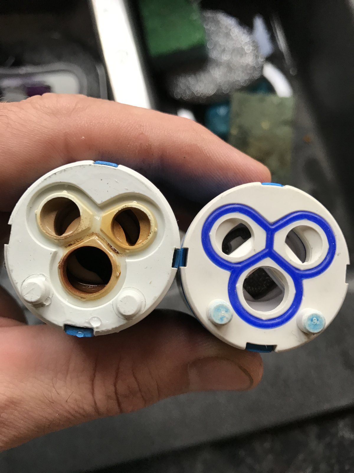

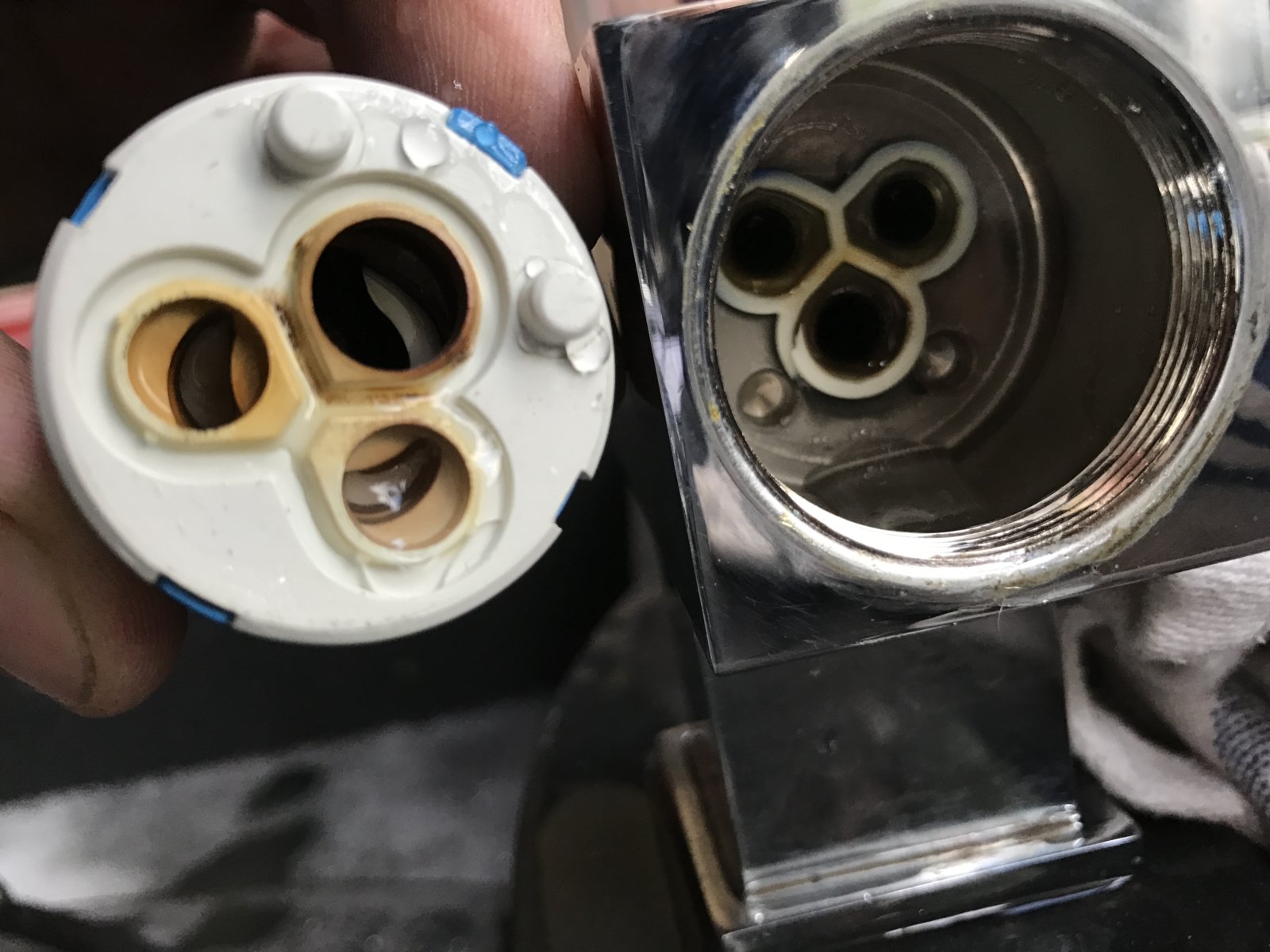

Repair or replace this tap?

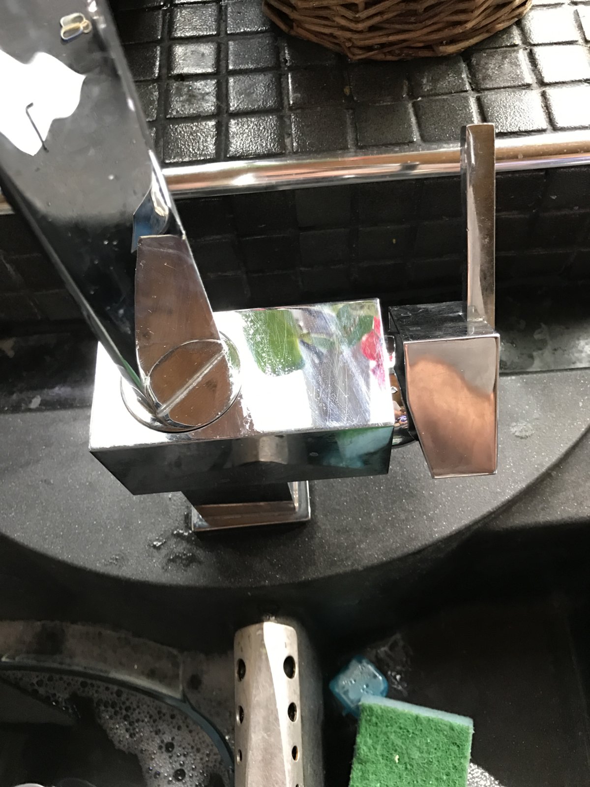

All done. Took a year to order the part and 10 minutes to swap it.
The silver cone came off by hand and I found a 27mm socket on another set which fitted the nut.
Thanks very much, I might get a treat tonight ;)
No more drips :)
Well done next time, pour very hot water over the plastic ring. It expands so is much easier to undo :)
