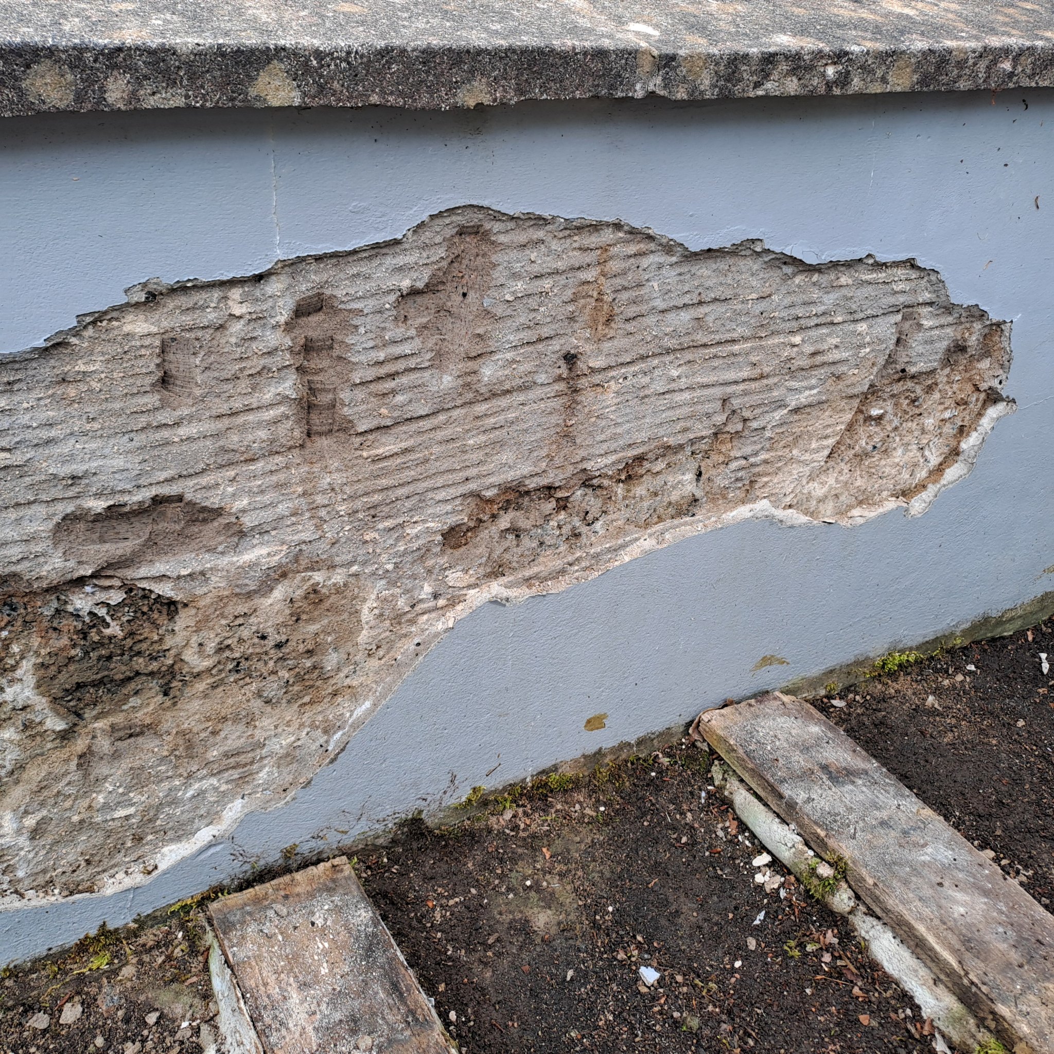

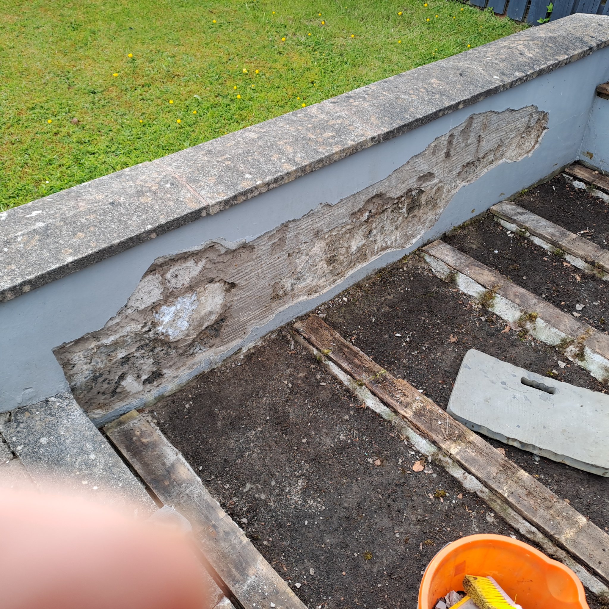

Hello,
I’d appreciate some advice on repairing render on a garden wall.
I’ve removed most of the loose, hollow-sounding and cracked render, exposing the scratch coat beneath. My original plan was to remove all of the scratch coat and start again from the masonry, but the remaining material is proving extremely difficult to remove, suggesting it is still well bonded.
Given the relatively small area, I’m considering doing the repair myself. My proposed approach is:
Remove any remaining loose or poorly bonded render with chisel, wire brush and finally remove dust with a brush..
Apply a bonding agent (e.g. SBR) to the sound render and exposed masonry.
Fill deeper areas with a sand-and-cement scratch coat, leaving sufficient depth for the finish coat. Allow the scratch coat to cure.
Apply a finish coat and sponge-float to match the surrounding texture.
Does this sound like a sensible approach? In particular, is it acceptable to leave the well-bonded scratch coat in place, or would it be better practice to remove everything back to the masonry before re-rendering?
Any advice on mix ratios, curing times or preparation methods would be much appreciated.

You could just buy Weber one coat base render.
Just add water
Thank you Wayners this helps greatly. I didn't realise there were ready mix bags for the substrate. I will try find the same approach for a smooth topcoat to match existing surrounding wall, to blend and paint..

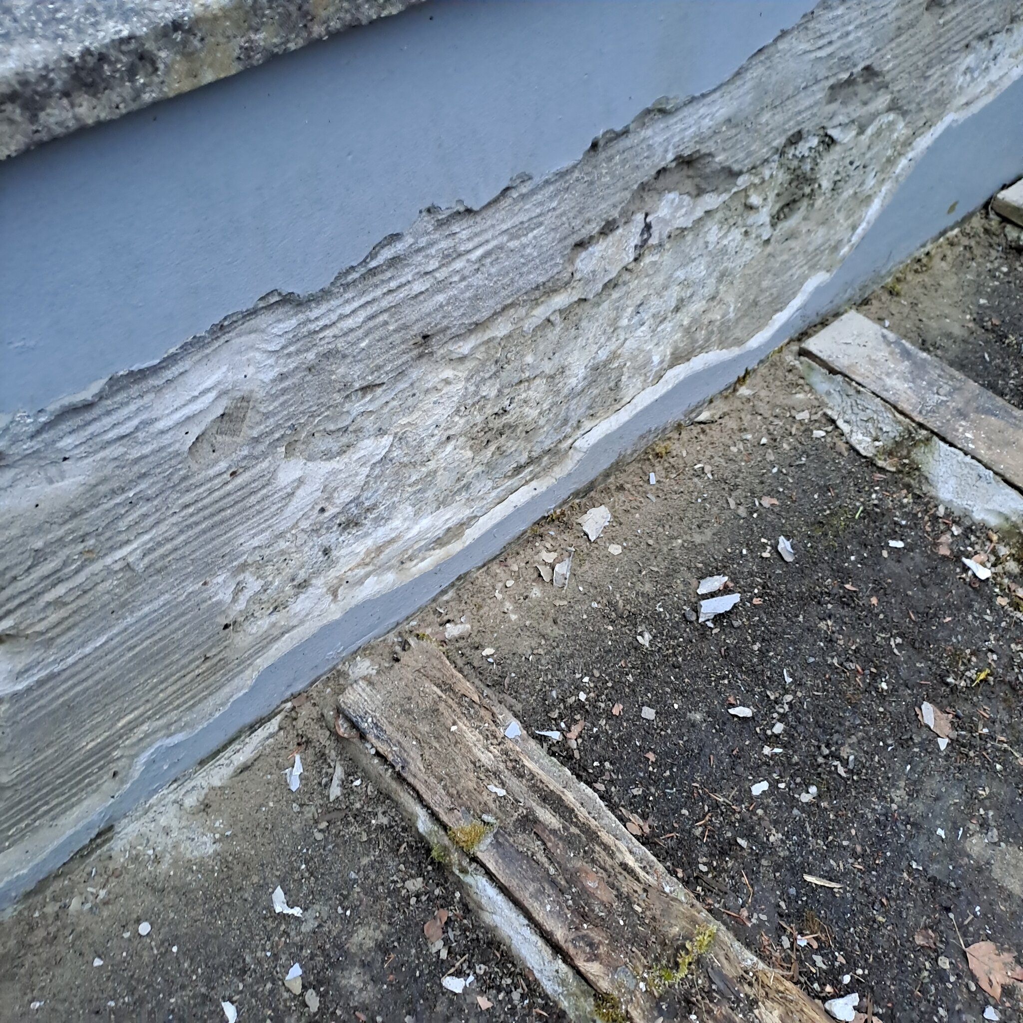

Any opinions welcome. Two questions.
1. On first image with 4cm high render left at base of wall, feeling firm but appears slightly detached, is it permissible to pour SBR into crack and render from there?

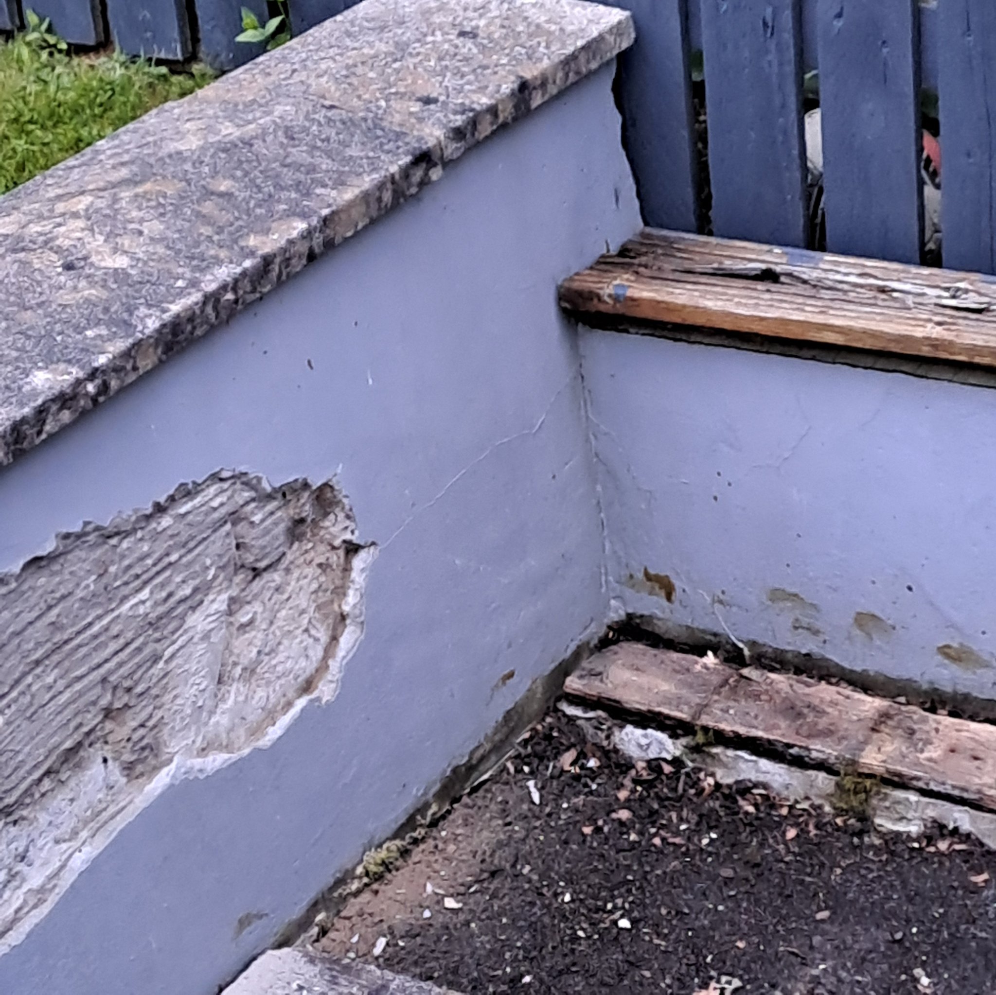

2. On next image, remaining render all feels solid, not hollow, and difficult to remove.. Is it permissible to ignore the crack on this garden wall?
Many thanks.
Everything loose otherwise removed..
