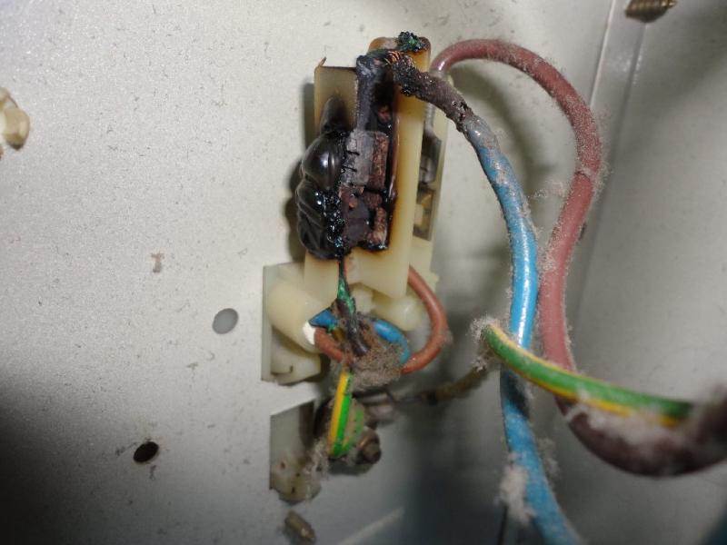

We have a Zanussi TD100 Tumble Dryer which today stopped working in mid-run.
I have checked that there is power to the socket, and the 13A fuse has not blown. What I would like is a (constructive) steer towards the next step(s).
I have searched on this site & others, and have not found any advice or service manuals for this model; (I'm not surprised about the manuals, as we bought the dryer in 1986.) Some years back I replaced the drum bearings, and I see that some spare parts are still available.
The TD100 is a simple model with one control - a rotary knob to set the time, which unwinds to zero (and cuts the heat 10 minutes before the end.) It suits us, given the limited use we make of it, and we don't want to scrap it if we don't have to.
It sure has done its job well...!

I'm pleased to say that the dryer is up and running again (for the while at least.)

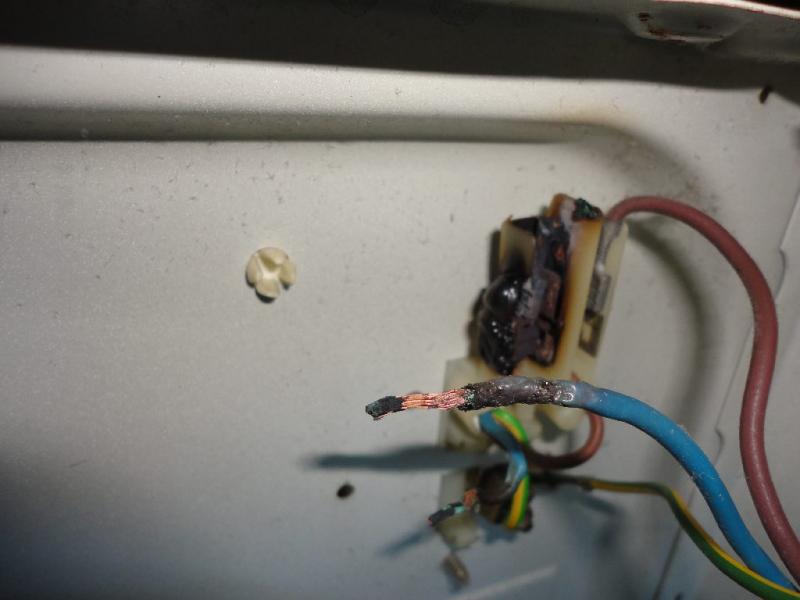

Encouraged by the helpful replies suggesting that it was worth having a go, I opened up the lid and found the problem - a burnt-out Neutral wire and connector block at the connection between the supply cable and the internal wiring.
I presume that over time and vibration, some of the cable strands had broken, and the rest had overheated until the electrical connection broke.
I have cut away the melted cable ends (and a bit more) and joined them with crimped spade connectors - and it appears to be going OK. I appreciate that it is unlikely to keep going for another 25 years - but then nor am I.
