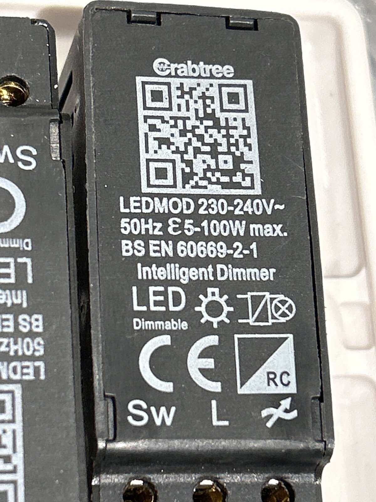

I have a 2 gang 2 way light switch controlling 2 lights from either side of the room. This has the usual Commin L1 and L2 ports.
I have a 2 gang 2 way led dimmer which has ports Sw L and x - I say x because it’s like an arrow with a wave through it.
Wondering how I can swap the switches over?

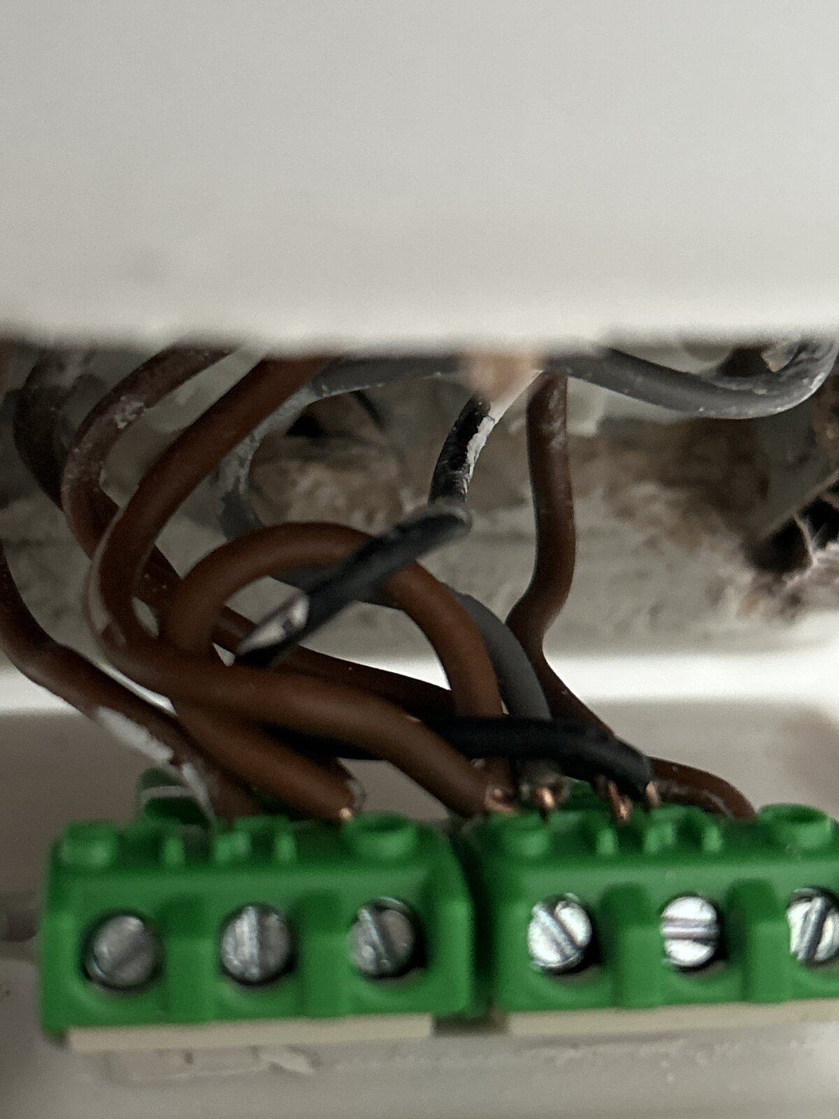

It will depend on how the circuit is wired. Were there no instructions with the switches?
Post a picture of the wiring. Just copy and paste.
Do you mean you have TWO 2 gang 2 way led dimmerS?
Hi no just want to have 1 x led dimmer 2 gang 2 way and leave the other normal 2 way switch
Will send a photo of wiring shortly …
Try this...
Dimmer to switch.
~.......com
L.........L1
SW.......L2
Make sure you know how to put it back how it was incase it doesnt work, should do though.
