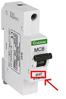

I have a electric oven allready in place pluged in to a 13 amp socket leading to a cooker switch above worktop on its own circuit with its own mcb in the cu. How do i go about connecting a ceramic hob to my existing setup thanks for the mutch needed help. (ps not shure what amp
the mcb is how do i tell?. It has a32 on the mcb if that helps)

To find the MCB rating look here:
It's quite likely you're going to need to either upgrade the cable and MCB or to install a separate supply for the hob.

thanks for the replys guys so is it likely my b32 fuse is a 32 amp how do i find out what amps the cabe is i had a look and all i can say is that the cable is thick thicker than normal lighting and socket cable. (sorry explained the best i can)
