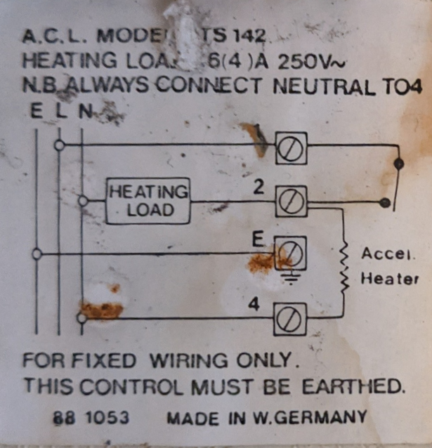

Ok ive had to borrow a few pictures!
Here is the exact wiring set up i have (so no earth connection) - i was told that the Danfoss RET2000MD would be an ok swap for this - also attached the wiring diagram
screenshot_20200505-191348-2-png.191384
screenshot_20200505-191343-2-png.191385
The attached RET2000M wiring diagram is the same as the the RET2000MD
NOTE: for RET2000MD live supply is from the time control output (which is mentioned just under the diagram)
So has the chap that gave me these got it wrong?
Does this new one need a 230v supply in which case this isnt going to work is it? or could i link 1 to L?
and 2 (old) to 2(new)???

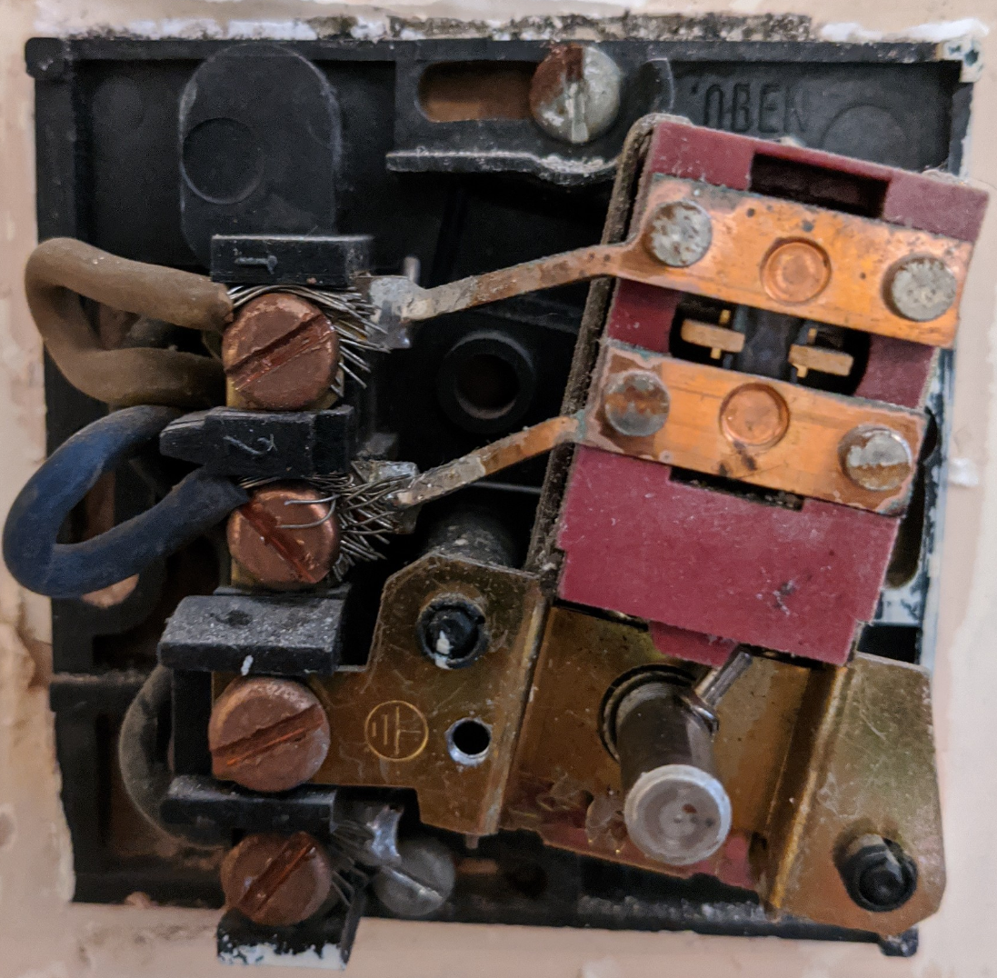

1 currently is live call from the Timer...
2 is a switched live
4 neutral on my TS142
thanks in advance
