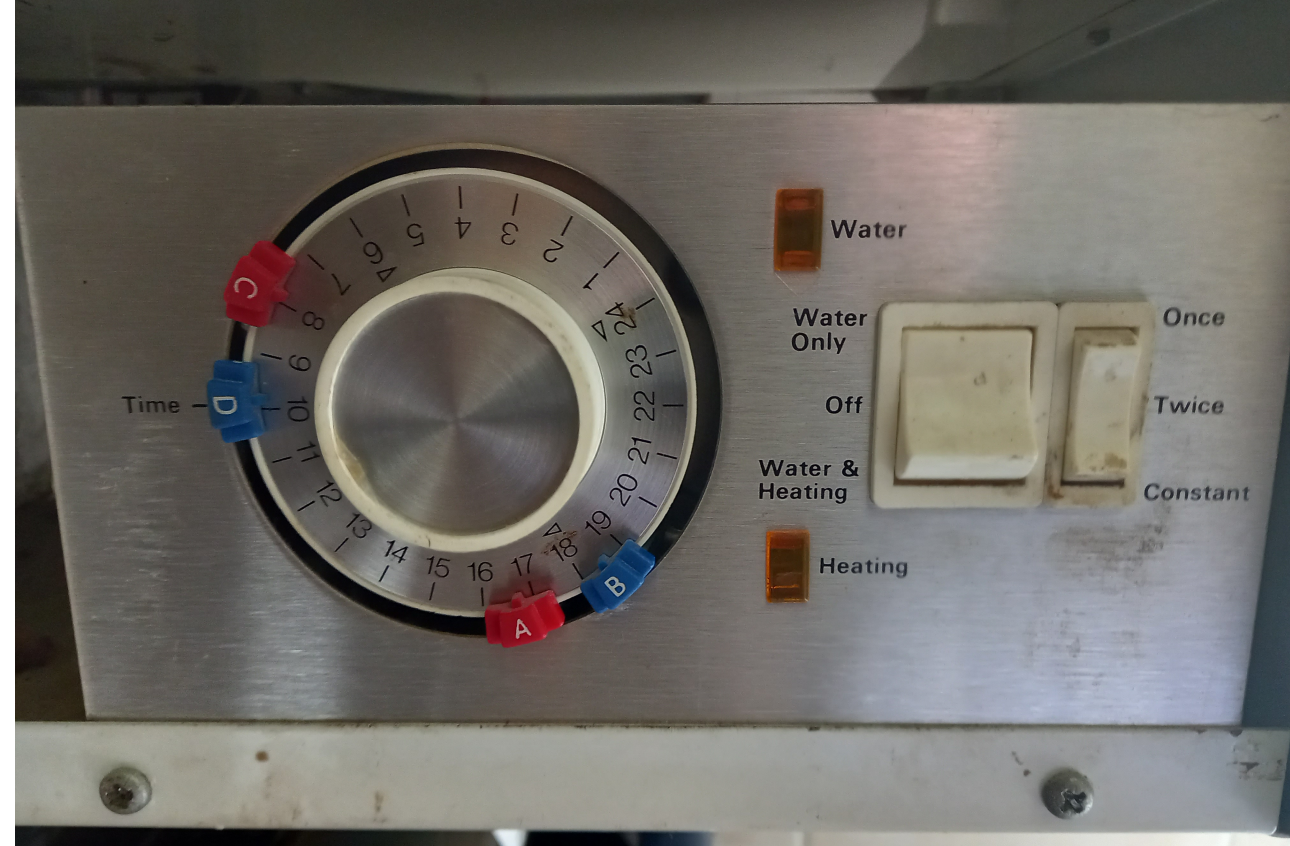

Hi all,
Looking for some advice please?

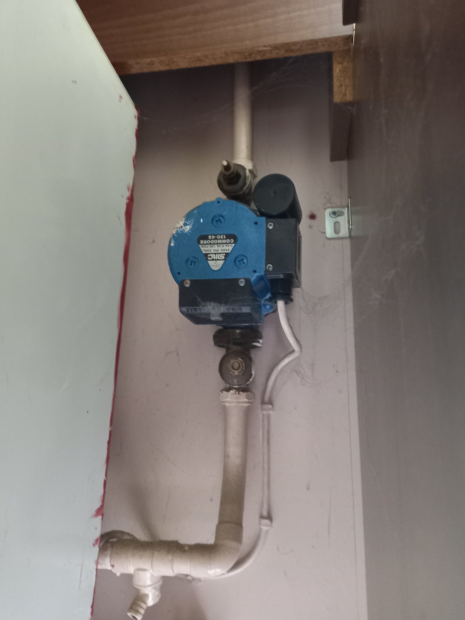

I have an old Ideal Concord WRS boiler circa 1979. Not sure if is a 230A/240A/255A. I am also not sure if it is gravity fed or fully pumped. There is a small pump to the right of the boiler

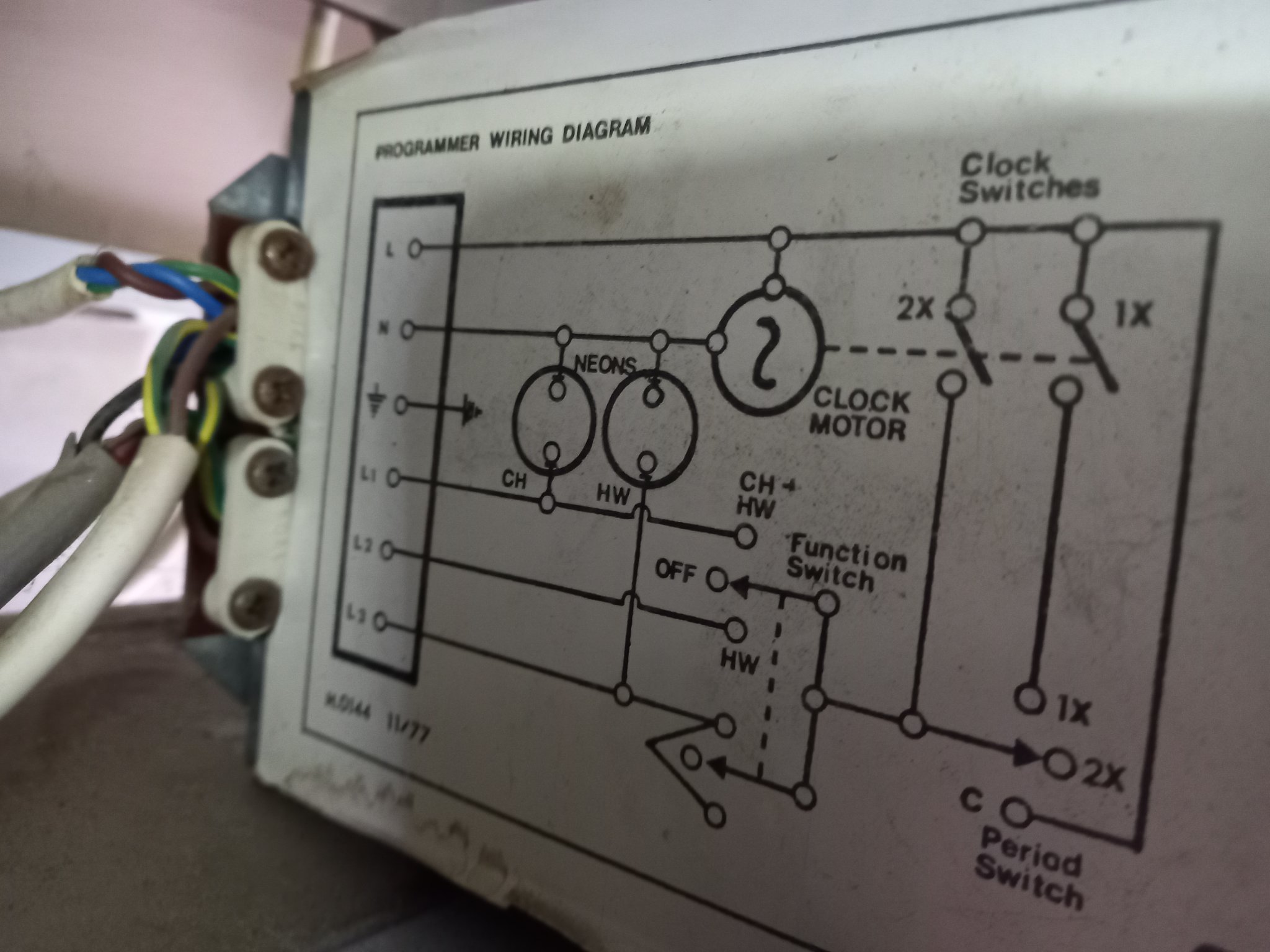

It has the programmer in the attached picture. Google Lens showed this as a Landis & Gyr RWB2, but looking for that on the net I see very different interfaces?
In looking for a replacment I found the Siemens RWB29SI?
In several threads on here, it is mentioned that the backplate is the same and that it is a straight swap. Siemens themselves state that. However in mine all the wires appear to go in vertically to the right side of the unit as you look at it's face.
Now I am not sure mine is indeed an RWB2, how hard would it be to replace this old timer please.
I do not intend to do it myself more than likely, but have a friend who could fashion some sort of mounting plate for the new programmer, then get an electrician in.
The current one is bolted to the boiler front panel with two screws.

Edit: I now believe it to be gravity fed, as I do not have any controlled valves around the hot water tank.

I doubt that's a universal backplate being part of the boiler. It would probably be better a new one and new/altered wiring at the boiler.
I note either central heating and hot water or only hot water, which points to a C Plan. There is no option for central heating only.
No, it is not. Researching more, they are talking about a small backplate, nothing like what I have.
I am thinking of a control box mounted somewhere and the backplate fitted to that.
I have just bought the Siemens RWB29si as a start.
With all of this, do I need an Electician or a Gas Engineer?

So easy bit first, L to L and N to N.
L1 to 4
L3 to 3
But then it gets a bit harder, the existing timer has the option to change what it does. They were sold as 10/16 programmable controllers, and they counted off as an option, but the internal switches changed it from 10 to 16, and it depended on if the system allowed central heating without DHW, many did not.

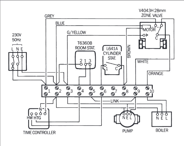

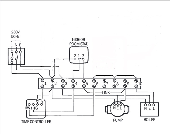

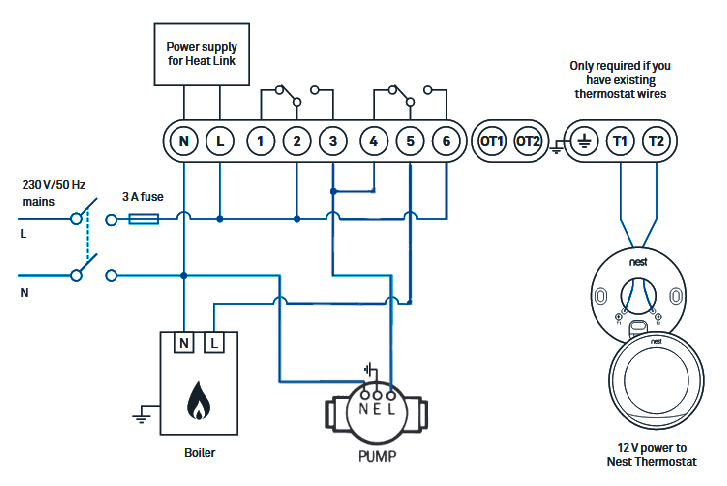

The old controller for C Plan is now hard to find, I used Nest C-Plan_basic_Nest.jpgthe plan is not given in the standard instructions, but it can be done as the Com is not linked to the line in, but with the controller you have selected it is linked.

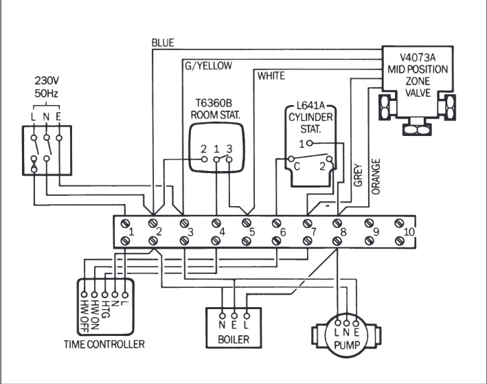

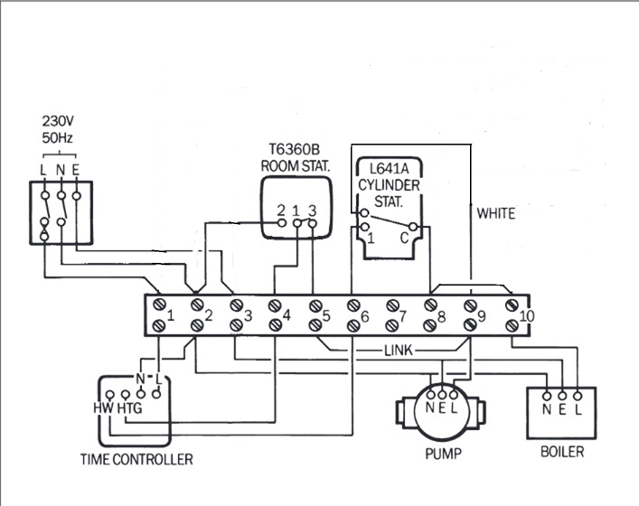

Hive allows an internal configuration but the C plan came with three variations C-Plan_old2.jpgC-Plan_old.jpgC-Plan.jpg The simple one does not allow any temperature control of DHW it is same temperature as the central heating water, and in summer one had to take a guess as to how long it needs to run for, I found around ½ hour a day was about right. The second allows you to use a tank thermostat in the summer, winter it is same as central heating water, but summer you can control DHW temperture, and third not often found, you can control DHW temperture summer and winter.
The point was, the thermosyphon allows the boiler to cool by heating the DHW with the motorised valve that was no longer true. So we got the Y Plan with three port valve, which did allow the boiler to cool by heating the DHW.

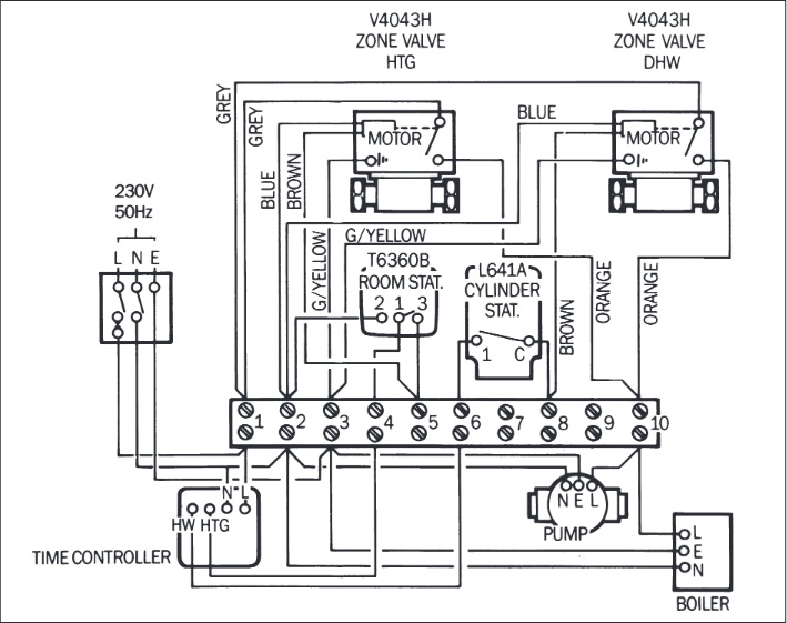

Y-Plan.jpg This does have a few anomalies but does seem to work in general better, but as boilers improved we went to the S Plan S-Plan.jpg job one is to work out which plan yours is working on. The C and Y Plans are not used much today, only old oil boilers tend to use them, oil boilers last longer. But to find someone here in Wales, easy, but across the border into England to find someone who knows the old system is harder.

My existing system allows Water Only, Off and Water and Heating. I cannot have Heating without Water and I am fine with that.
I believe I must be on the C plan, as I cannot find any motorised valves near my hot water tank. I would certainly be on the cheapest option, having known the builder.

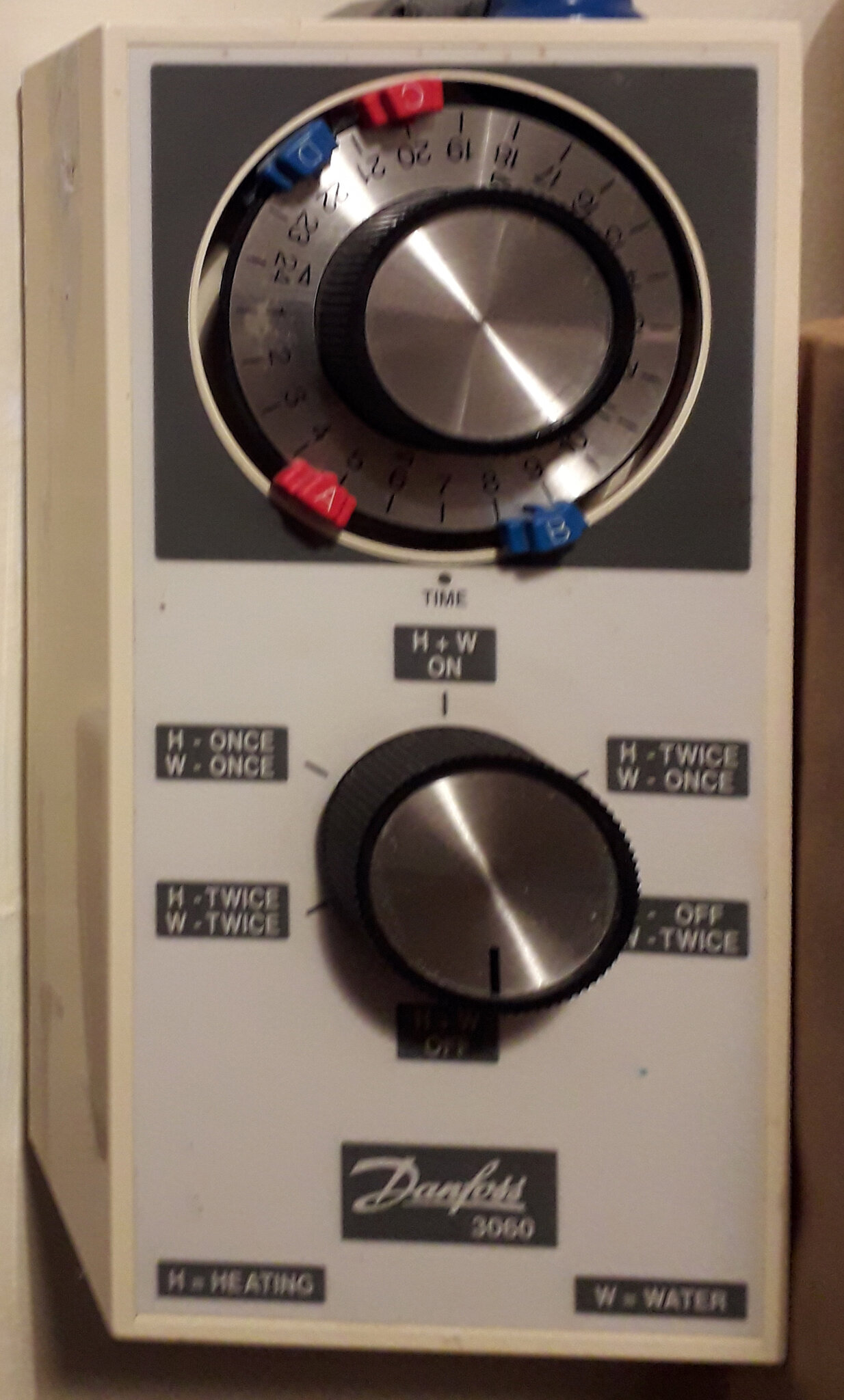

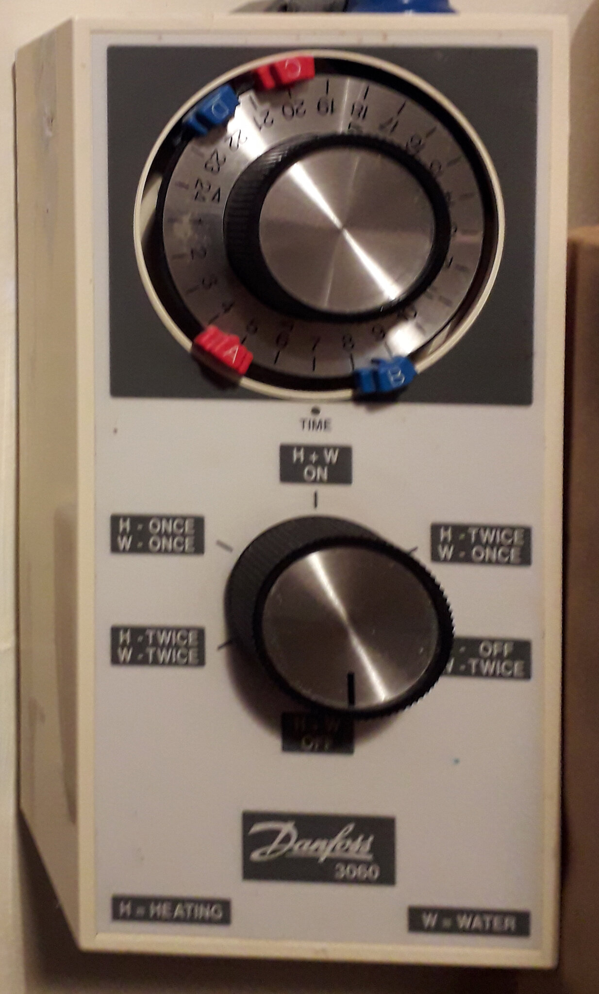

I had the same, Danfoss3060programmer.jpg swapped it for Nest at ½ hour per day seemed too much, at ½ hour 4 days of the week warm water not hot, the boiler is 20 kW so at ½ hour per day it only actually runs for 20 minutes, as return water too hot, so that's 186 kWh per lunar month. My solar diverter (iboost+) measured how much electric used per month, at 34.64 kWh for 28 days. So it uses just over 5 times as much, and I pay 8.625p/kWh overnight, and loose 12p/kWh if I use it during the day in lost revenue from the solar, so for me no question cheaper to use electric. But at 24p/kWh for electric, gas would need to cost less than 5p/kWh to break even, seems unlikely it will be that cheap.
Running the boiler for a whole hour per day, an immersion heater will be cheaper.

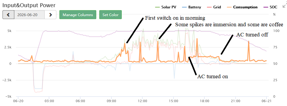

Today very different, AC been on most of the day, I looked at use, and 3432 watts, tried to work out what, 755 watts for the AC, but due to AC, DHW heating came on late, it uses excess solar, so started to heat it at 11:26, and just finished at 12:12 but a 3 kW, that's just 2.3 kWh and likely less, as my controller can vary the power used for water heating, so it only uses excess.
Now exporting 2.7 kW and using 1.166 kW days like today glad I have solar panels and can use the AC when ever I want.
