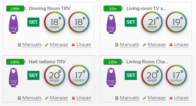

I quickly realised my error, and went to set the TRV, so want the room at around 21ºC to 22ºC and I look at the TRV head, and it says *123456, who in their right mind, labels a thermostat *123456?
Well it seems the TRV at setting 2.5 will be fully open at 17ºC and fully closed at 21ºC so 5ºC between fully open and fully closed, so to have a room at 20ºC it will depend on outside temperature, radiator size, room size and the setting of the lock shield valve, as to what number it needs setting at.
Even with an electronic TRV head, it may mean fully open and fully closed only has a 0.5ºC variation, but to exercise the valve, which happens every Saturday at noon, we hear the motor running for 5 minutes, that how slow the valve is, so with no lock shield valve, the radiator would be stinking hot before the valve can close, so we need to set the lock shield valve.

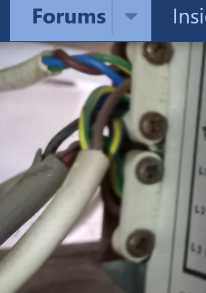

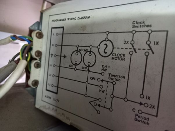

I have looked a little bit further, by taking the cover off the old programmer and can see that no wires go to L2 as far as coming into the programmer. That was the line that I had to isolate and shield, if one did.
I am trying to see if I can remove the plate where all the connectors are to get a clearer picture of the wiring.

Well I have been upfront with a few electricians about what I have and what I want, and none want to touch it. :unsure:
Oh, that is a bit of a surprise. Mind you, when I tried to get my central heating sorted, the plumber and heating guy both said they did not understand my electrics. Lucky I did.
So I look here 1785005109625.png and I see 4 cables, so a good start is to work out what each cable does.
The way I sorted mine was to work out what cables went where, and then work out how I could use the existing cables to re-wire the system.
So 4 cables, likely one is the feed, one goes to boiler, and one goes to the pump, but it could be to a thermostat, either CH or DHW or both, or a motorised valve, you may have told me, but since 19th June can't remember, and today is not a good day, I am in pain.

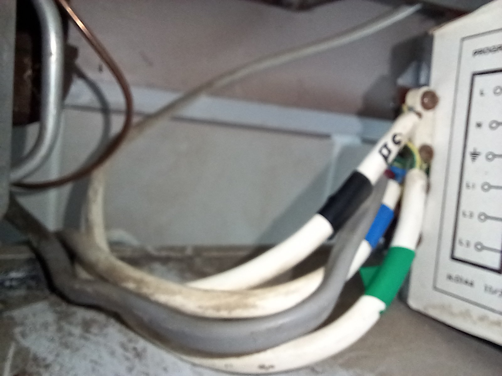

Yes, I have 4 wires.
1 is the power from a 3 pin mains socket.
2 is power to the pump on the wall adjacent to the boiler.
3 is a lead that goes to what I thought was the igniter, but now not so sure. Will take a pic tomorrow.
4 I believe is the thermostat. I am assuming that as it comes from the existing trunking on the wall behind the boiler.
The thermostat lead is gray, all others are white, and is quite hard, compared to the other leads.
I have since marked the white leads with tape, so will try and take better pic and detail which is which.
Also a pic from within the programmer.
Asking Gemini, it seemed to think, that the thermostat would be powered from the boiler, and it's return line would actually switch on the HW&CH when the thermostat made the connection.
I am trying to take more pictures, for my benefit, but the thermostat lead is restricting the movement of the programmer to a fair degree.
Ok, I think, now looking at this picture, I am in a pretty good place?
All I need to do is wire the new programmer exactly like this picture.

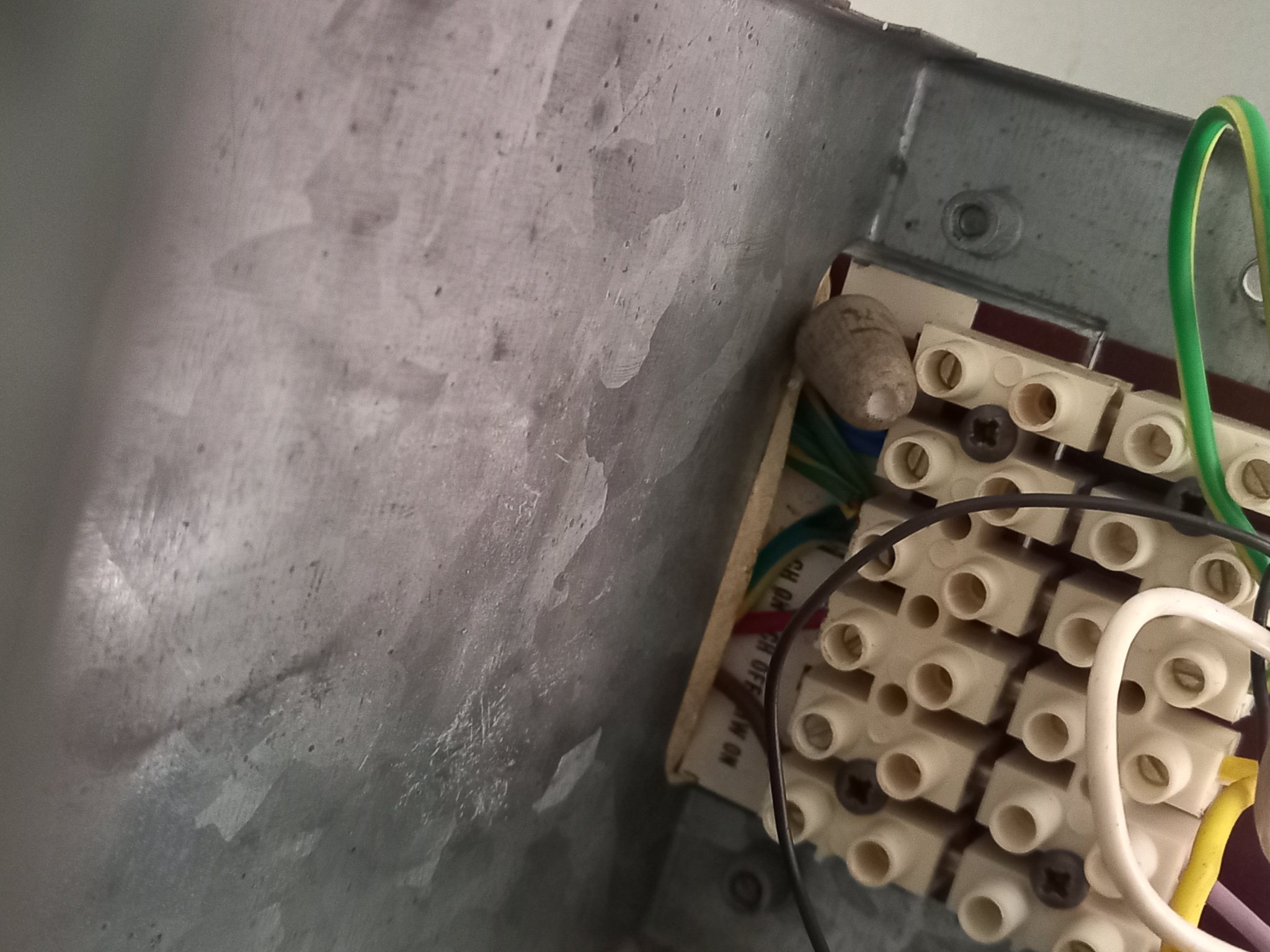

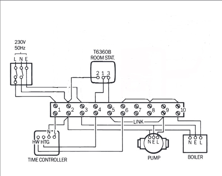

OK slowly working it out, I will assume for moment C Plan basic,
In the main still had a wiring centre, but it would seem not in your case, so looking at that plan, one would expect 4 cables, the time controller has to power the boiler when both central heating and domestic hot water is required. There were little switches on the old timers to allow it to be configured this way, and a mechanical latch so you could not select just central heating.
This returns me to earlier posts, where I talked about would you ever want DHW on its own? In winter, it may as well heat DHW when doing the central heating, but to use it for DHW in summer, is likely not an economic prospect, and using an immersion heater would be better.
I am an electrician not a plumber, so there may still be some old timers around which I don't know of, but I have not seen one in years, so it would be easier to do away with the DHW only, and you can do away with the timer all together and use a programmable thermostat instead.
But need conformation there is no motorised valve, or tank thermostat, need to be sure it is a basic C plan before we try and work out how to replace the timer with a wiring centre and the thermostat with a programmable one.
I think I have already stated that gas is still cheaper for me for HW only. I am happy to keep it as it has always been, HW only or HW&CH.
I do not have any motorised valves, nor a tank thermostat? The temp of the water is controlled by a white knob with values 1 to 6 (or so I believe).
I believe that is if I wire exactly as I have now. That brown wire in L3 to 3, and red wire in L1 to 4, and the earths and neutrals as they are now, then we should be good to go?
As the new backplate is a lot smaller that the original, I plan to wire the common wires into Wago connectors and take a single wire from them to the terminal contact on the backplate?
However I am not an electrician, hence checking here, but does this sound feasible to you?
Black is the mains wire
Blue goes to what I thought was the igniter, but now think it is the gas valve, where that white knob is.
Green goes to the pump
Grey wire I am assuming is the thermostat, as it comes from trunking on the wall behind the boiler.

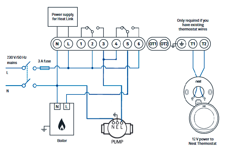

The original Hive thermostat, can be configured to work as you want, it was a software configuration it has two relays inside, and configured for gravity think they call it, one relay controls pump, and one controls boiler.
One can also use Nest Gen 3
Because you have access to com terminal, you can take the feed out of the com, as shown to the boiler, but many programmers and thermostats or programmable thermostats on the market today will not work with C Plan. Some of the Nest thermostats have been made into bricks because google removed support, so I would not recommend Nest. But think some of the Tado units are the same, but can't be sure.
I am using Nest Gen 3 with C Plan, it is to me a useless thermostat as it will not connect to TRV heads, but keep it connected in parallel with Wiser, so if my immersion fails, I can use oil for DHW.
Careful with Nest, the USA versions are very different to the UK ones.

Looking at the picture of the connector blocks, they lettering also shows which is which.
So I am pretty happy, I know what goes where now.
