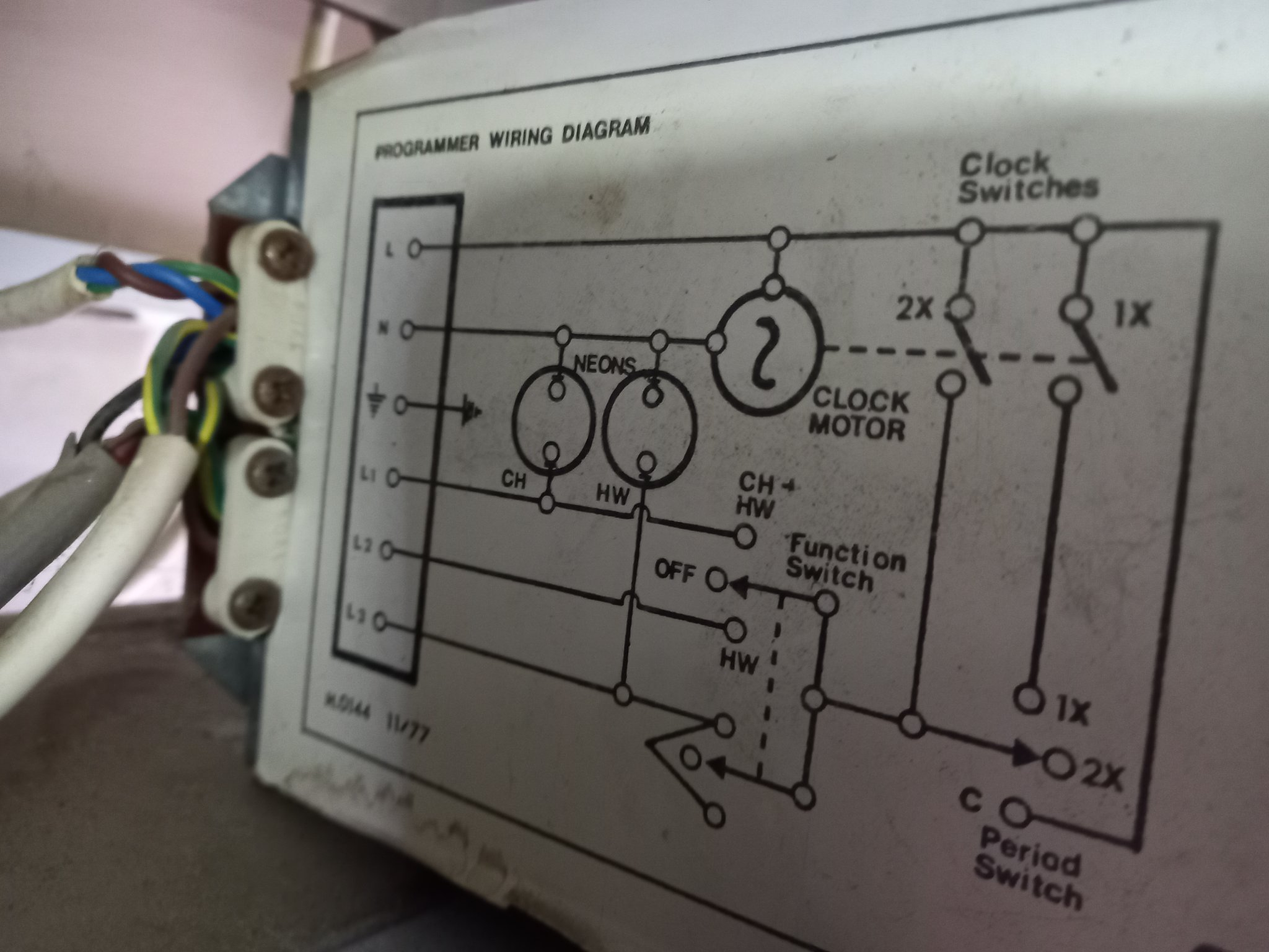

Going on the assumption that I am on the C plan, would you be able to give me the wiring instructions please?
I believe L2 would also need to go to 3?, but electrics has never been my strong point.
With that diagram not surprised, step one is work out what you have.

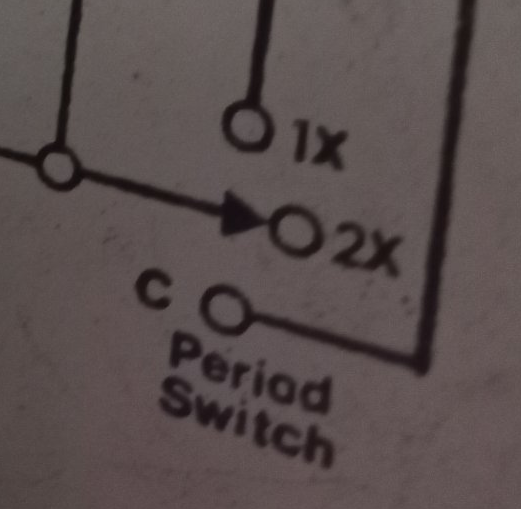

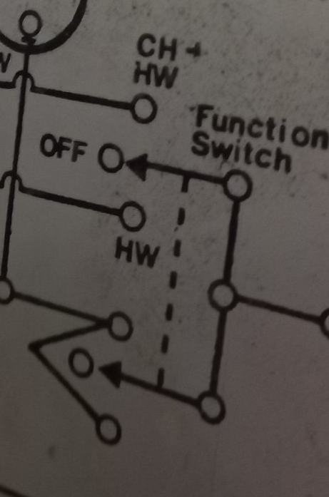

L, N, and Earth OK. I can't find an instruction set for the Unit, so trying to work out what the 'Function Switch' and 'Period Switch'
So this switch 1782829738417.png is the once, twice, or constant, and this one 1782829831604.png the water only, off, water and heating.
So L3 must be the boiler as both options work the boiler, and L1 would be the pump, as only powered with CH mode. As to L2 can't see what it is used for.

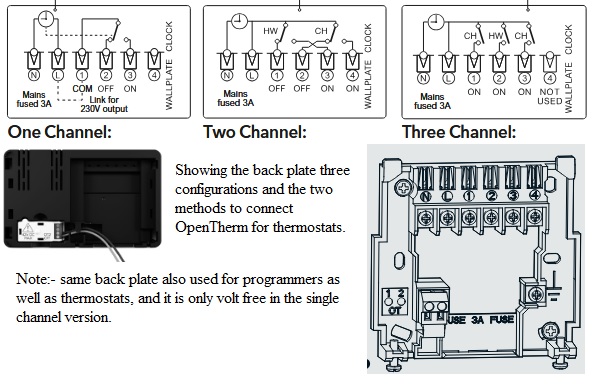

None of the above will work unless there are internal switches. I know Hive has a software fix, but Wiser which uses the same backplate does not.
I know Nest will work as I am using Nest Gen 3, but as to simple time clocks, old ones has a switch when used with C Plan.
This is why I talked about if you really need domestic hot water on its own. If not, then that makes life easy.
I think L2 - L3 is HW only? L1 - L3 is CH & HW.
I do need DHW on it's own for summer.

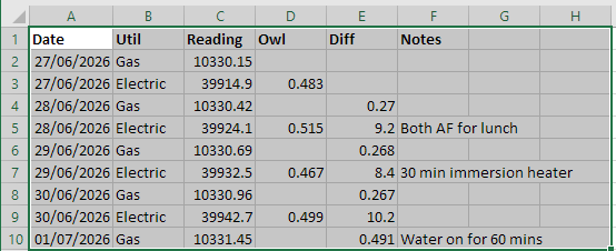

I have those figures you asked for.
On the 29th I put the immersion on for 30 mins. Sufficient for a bath. Electric units were 8.4
Today I put the boiler on for 1 hour. Again sufficient for a bath. Gas units were not even 1 unit, but under half a unit. Not adjusted for KWh
So from that, it would appear my boiler is cheapest?, as my gas is £0.0559 per KWh, but going up to £0.07066 tomorrow. .
Electric per KWh is £0.23715 and £.25076 tomorrow.:unsure:

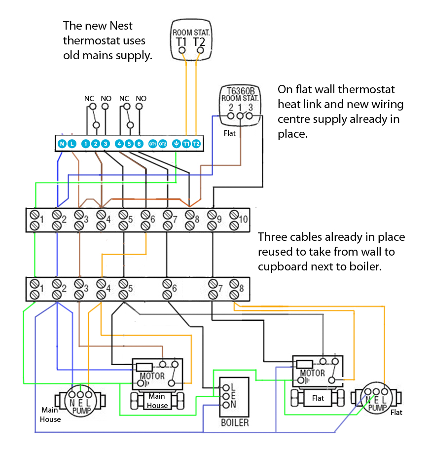

That will take a lot of reading. When I came to do my own central heating, I realised there were errors, so it was down to make a plan of what I had.
The timer already shown, had a 230 volt supply, and a triple and earth cable red, yellow, blue, which went down into the flat where the boiler was, but at the boiler end, it was brown, black, grey, so ringing out the cores, only two were intact.
I had already had a problem with battery powered thermostats, and a cold weekend due to flat batteries, so if possible wanted a hard-wired control. So only way to control DHW and CH and power a device with two wires I could think of, was to use Nest Gen 3 to control the central heating.
This required a complete re-wire, so four locations, the boiler, the thermostat (flat) and hub (main house) and a cupboard with the pumps in.
So I did a plan of where the wires went, this plan has errors, but gives you an idea of how I worked out how to wire.

So lets start with what is connected to that L2, until we know if C, Y, S, or W plan, it is all guess work.

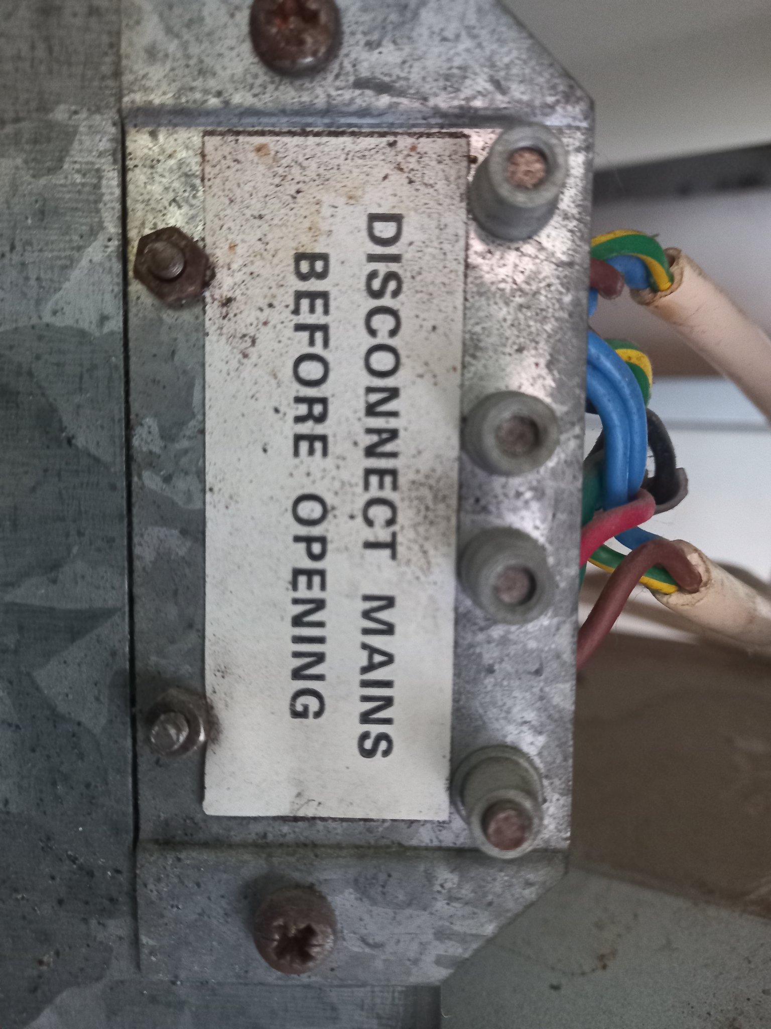

Here is the end of the programmer where all the wires are fixed into it.
From the little I know, L2 and L3 when connected give me HW only?
ChatGPT does have a good point, re testing with a muli meter for HW only and then HW&CH and see what each terminal puts out in those positions.
I went looking to see how that sideplate comes off. Not sure about those on the right?
Google AI has advised me that the programmer is actually a Myson integrated boiler programmer and has given me as below for wiring instructions.
The Correct Wiring Conversion Map
To bypass the old internal linking mechanism safely, follow this precise terminal mapping:
Old Myson TerminalFunctionNew Siemens RWB29si Terminal
LPermanent Live InputTerminal L
NMains NeutralTerminal N
E (Earth symbol)Ground / EarthEarth Terminal Earth Block
L1Hot Water SystemTerminal 3 (HW ON)
L3Central Heating SystemTerminal 4 (CH ON)
L2CRITICAL: LEAVE EMPTYDO NOT WIRE (Insulate safely)
Two Golden Rules for This Specific Conversion:
  1. Isolate and Cap the L2 Wire: The wire that currently goes to L2 must be entirely disconnected. Wrap the bare copper tip securely in a standalone electrical connector block (like a Wago connector or a strip connector) and tape it off. It will not be connected to the Siemens backplate. Leaving it loose will cause a dangerous short circuit against the casing.
  2. No Loop Wires: Ensure there are no physical jumper wires added between L and any other terminal on your new Siemens plate. The Siemens unit distributes switching voltages internally. [1]

There is a problem when combining a programmer with thermostat, when using C Plan, Hive has a workaround, Wiser does not, and if the com terminal is not internally connected, as with Nest you can also use them.
But with just a programmer, the setting for C plan simply stops you selecting CH only, as on the original C Plan you can't stop the DHW heating once the boiler is running. But if you get the settings wrong, all it means is you can select CH only, but you still get CH and DHW.
