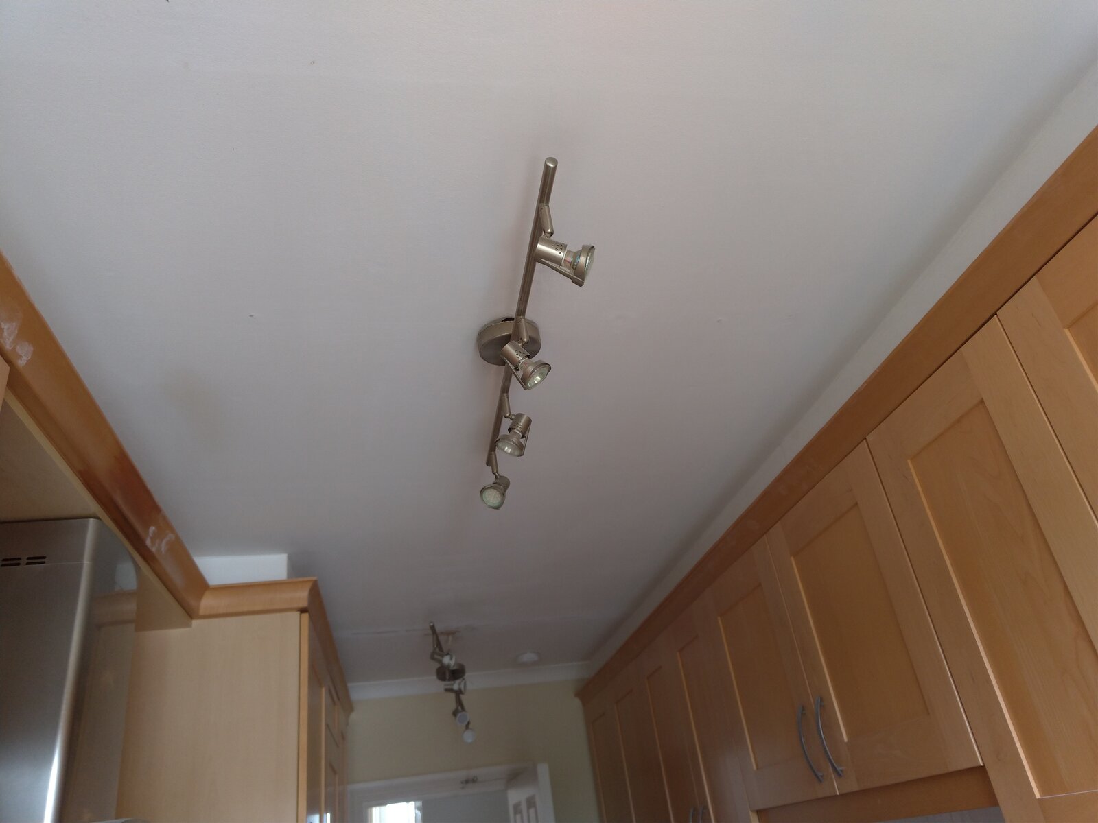

Looking into possibility of replacing 2 ceiling bars with 4 lights in the kitchen with downlighters for a smarter look.
Before getting a sparky involved how much work/cost involved? I guess need to know where the joists are in order to cut the holes?

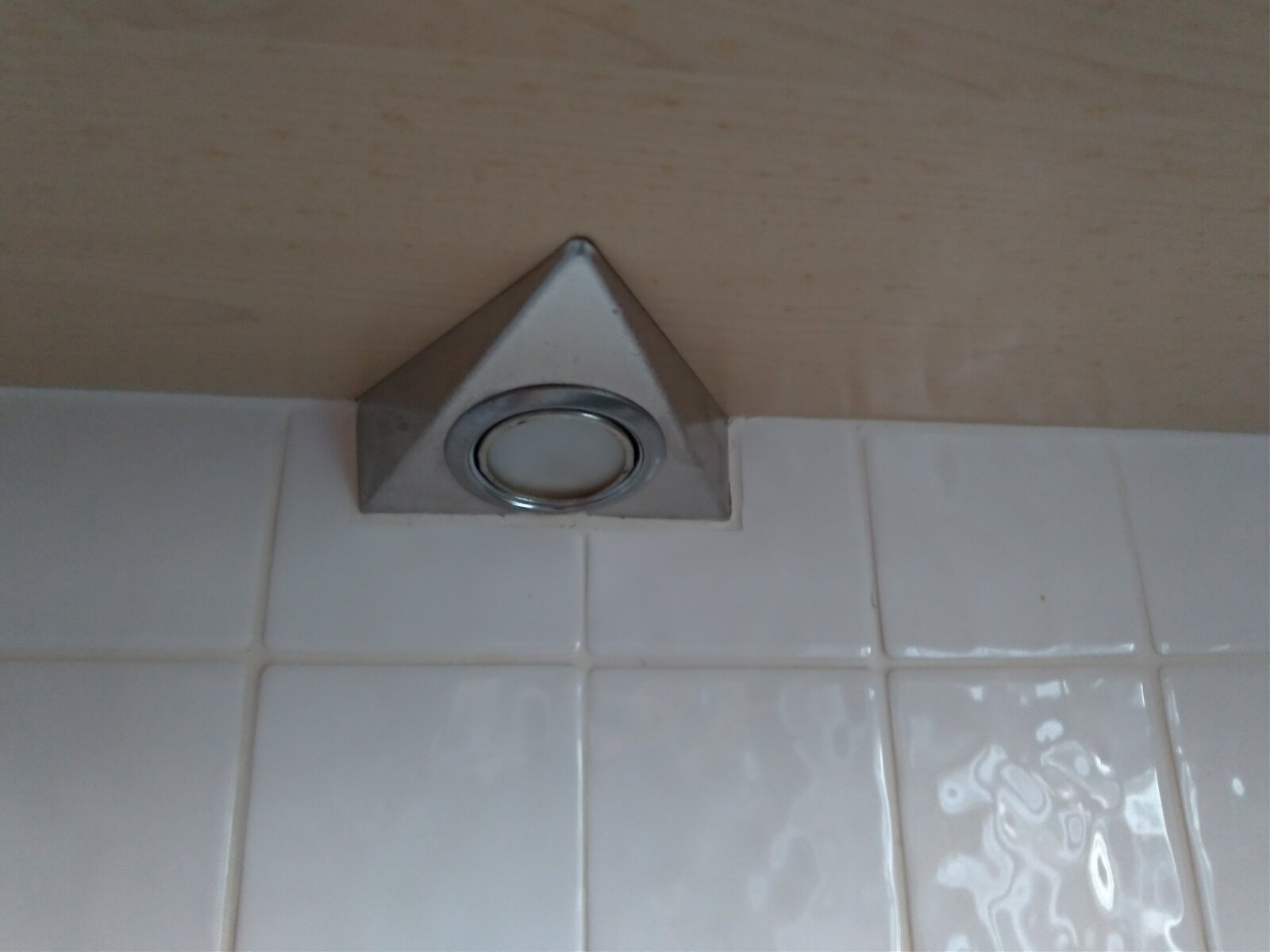

Have you looked at LED strips? You could run them above the cupboards. I've recently replaced downlighters with LED strips, and I can now see things in the kitchen without a headtorch. It's also a lot less work and disruption to install than sticking torches in holes in the ceiling.

yes I've got triangular lights under the cupboards but LED strips would be better. Unfortunately someone decided to the lights then tile around them afterwards so difficult to now upgrade.

Yes, with no access from above there will be damage to the ceiling to enable cabling. Replacing with LED bar lights a better option.
Is the ceiling plasterboard, having 2 lights could be a bonus, as 4 strategically placed downlight holes may be enough to reroute the existing wires and use the old wires to draw in new ones, joins within the ceiling are best avoided if possible.
Another thought is 2 nice pendant lights and wire out to the 4 spotlights from them, though will all be on same switch and subject to the doors or your head hitting them
You could always (not the best choice for look or fixing cables) but if the joist runs friendy pull a cable through to the wall edge then run a surface trunk along the wall / ceiling above the units and then feed cable behind ceiling to chosen downlight positions it isnt to bad a look and then patch up the areas where cables come through now. Spacing is looking a little tight as looks like its very narrow one end.

I'm suggesting you run long LED strips on the ceiling, above the cupboards.
Thanks for all responses. I think as this is ambient lighting, will probably go for flush ceiling or bar lights using existing fittings. Being a narrow kitchen and low ceiling pendant not so good.
A couple of flush ceiling lights will be the best option here, it will provide a MUCH better quality of light compared to than awful spot light bars and is something that could be done easily without having to start ripping the ceiling apart
