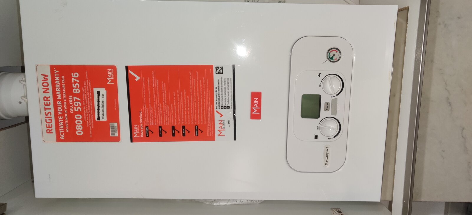

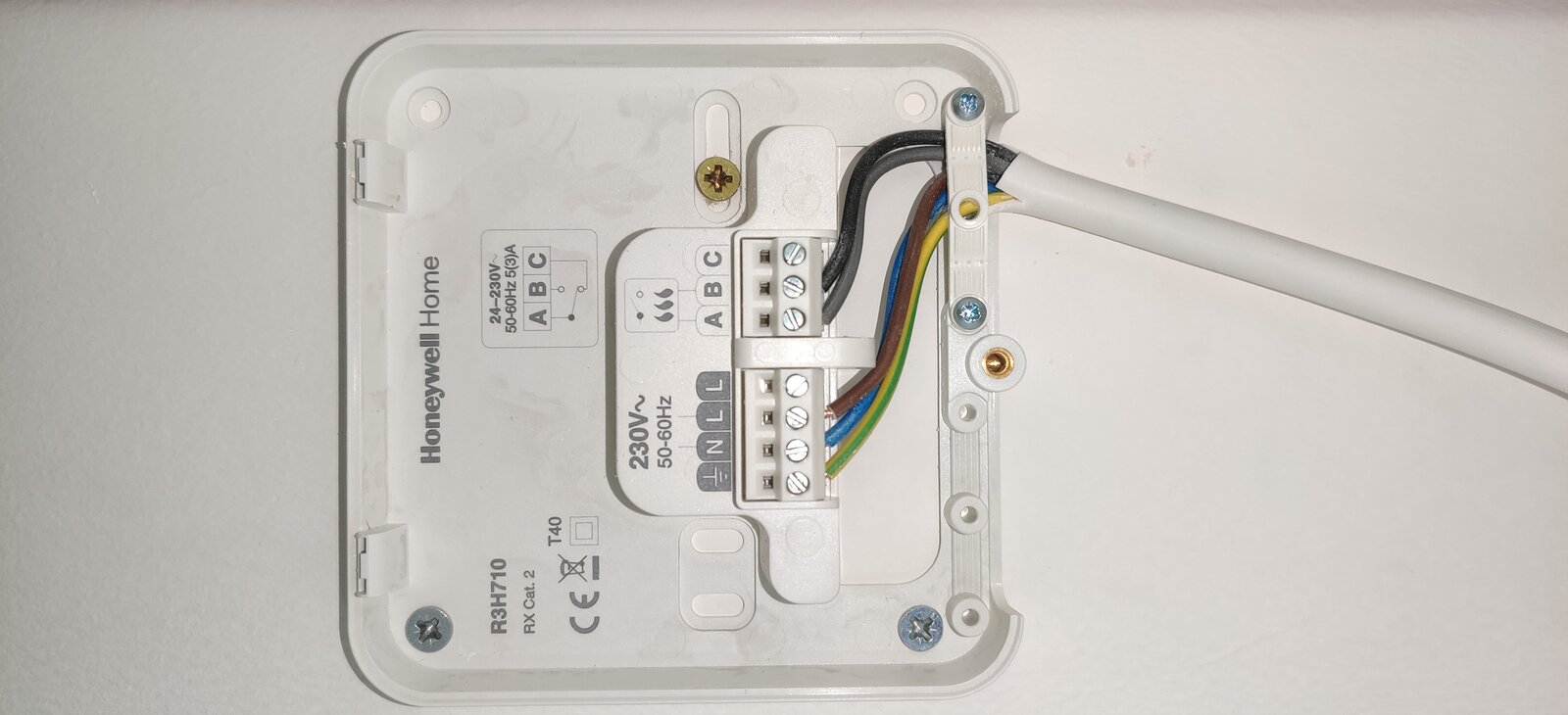

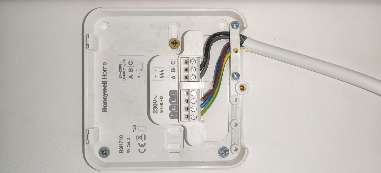

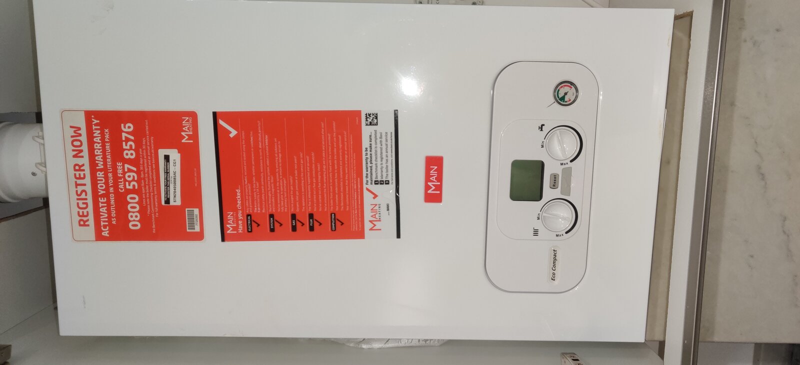

The boiler system heats the water on the go (no hot water tank) and so it looks like there is just mains connections to existing Honeywell home system, and two control wires.

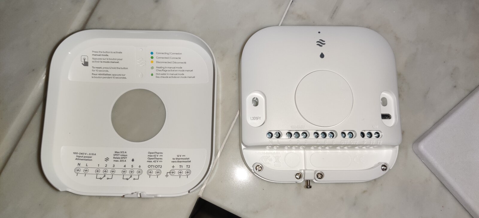

Took photos of the new nest thermostat too just in case it differs.
Thanks so much!

Yep, install heat link in place of Honeywell receiver, and just transfer the wires as follows:
L - L
N - N
Earth can go to the earth terminal (it’s needed should you wish to power thermostat via heat link)
Grey - 2
Black - 3
If you’re wanting to power the thermostat via the heat link, then you need to run a 2 core cable from the heat link to where you want the thermostat.
Nest say three core, they say to run an earth, not sure why as no earth required at thermostat, if powered from heat link then it does not use wireless but sends the info on same pair of wires as power it.

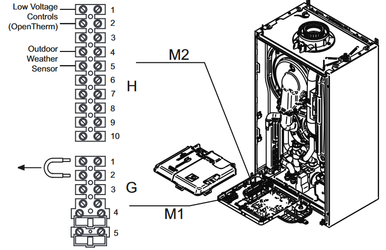

However if I have your boiler correct then this
Is the electrical connections, which shows Open Therm so since Nest is also Open Therm I would say that would be the way to wire it.
Ok, so what @CBW said is the easiest as it means I don't have to open the boiler, but what @ericmark said has greater benefits being that it's a smarter control protocol (opentherm).
