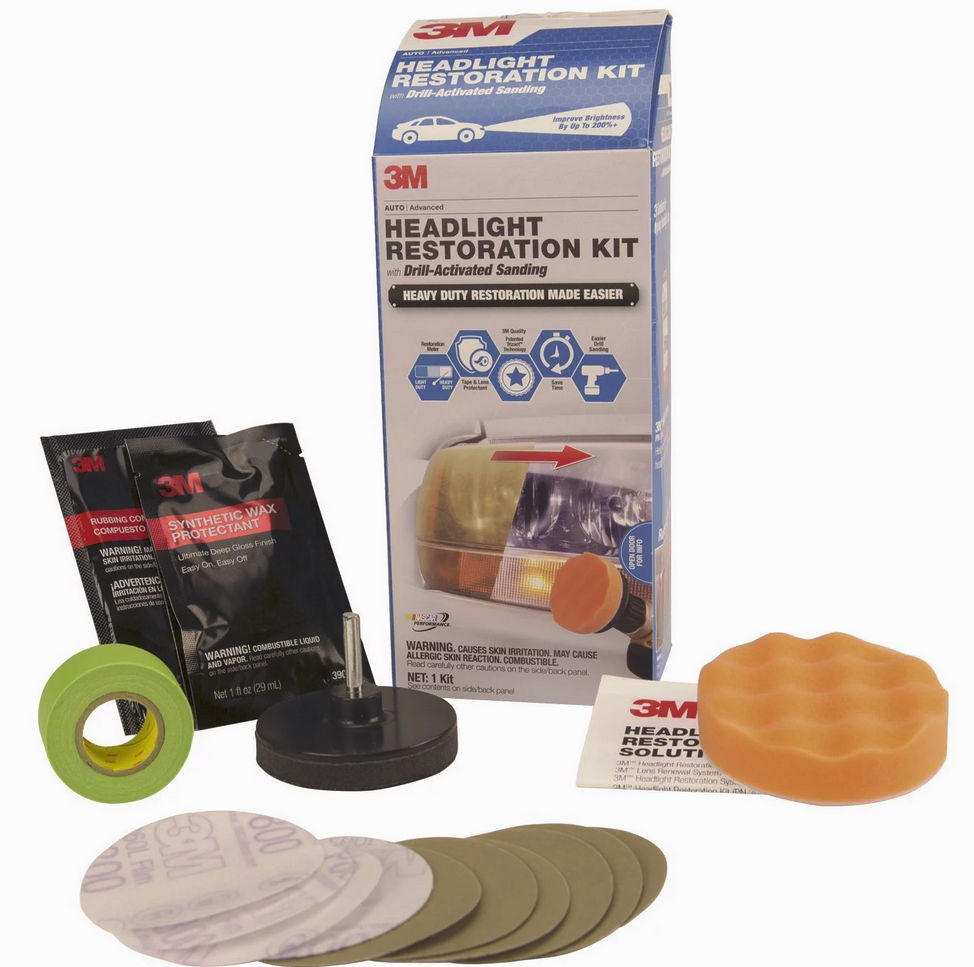

The lamp are a bit discoloured. Is there any product to clean those too?

The "fogging" on those gets quite bad on the outside of the polycarbonate lens. You can get a kit for £12 or something which has abrasives and a thing you can put in a cordless, to take rthe surface off and polish them up. I have an old Honda - just because it's not worth seling now. I "did" the light a couple of years ago and one of them has gone foggy again, and boy you can see the difference, when you come up behind a white transit etc.
There are thousands of micro-cracks in the lens, so you just get a blob of light. The kit is worth having, it would take forever without a machine.
