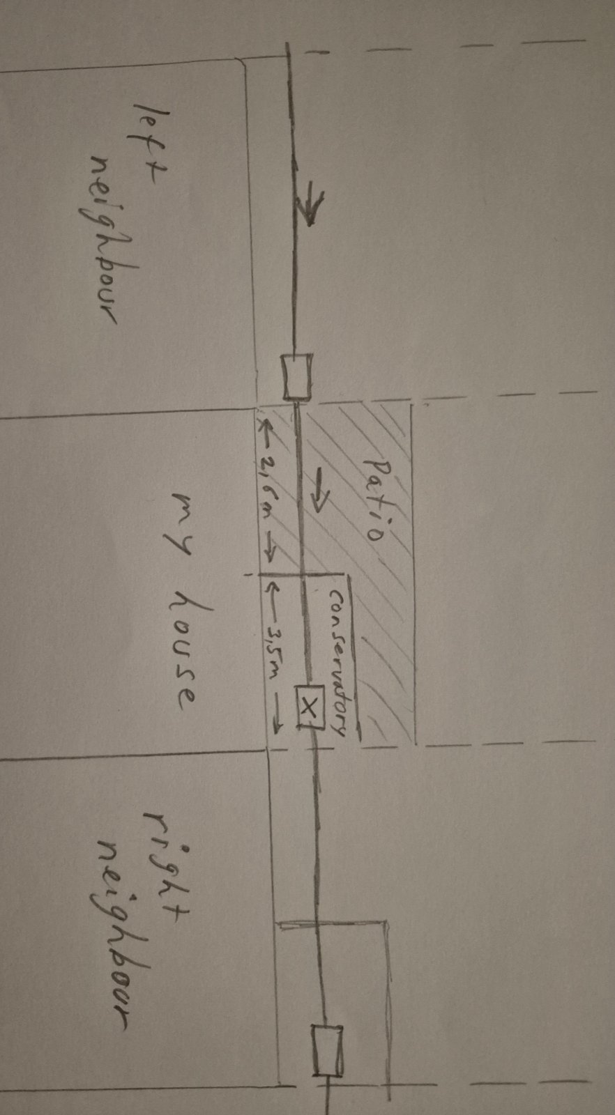

Hello, I have a old, small, lean to conservatory (3.5mx2.25m). With one side beeing 10cm away from my neighbours fence. It is made of a pre cast concrete knee wall and 2mm glass and timberframe windows. The roof is polycarbonate. It was definitely build before 2011. The house us from 1967. I live in a mid terraced house, 2 houses left and 2 houses right. I realised that my conservatory is build over a manhole. One neighbour has a manhole in their patio and the other in their little extension.
My solicitor search at the time of house purchase said there are no shared sewer on the premises but as my neighbours waste goes through my pipes, I think it is. There is an indemnity insurance in place thfough the sewer survey. I would like to replace the conservatory on the existing concrete foundation. And add a double sealed manhole cover to maintain access which currently not have. The manhole is not visible at all. Moving it outside the conservatory is not possible due to a porcelain tiled patio. But I was reading I should request a build over agreement from my water company. But many people advised me against it. What if i request a build over agreement and don't get it? What is the best way forward? I am worried this will cause issues when I want to sell the house in the future.

I appreciate the comments. It is Anglian Water here. The only option I see would be a double sealed manhole in the conservatory. But some people told me that won't be allowed. Did anyone get a build over agreement with installing a double sealed manhole in the conservatory? The sewage pipe is clay pipe 100mm and he chamber is only about 80cm deep. The other option is i don't touch it and leave the conservatory as it is. I attached a drawing for visualisation.

Now you've given us a picture it's a safe bet it will be a resounding no if you apply.
There is ample room to move the chamber: you just don't want to,

Hello Stevie88, thank you for your comment. There are two aspects. I just got a new patio installed as I wasn't aware of any of that. And secondly, if i move the manhole to the left, it is less than 2m away from my neighbours manhole and that doesn't really make sense neither. Or am I missing something? If thats the only option, I am no opposed but it would be very expensive as I probably destroy the patio in the process.

You don’t move the manhole , you remove and run the soil pipe right thru then add your own access for your new extension .New patio or not will probably have to go .
Thank you, just to be clear. I don't want to build an extension. I would like to replace the conservatory with a new one on the existing foundations.
If I understand correctly, the best option would be to remove the existing manhole with a sewer pipe and then create a new access point in form of a new manhole in front of my conservatory. That would mean that my new manhole would be only appr 1.8m away from the manhole of my neighbour on the left. Would that cause any issues?
The manhole should be positioned where your house connections enter enter it, not randomly somewhere on the pipe run.

You might not need a manhole at all as there are already two close by, one either side of your property. That's for the powers that be to decide though.
Thank you everyone for your comments. It looks like there are various options how this can go and the best will be to either leave the conservatory as it is or to get a build over agreement which will require either a new manhole outside the conservatory or just a close down of the internal manhole and a replacement with a consecutive pipe.
